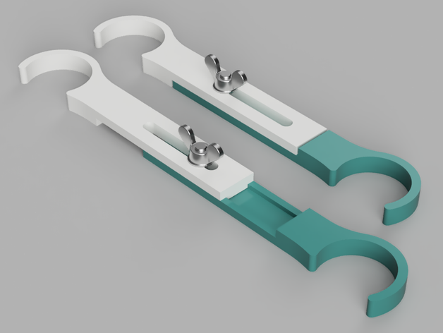

I 3d printed spacers to align the X & Y axis(es?) and use it every 3 or 4 runs just to check that things are square.
Especially useful if you tend to drag the X or Y axis back to ‘0’ without power. This can cause it to skew slightly.
