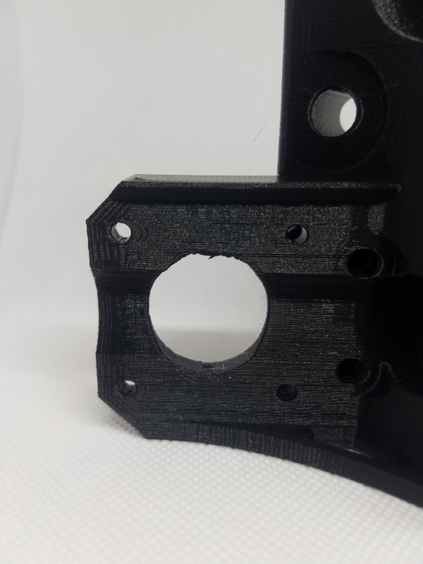

Almost done with the prints, only the core left to go.
Everything looks great with the minor exception of the trucks. I did not have the severe issue w/ the material sagging / warping like some others, but bridging the top of the hole for the motor mount was a bit too much. Nothing some hand sanding or light dremel can’t fix, but wanted to be aware.
Angling the parts so the fan hits them better or even a few degrees cooler on the extruder can really help that. Although, not a critical part and you will not see it once you add the steppers. That is why I did not make it the tear drop shape (retaining more strength but sacrifice looks).
Thanks for the tip. I printed w/ the long edge along the Y-axis, so exactly perpendicular to the fan shroud oriented along the x axis and, from what you’re saying, the worst case scenario for this shape.
Will keep in mind as I go to print the core. Aprreciate all the hard work you put into this design and can’t wait to finish the build.
For the core I faced the back (logo side) towards the fan. Not sure why but I know I did actually think about it before I did it.
I had the same problem on my truck prints. As Ryan said, it does not impact assembly or function. My trucks roll just fine.
