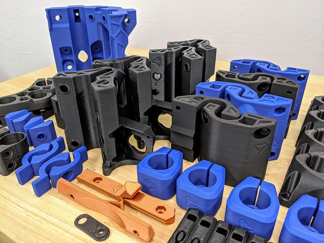

Printed parts are live.
Nice. Looks like the picture is missing a pair of Core clamps though. I only see 2 out of the 4 of them.
The gantry clamps are stacked. The 4 Z core clamps are blue.

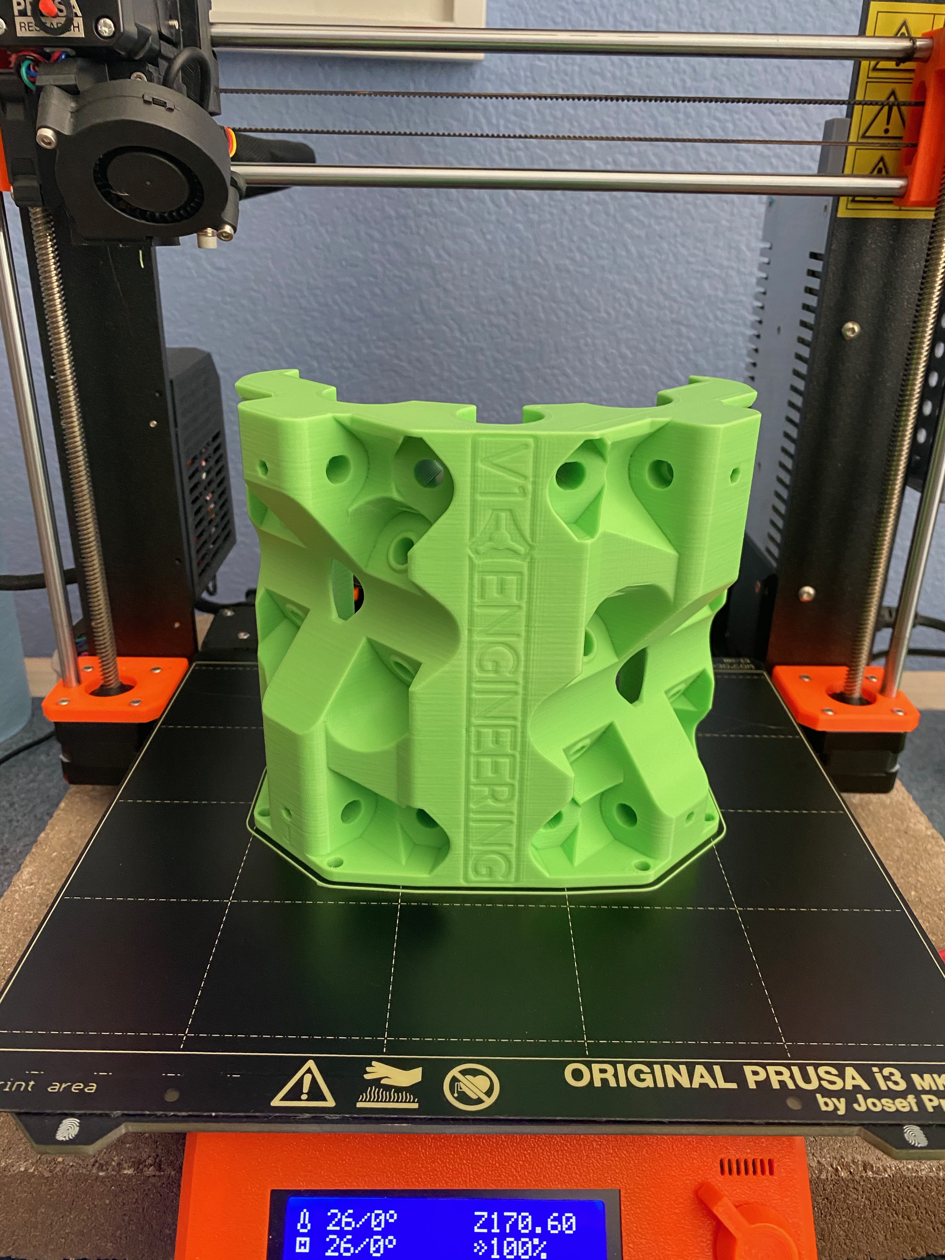

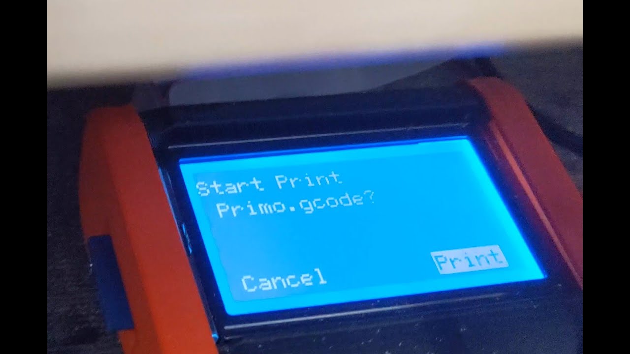

First attempt successful core. All parts printed on ender 3 with no fails.
Took 44hours but it’s done
That looks just like mine!
Gotcha. Couldn’t tell in that dark filament. :slight_smile:
