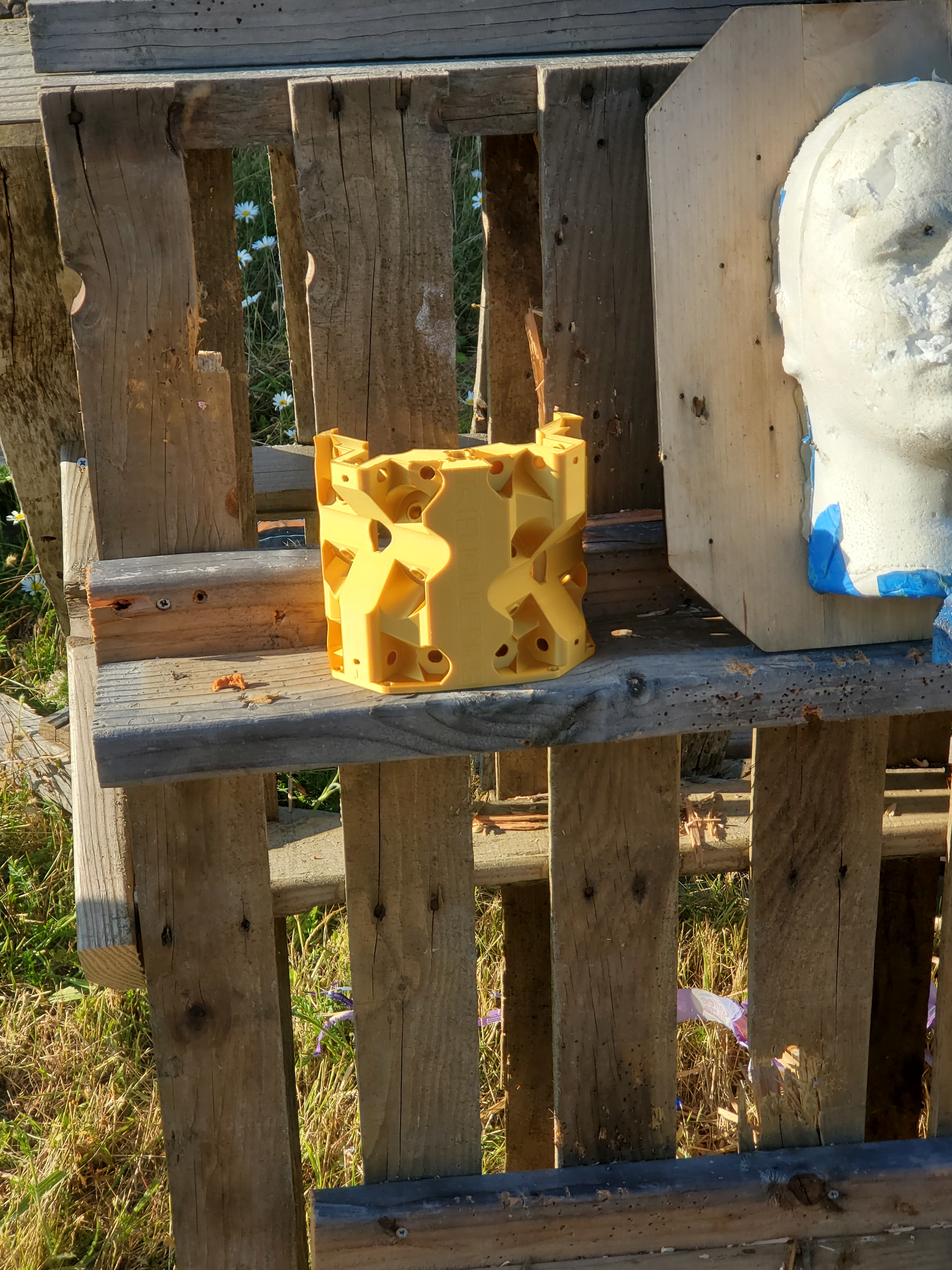

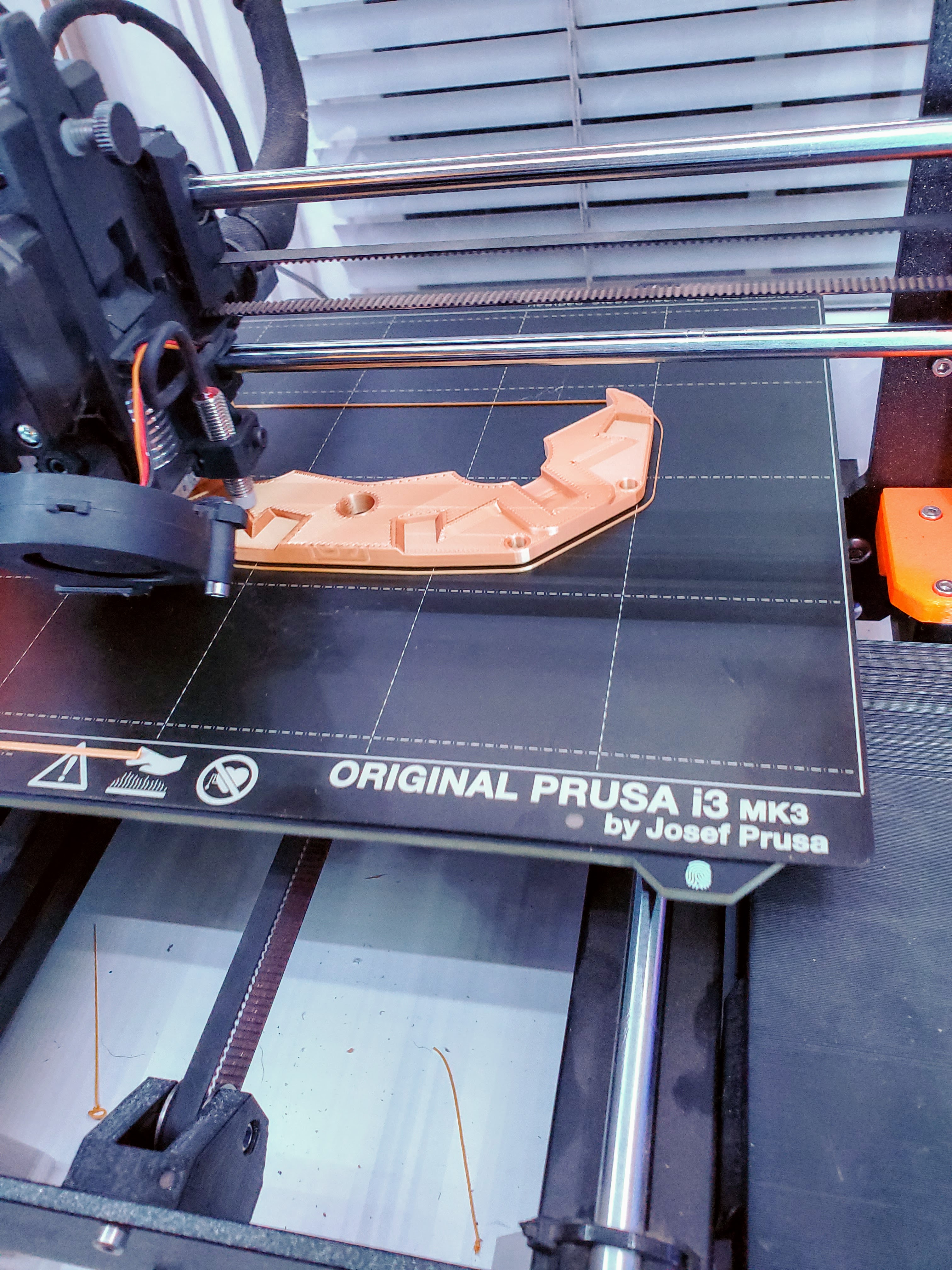

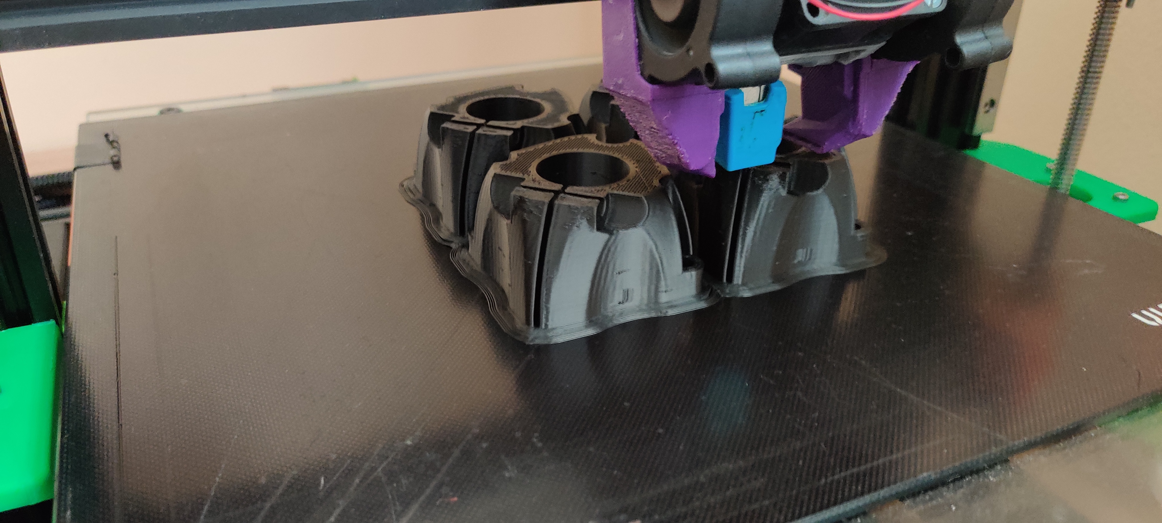

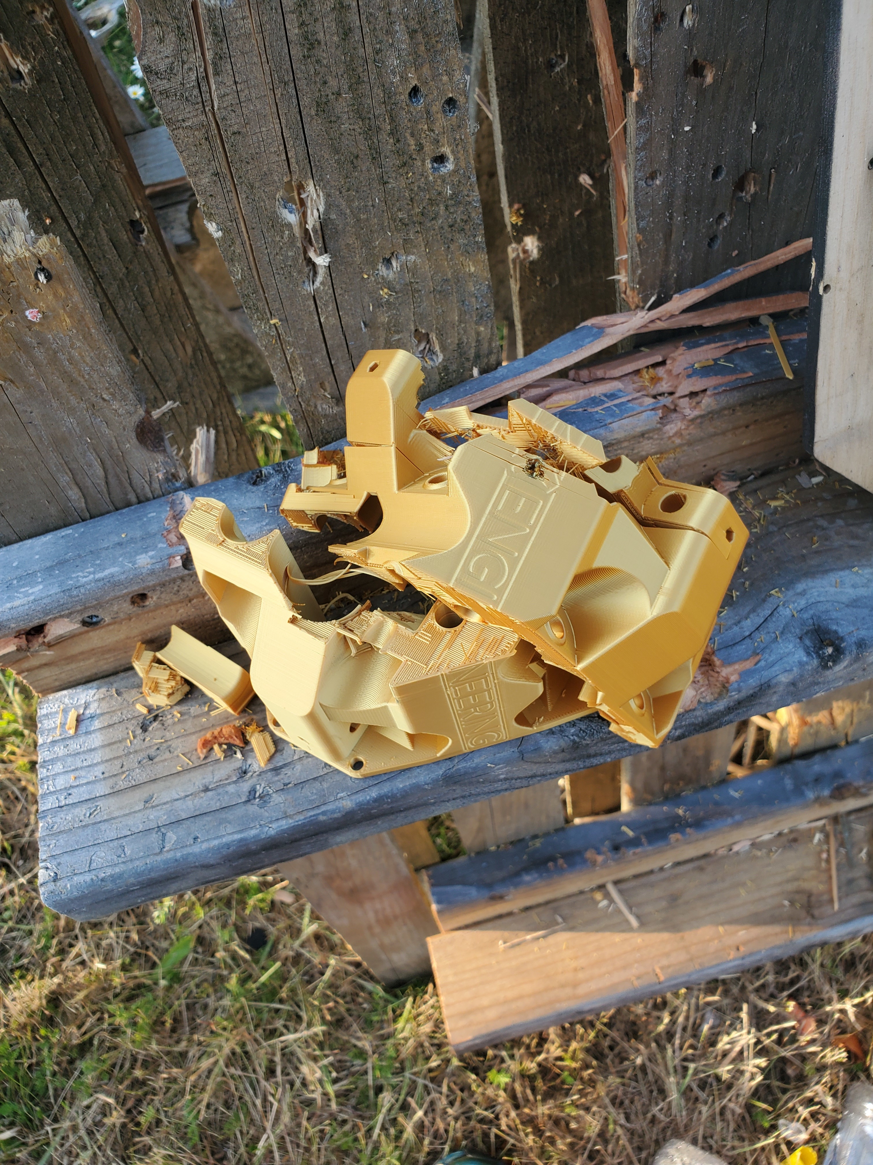

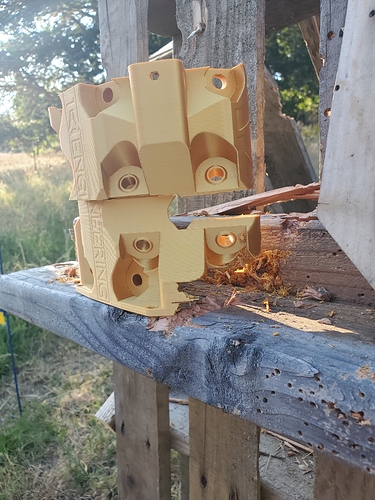

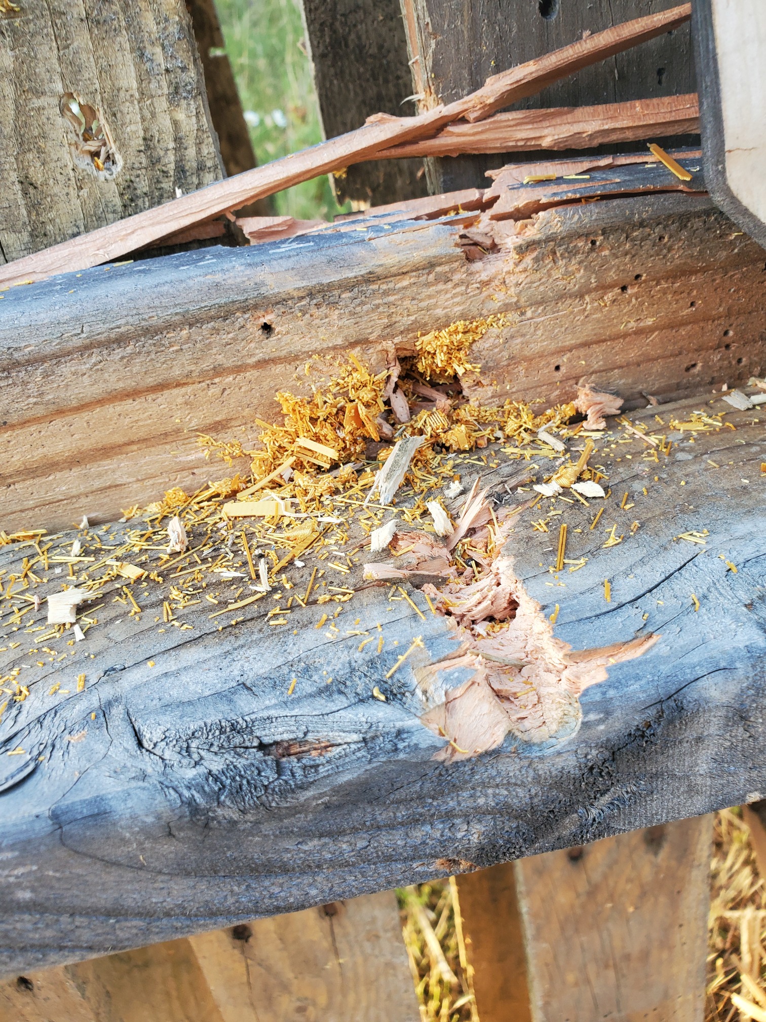

The journey and experience so far has been (aside from a couple failed cores 1 caused by me the other an unknown layer shift.) awesome! I tried to give it some Gusto and experimented with color change for the first time. I am pleased with the results.

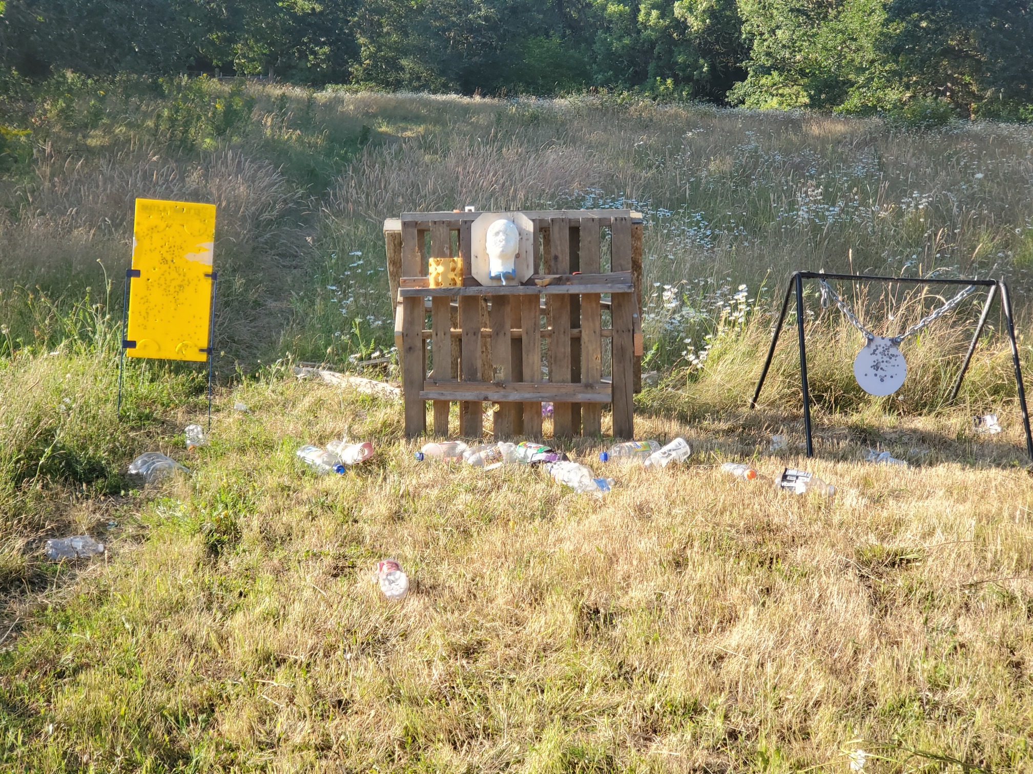

I mentioned at one point that i was going to introduce my failed core to some lead… I wasn’t shooting what i was planning but introductions were certainly made.

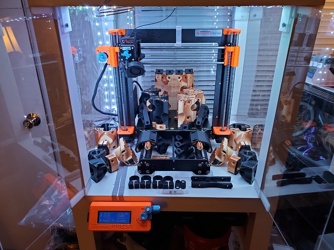

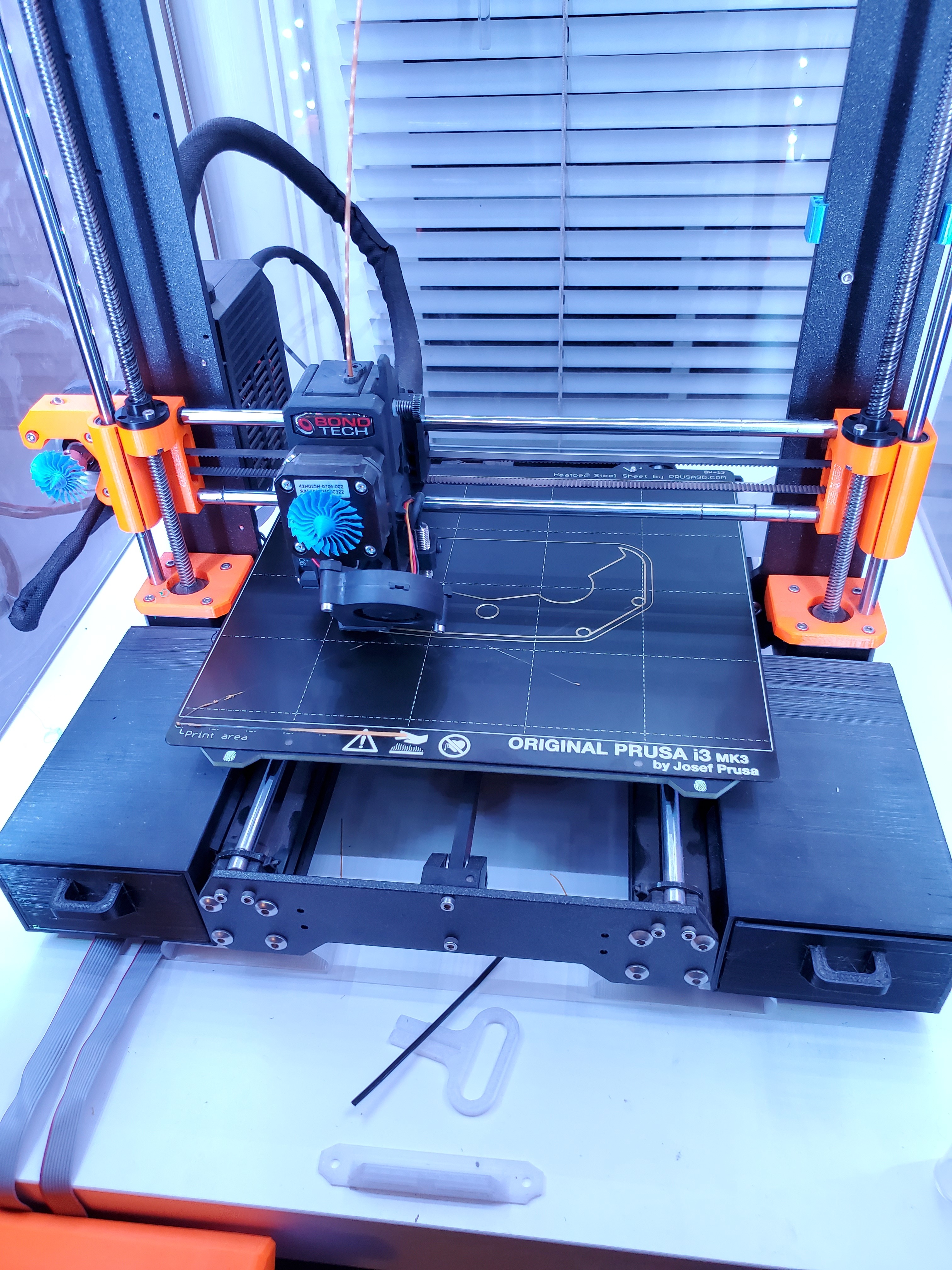

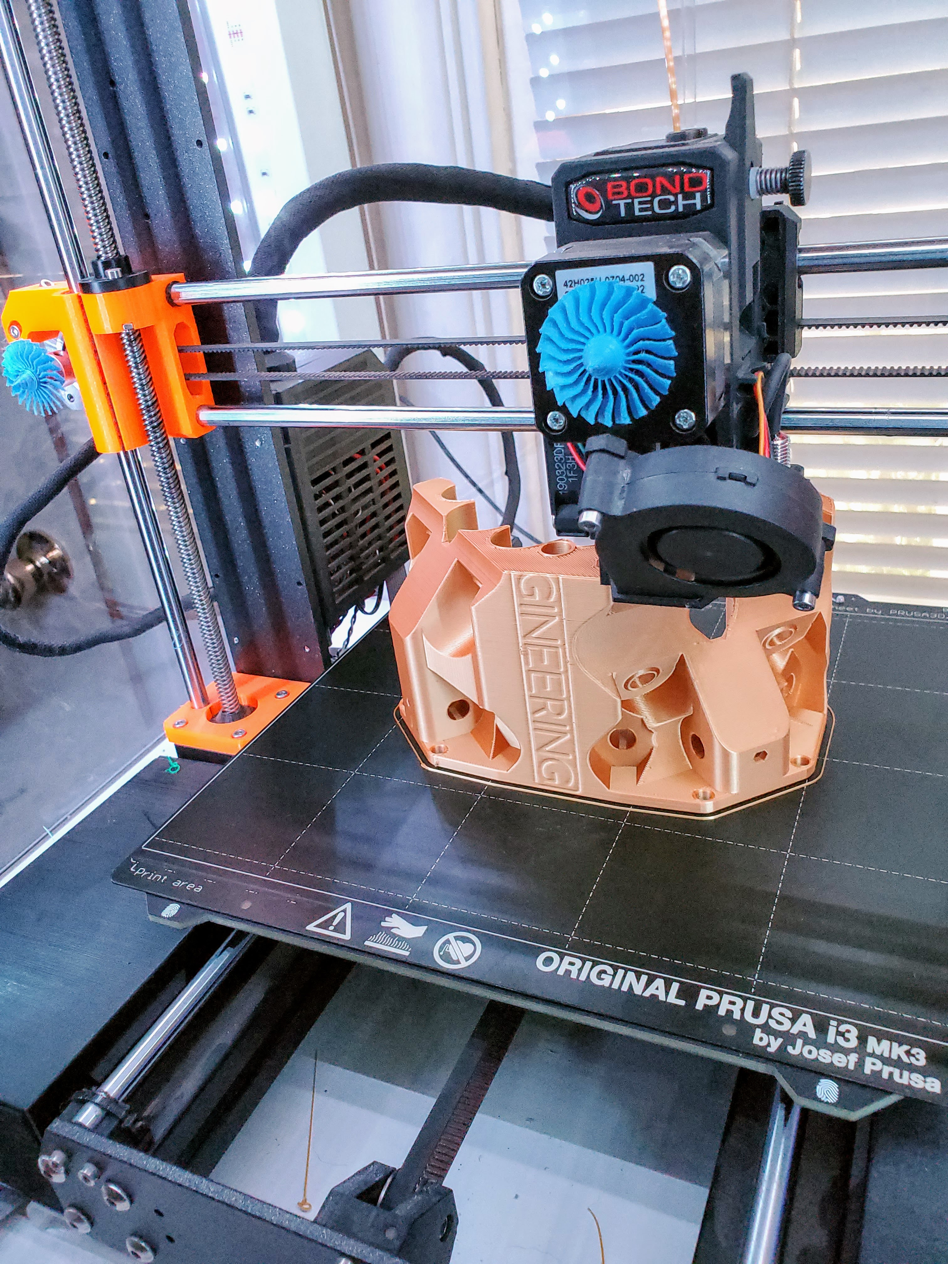

First prints…11h in, feeling happy
