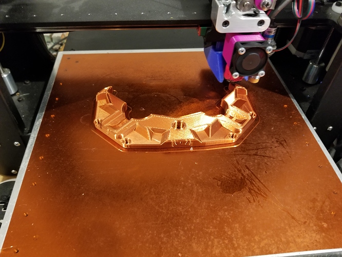

Started on the hardest first. Core at 70% rectilinear, 4 perimeters, 4 layers top/bot. Quoted right around 24hrs.
