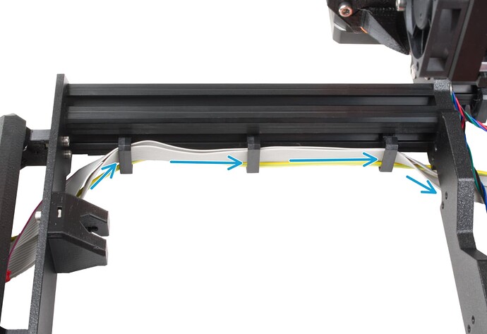

Oh dear. I truly hate ribbon cable. Maybe less surprising that the LCD might have EMI issues, then.
A round ferrite works, you’ve just gotta bundle the cable together. They also make flat ferrites for ribbon cables, too.
Bah, that’s a pity it’s on a micro-match header. They’re entirely intended for fine-pitch ribbon cable and I don’t think there’s an individual pin type.
You said before that other people have had luck routing the cable differently? If you try to get the LCD and ribbon cable as far away from the rest of the electronics in the box, that might help… If it does, that all but guarantees that it’s an EMI/EMC issue.
It’s not long enough to be rerouted, but I’ll try to get a ferrite. Do I bundle it anywhere and attach it, or close to one end? I’ll also give an update when Prusa gets back to me. Thanks for your help.
That’s a pity, although if it’s a short run then it’s less likely to be a cabling pickup related issue, I would guess.
In this case, I’d put it close to the LCD end. If it’s a bare ferrite and not encased in plastic, I’d wrap a bit of tape around it or something to avoid shorting anything on the LCD.
It’s around 30cm, but it runs along a motor cable the whole way and in the buddy board it goes directly over the cables for two of the motors. I’m going to try later, thanks again.
Right. Well even if you can temporarily pull the screen out in a different direction or even just create space between those cables, it might help. The fields around the motor cables drop with the square of distance, so going from 5mm to 20mm will drop things heaps, for example.
It’s now 0mm. :sweat_smile: I might try to print a PLA brace for 2mm copper and put it between the cables where I can. :sweat_smile:
Can always try. It’s more likely to be magnetic field coupling so the cable really needs to be enclosed to solve that. The magnetic field will just go around a specific barrier like that.
You could also potentially try to temporarily re-route the motor cable as well, I guess? Might depend on whether that cable is easily replicated or not, too.

What about this? This seems like a very good way to achieve crosstalk between the cables (two halves of one connector):
What if the individual conductors of the ribbon cable were peeled apart but left intact at the ends? Then you would have a bundle of individual wires and maybe you could crunch them together differently or maybe twist some pairs, or spread them out, if you knew which ones were more likely to be the problem.
Or maybe it’s a matter of folding the cable one way is bad and folding it a different way is not bad, if certain wires in one half of the cable are susceptible to interference from certain wires of the other half cable?
