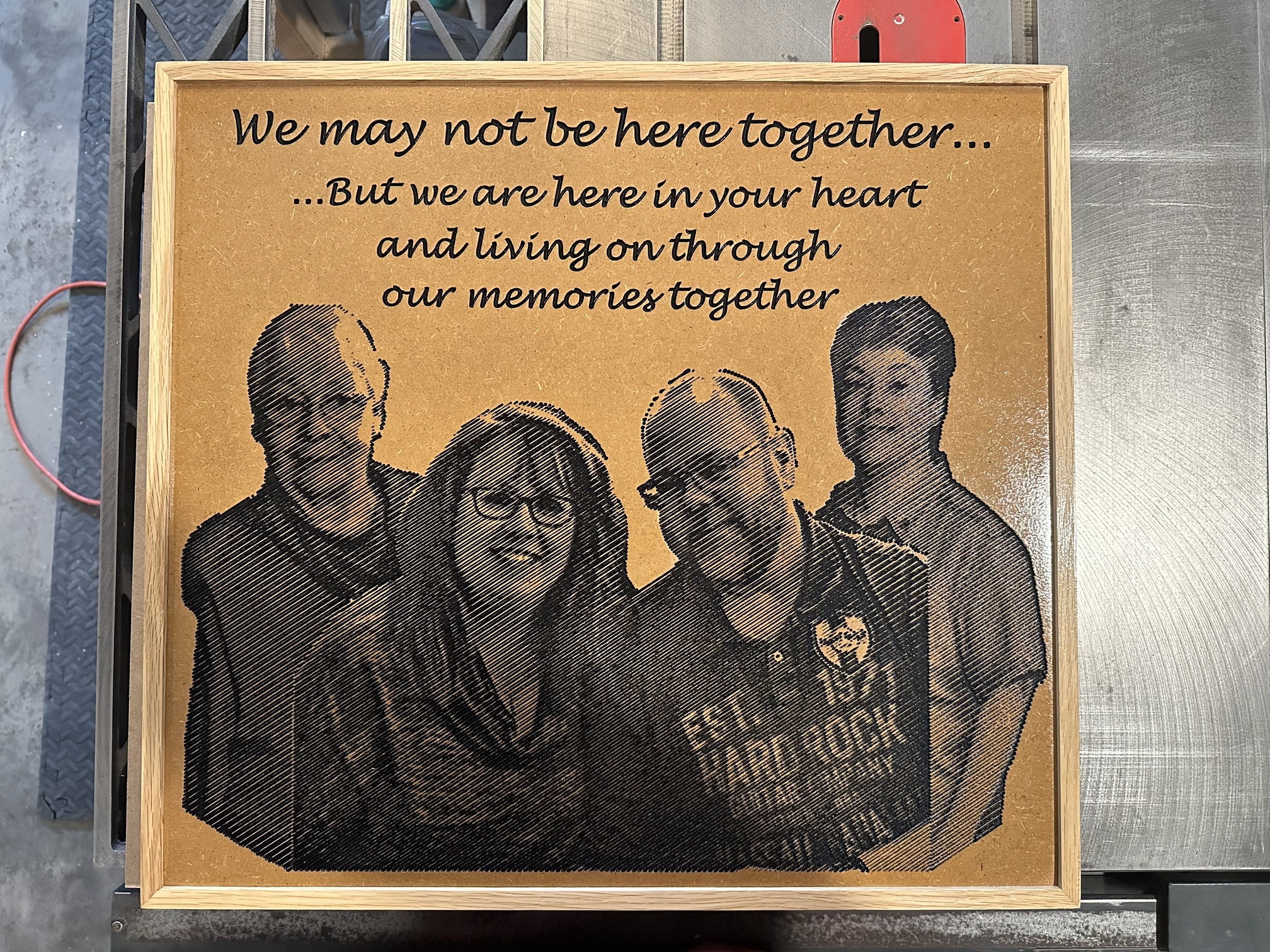

New LR3 excited
Awesome work!
Musing about the v-carve photo… A quick shot of a clear sealant before the v-carve, then the paint won’t seep into the grain. After the paint dries, sand down below the seal coat, and you should be good. If your stock is really porous, another shot of sealant before paint would keep the paint lines crisp. But that’s all armchair woodcraft from the peanut gallery… :wink:
Thank you for the input. I was mainly focusing on getting the tool path correct so this was just a test piece. I heard mdf or basswood is best for this. Someone that’s teaching me has actually incorporated epoxy and it’s looks really crisp, so excited for future endeavors.
