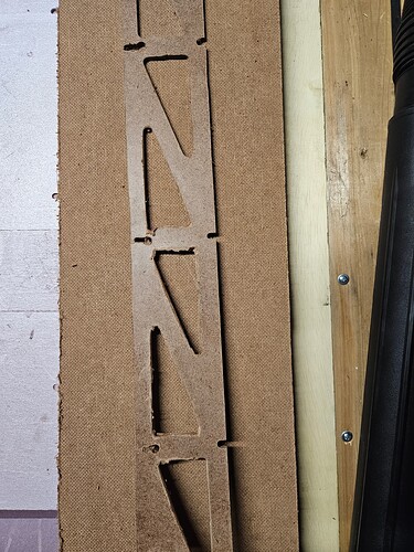

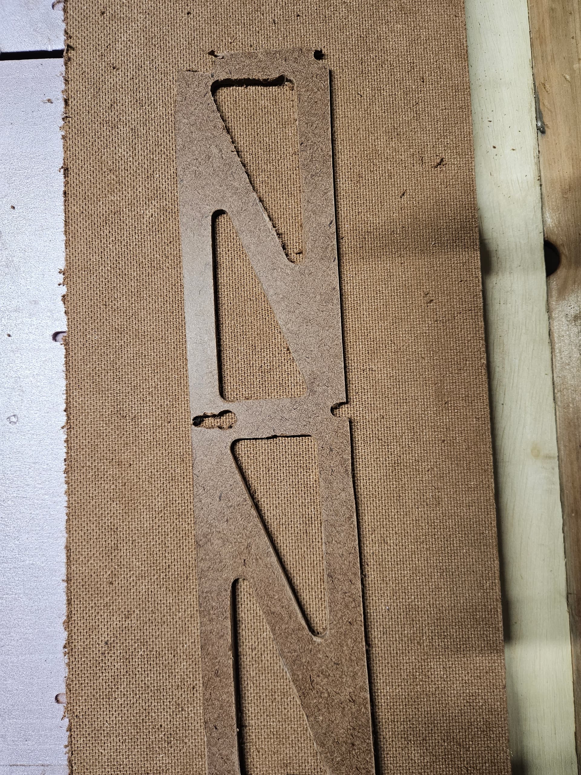

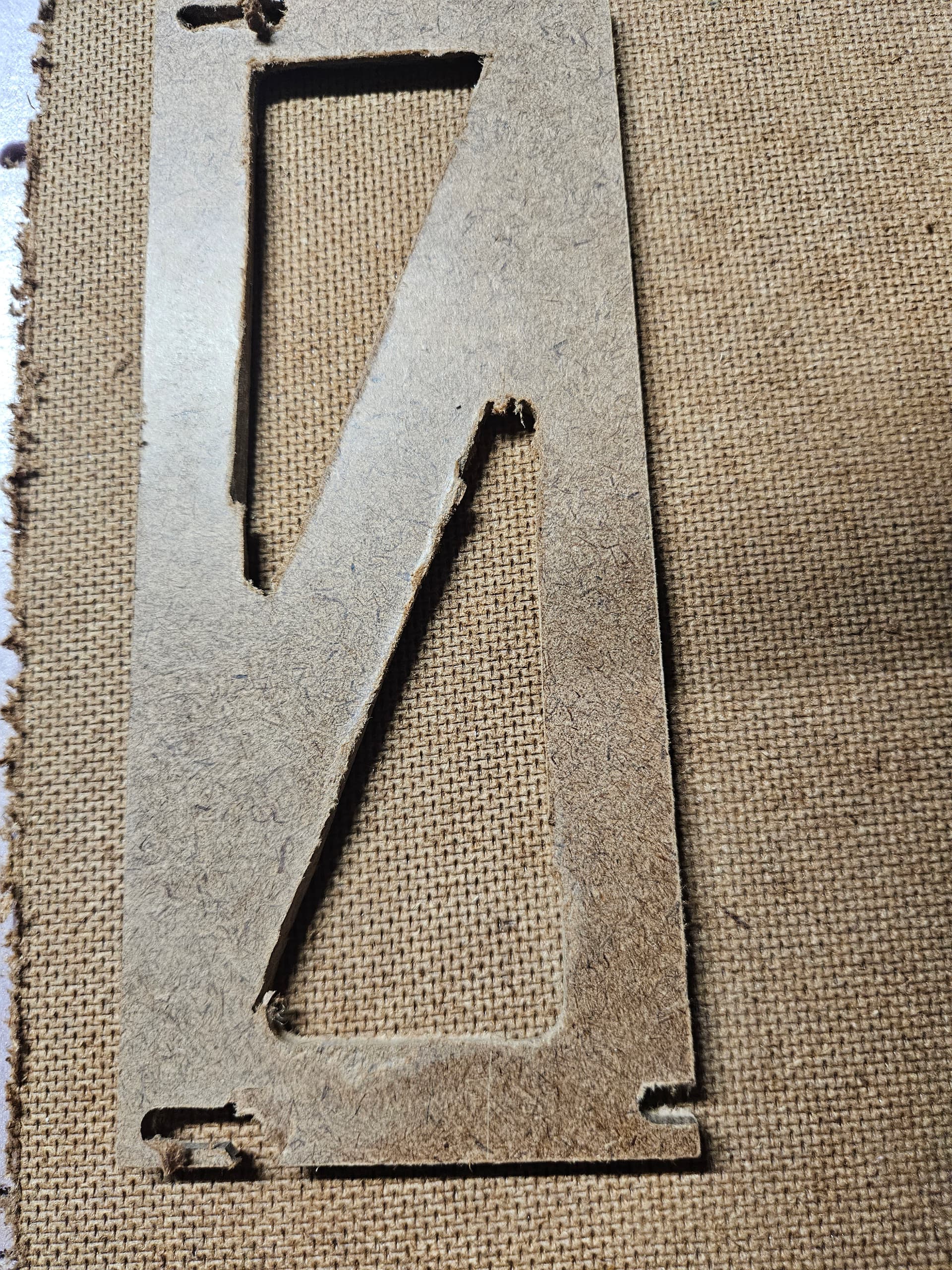

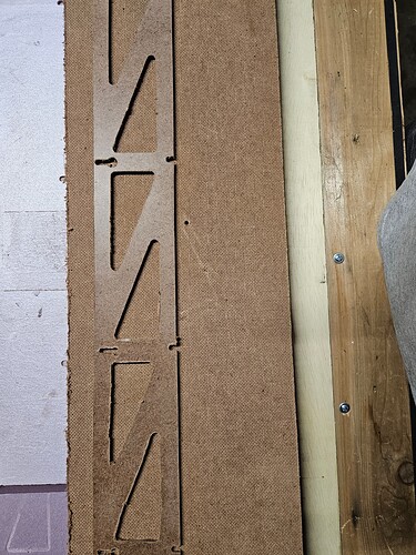

Thanks for all the help guys. Was able to pretty much get one of the struts cut had some tear outs on the ends and as I don’t have my spoilboard setup yet cut didn’t go all the way through, but overall satisfied just some fine tuning and will be good to go. Been a slow process for me but by July once everything settles hoping to have time to be in the shop and grinding out projects. Have some great ideas and can’t wait to share.
So update struts plates are cut. Also went back and painted my rails to avoid rust. New dust hose comes in tomorrow. Haven’t did any successful cuts as of yet. Mainly due to heat in Tx with it being 100+°F and currently no air in my garage so just got a portable ac unit and currently working to install that when i get the parts. Also have been playing around with designs and prepping cuts. For anyone using Carveco i reached out to them to edit the machine file format to include the start gcode if you have a touchplate from @vicious1. Was forgetting to add that when doing some test cuts and thought why not reach out to them. Anyone interested can email me @richard.williams398@yahoo.com and will send you the file as not sure how/if i can attach it here. Hope everyone is doing well.

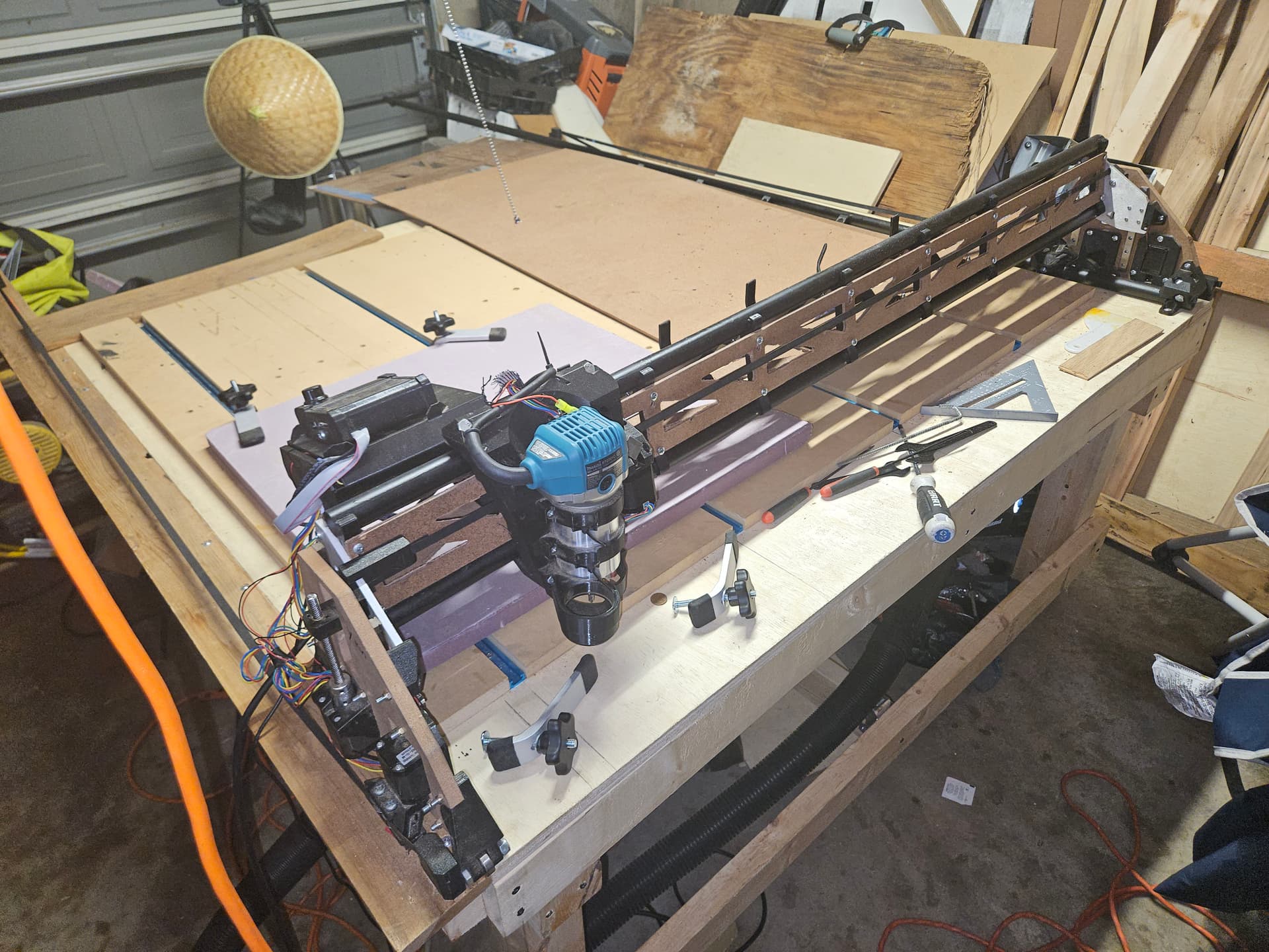

So said screw the heat late yesterday and decided to do some test cuts on foam. After reassembly z axis is cutting too deep. Sure this has happened before can someone direct me to a thread to resolve this? Thanks.
For further context, cut set for Âź in and cutting all the way through the 1 in foam into the spoil board as well. Not sure if I overlooked something being tighten properly but everything seems to be in order.
Two things come to mind: You might either have the wrong leadscrew or your steps are configured wrong.
I’m thinking like @Tokoloshe, I wish I could remember a thread that had this in it, that I could point you at.
I thought I remembered someone recommending to tell the machine to move a set distance, and measure the actual movement, to ensure it’s an actual machine issue, and not a CAM issue. (Hope I’m saying that correctly). Of course that’s me making the assumption this is with gcode other than the crown.
You might have also just forgotten to set your zero point at the start of the job.
Home the Z axis and tell it to move down 10mm and see how far it goes.
Lead screws are correct. So maybe steps configured wrong. Typically using the starting g-code (below) from the milling basics. But will still test this. Also found some nuts to be loose on the struts so tightened those.

So long hot day in the garage. Believe problem to be solved. So steps were one issue, silly me only edited stepover but did not edit step down. Also screws came loose that was holding the brass on the lead screws. Not sure if that’s caused by me familiarizing myself with the z home to many times when adjusting microswitches and they became loose but think I am officially up and running. (Knock on wood)

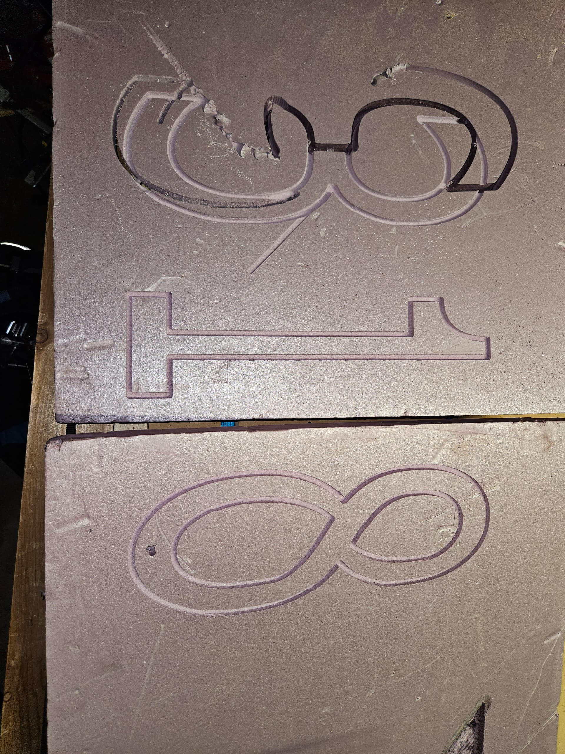

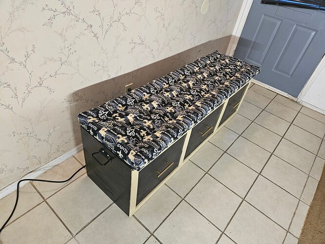

Ignore the multiple failed attempts on the number 3. The 1 and the 8 came out exactly as planned. 1st client slash friend of my mom is wanting 318 to hang in her shop. We’re all from Louisiana so Saints themes stuff also made her a flip top storage bench. I can make boxes and i can tell the machine to be accurate. Think the woodworking journey starting off pretty good :relieved::relieved::relieved:.
Nice.

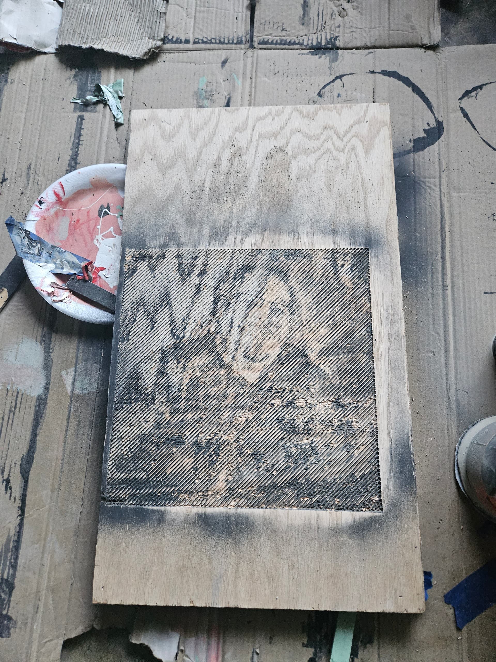

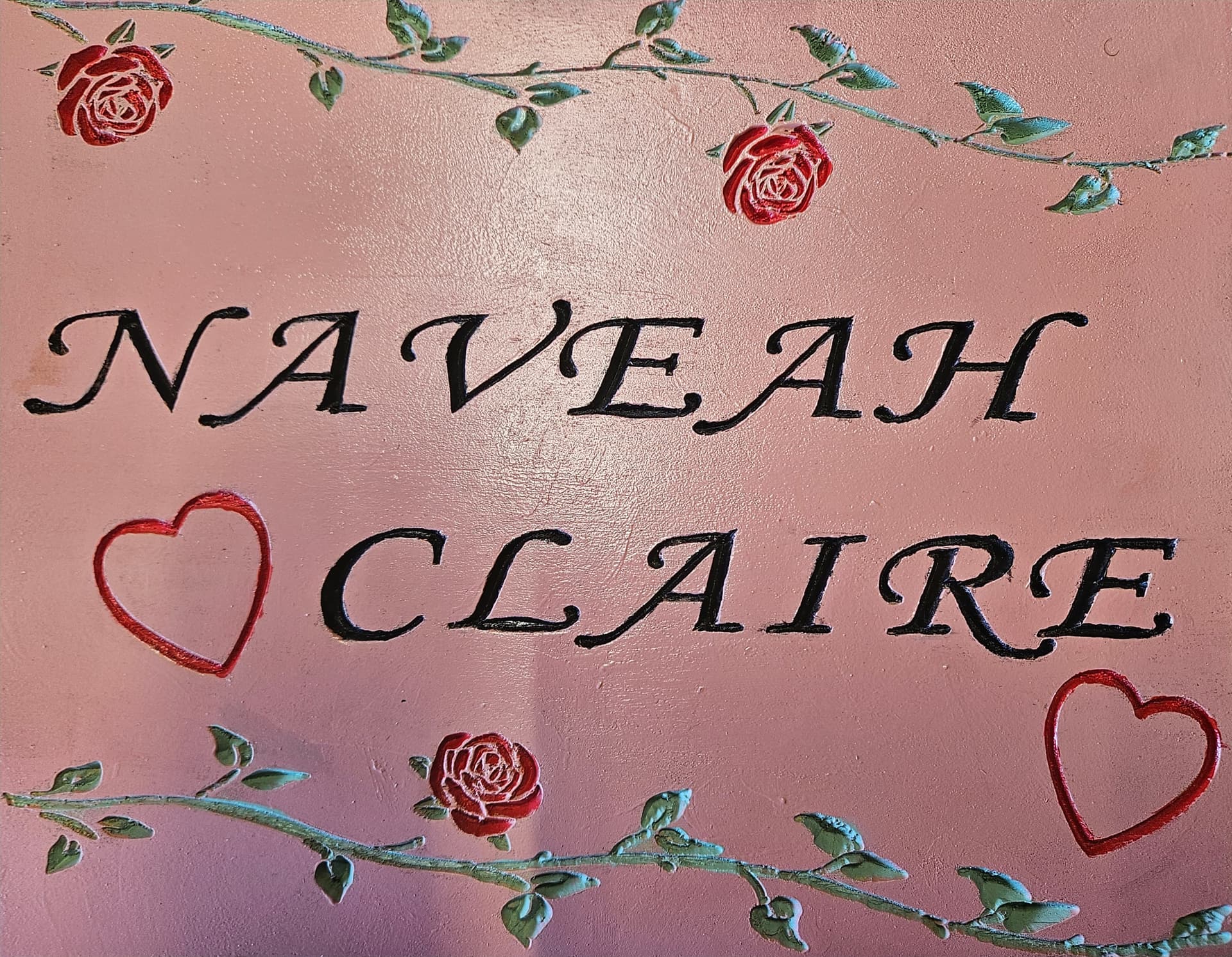

I have done some additional projects since my previous post. Nothing major just a custom sign, jack-o-latern, and photo vcarve(in progress). I have been a bit timid or overwhelmed. Lack of knowledge and fear of messing up equates to that. But I am pushing through it.
That photo vcarve is cool! Never tried to do that before
I like the shadow caster. I just got this tiny flashlight and now I think I need to make one of those. Could be a fun decoration.
