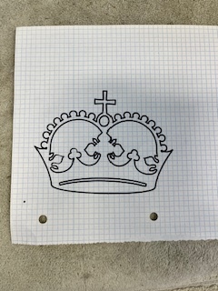

I have my LR3 built for bootstrapping.
The crown came out as expected.

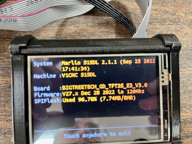

The SKR pro is running 2.1.1 firmware. Is this the current? If not, what firmware do I need?

yup, tried and true. No need to change.

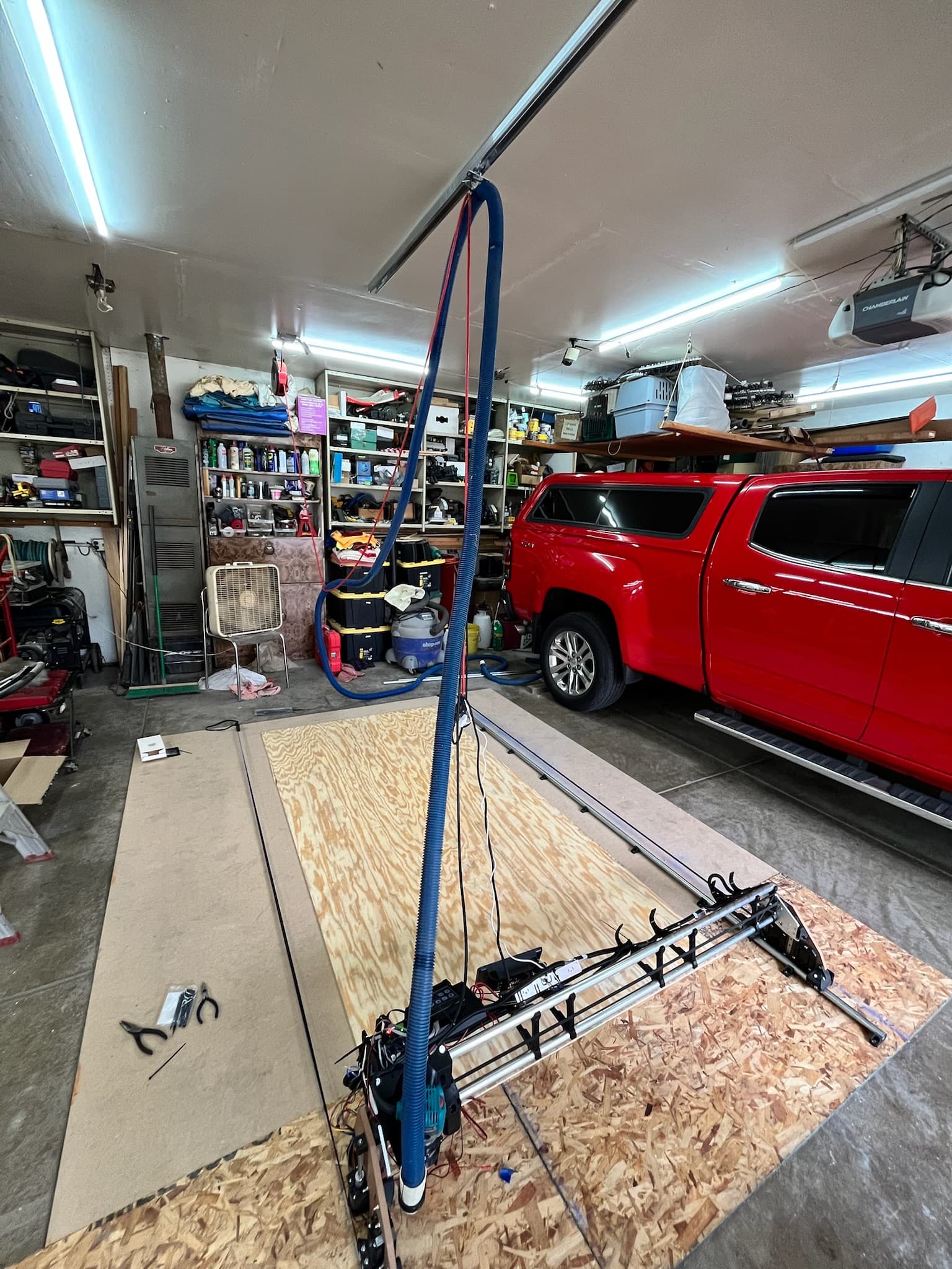

The build looks great I love seeing it on the floor. To help with accuracy make sure that vac hose has lots of slack, and you should really cable tie it to the core so it is not pulling on the front of the core.
Thank you.
I have the vac house cable tided to the power cable on the router mount and testing has shown no stress on the gantry.

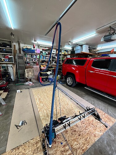

Here is a video while testing the hose and power cables.
Gantry Testing
