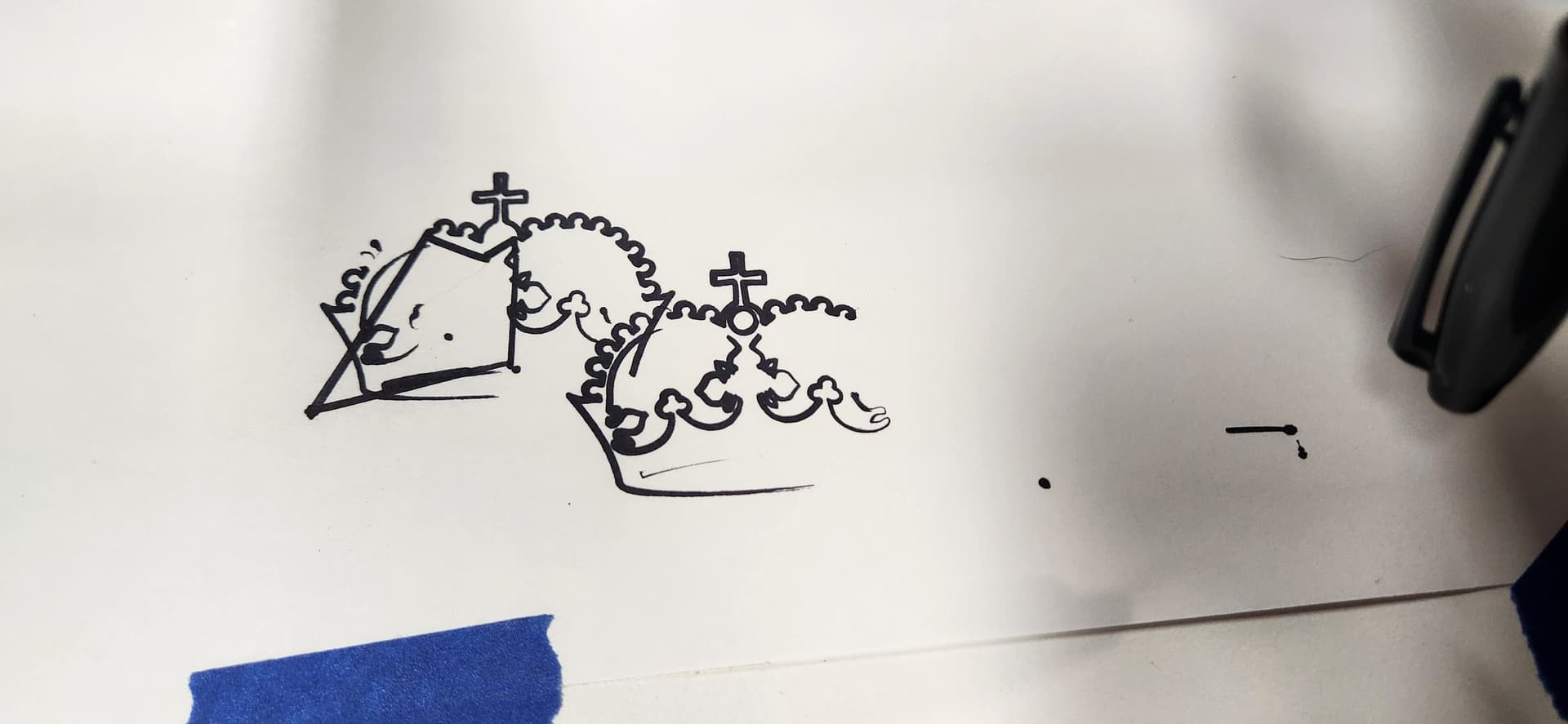

o.k. seen many a crown in here, but none that look like that, what happened, please tell me that is 2 different jobs!!!
I have Estlcam (the CAM part) running on Linux with wine without any problems. I’m using Nobora as distro.
Nope – what you’re looking at is a “gappy” drawing of the crown, plus some of the horizontal moves of the pen where it should have lifted the pen, but it instead pushed it harder into the paper.
When it pushed the pen down, the pen would slip within the zip tie mount, and then I would lose the next bit of crown while I manually pushed the pen back against the paper (while it was drawing). Then the next move would cause another straight line, followed by another loss of actual crown.

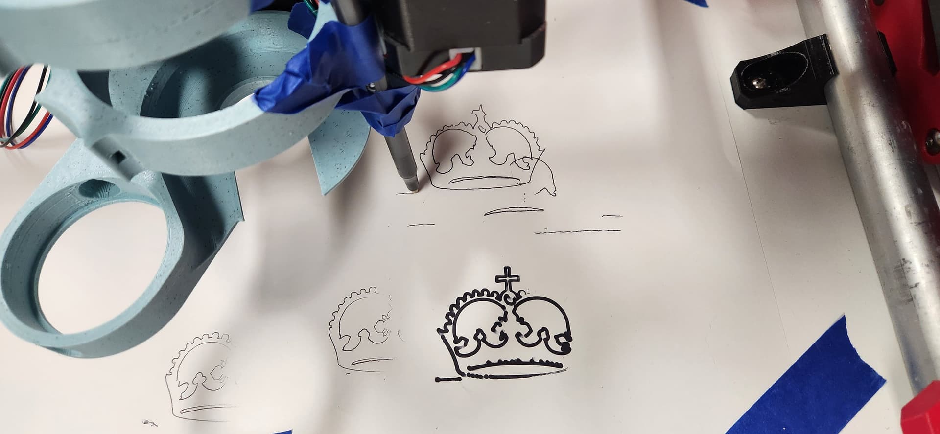

Tonight’s first try on the right, next to last night’s fail. Pen is slipping in the zip ties, but it’s doing much better. More later.

Welp, I think I’ve got it about as good as I can for now. Here are several of the later attempts.
It kept coming off the paper on the right side of the crown, but I believe that’s simply because my gantry and the melamine aren’t parallel. The melamine must be higher toward the middle of the gantry, because both Sharpie and ballpoint pen would completely skip on the right half, and they’d drag pretty hard on the left half.
For that final one nearest the ballpoint pen in the photo, I shimmed up the outer edge of the melamine with four tongue depressor sticks, and it did better, though the tape still had too much “give” and the pen jumped around a lot from dragging on the paper.
Adding some flat crossbracing under the melamine should cure all of these artifacts, but a better pen holder would help, too.
Still need to fix my calibration on all axes. I think my settings are way off. Right now my Z travel thinks it’s about 150mm, but that’s nearly 6". Off by a factor of 2? At least my X is fairly proportional to Y, because the crown isn’t squashed in either direction.
