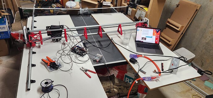

And, FWIW, here’s my obligatory photo with the LowRider sitting on the long-unused ping pong table. :smiley:

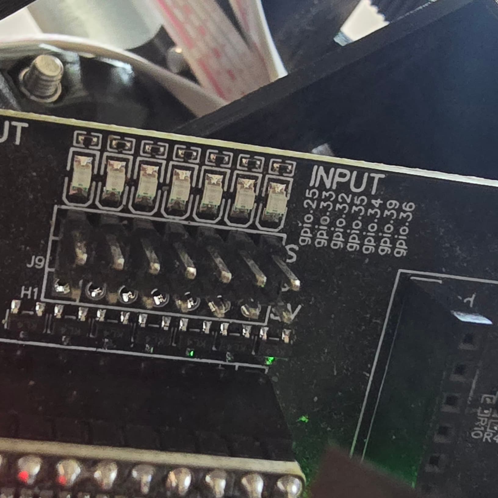

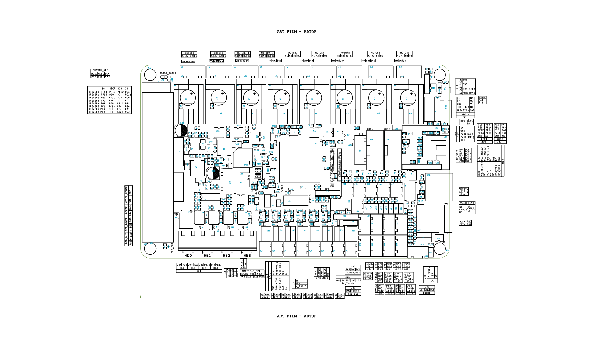

So to be clear, you are using these pins for the endstops right?
They’re different on my board. See here

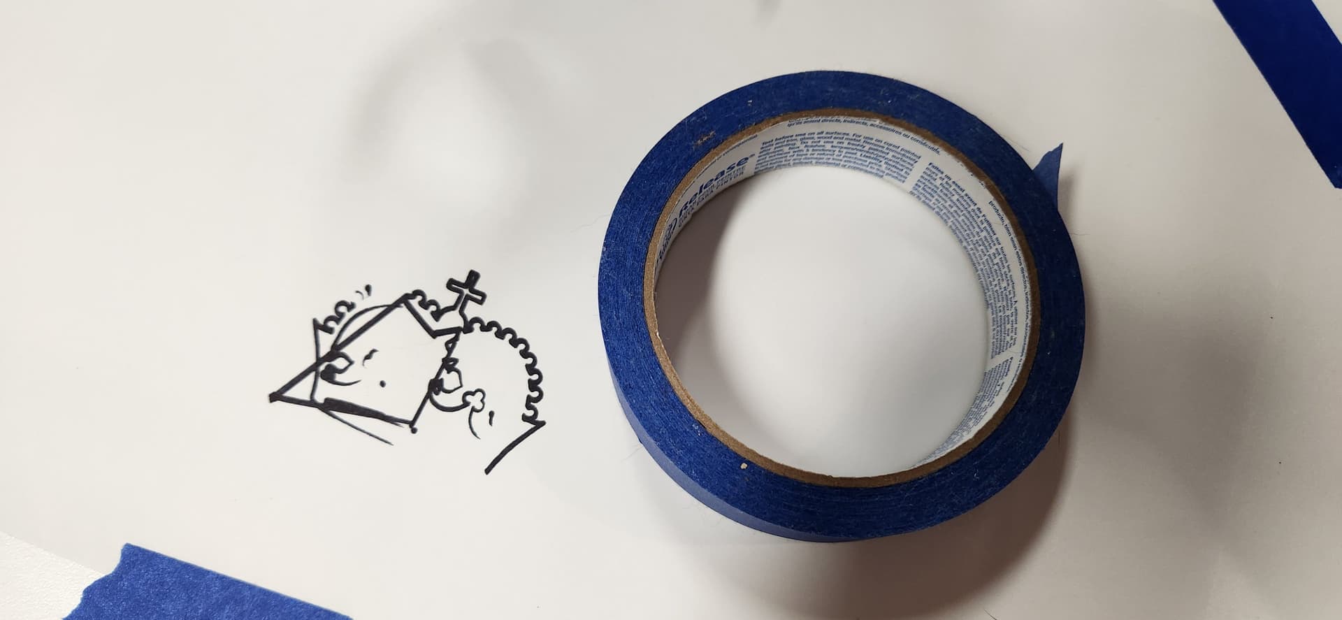

FIRST CROWN! (sort of)
I’ve known that my config for X and Y steps are way off, just put something in the printer.cfg as a placeholder, and 1mm of gcode movement produces way less than 1mm actual.
Still… I decided to give it a try and see what happens. My Sharpie is installed at a tilt and slips in the zip ties. There are some marks made where it should have lifted before travel. But it’s a start!
For scale:

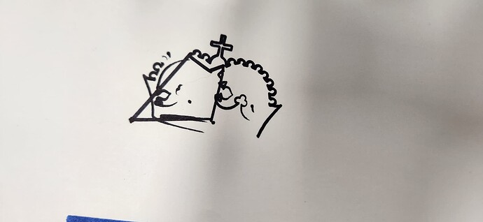

Last night, it appeared that my problem might have to do with Z-hop. Whenever the pen should have lifted to make a move to a new start location, it actually went down for the move, then back up to continue drawing.
I haven’t yet studied the stock gcode file to see where these commands are happening. What I do know is that (a) Z on these machines is backwards from a typical cartesian 3D printer, and (b) this stock file works for other users who have their machines configured correctly.
Any tips on setting the correct Z-hop motion in Klipper? TIA!
