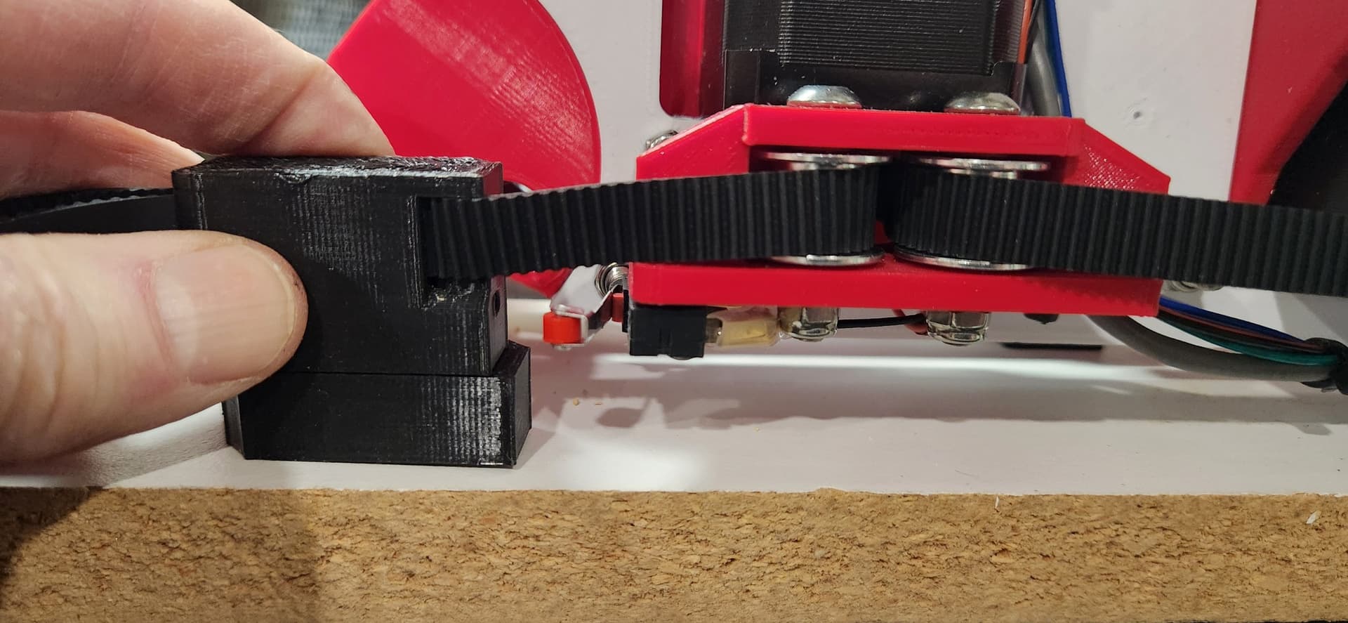

I have a question about alignment of the Y belts. It seems that the Y belt tensioner and Y belt bases put the belt lower than the drive pulleys on the endplate. The tensioner and belt base that I compared had slots at the same height.
As I’m writing this, and going back over the list of parts files, I do see that there are different files for left and right. Do the two sides have the belt at different heights, or are they just mirror images? Different heights would seem odd, because the end plates should be at the same height, I had thought.
Do I have something mixed up? Should I shim up the belt pieces? Or is this normal and just not a problem?
There’s something not right - the stepper and idlers should be parallel with the table, yours look tilted. Can you take a picture of the whole side assembly.
Ahhh, brainfart #2 for the evening’s work. Yes, the other end of the gantry was sitting lower – much lower – when I noticed the issue.
As soon as I read your reply, it dawned on me. Thanks for the quick correction!
#1 was cutting the Y rail too short. Back to Home Depot for another stick of pipe. :man_facepalming:
Much better with the far end at the right height. Thanks again, @Dreyfus!
