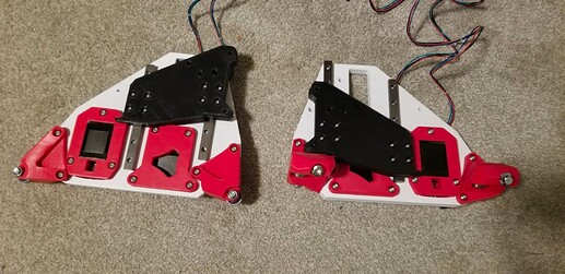

I now kinda wish my big plates weren’t white, but I was bound to what I had on hand. Black would have been best, but by the time I did my core and those 70% infill XZ plates, there’s no way I’d have had enough filament. It was down to red or white. Oh well – the nice thing is that they can always be replaced!

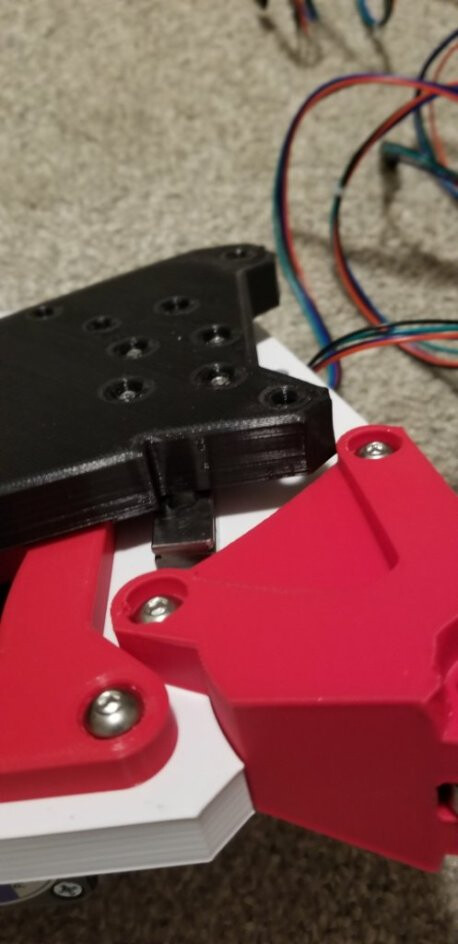

One issue I’m having is that the left XZ plate is bumping on the red wheel bracket as shown here (the lower right corner of the black part & the red part right by the screw). With a little push, it’ll slide on past and give me the full range of Z motion but I’m wondering if I did something wrong, or if a print is a little off. Everything else seems to fit and clear just fine, and I can solve this with a minimum of sanding/filing. Thoughts, anyone? Am I the first to encounter this?
I haven’t seen that before. Is it because if the elephant foot on the black plate?

Thanks, jeffe! Since the first layer of that plate is now the outer/top surface, it wouldn’t be elephant’s foot, but there could be a little top-layer “mushrooming” perhaps. I think the photo accentuates any that might be there more than reality. If it’s simply supposed to be a thin clearance as the black XZ plate moves past that wheel bracket screw surround, I’ll just fix it with a file & some sanding.
I need to take a look. There should be a lot more room. I will be down in the shop in an hour or so.
Cool, thanks. I do think that protrusion on the XZ plate has some ringing on the sharp corners that makes it worse. It’s not like it’s blocked from moving, but it certainly binds as it passes.
It’s also only binding on the left side plate. Right side is close, but it clears.

Mine have at least 1/8" room, but I do not see anything wrong with yours to make it so close.
Not the first, Mine did it as well. I just filed a little off to make clearance and it is fine.
@probrwr Thanks for the reply - good to know I’m not blazing new trails here and that it should be okay regardless!
