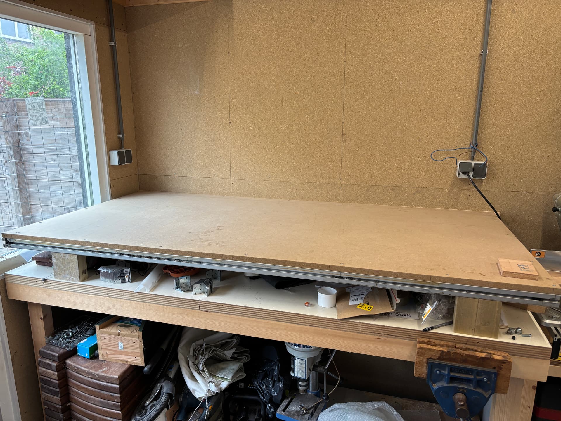

So in 2016 I build my first MPCNC, upgraded it to the 2nd version… burley? I do not remember. However at that time I had no space for this machine. It lived in my attic under a sloped roof. I put on a 5 watt laser en used it for laser engraving a lot. However the Kress router I got for it saw little to no action.

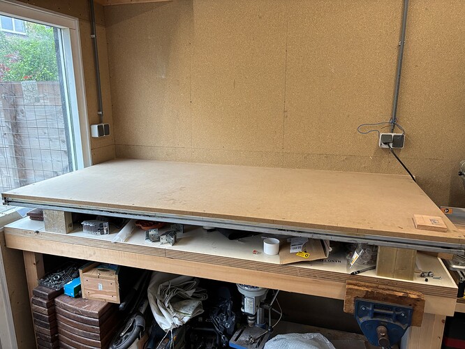

No I have moved house, I have a workshop available for messing around with woodworking. Which I’m not very good at, but I do enjoy. So last year I started building the V3. I build a table using left over aluminium extrusions I had. Connected it to the wall so it can be folded back behind my workbench.
Then I set out to build the V3, but I never got it to operate stable. It would behave irratic, sometimes trying to run through Z stops. Sometimes homing would not work until I rebooted the controller etc. So I parked the project until a month ago, I wanted to pick it up again and saw that the V4 was released.

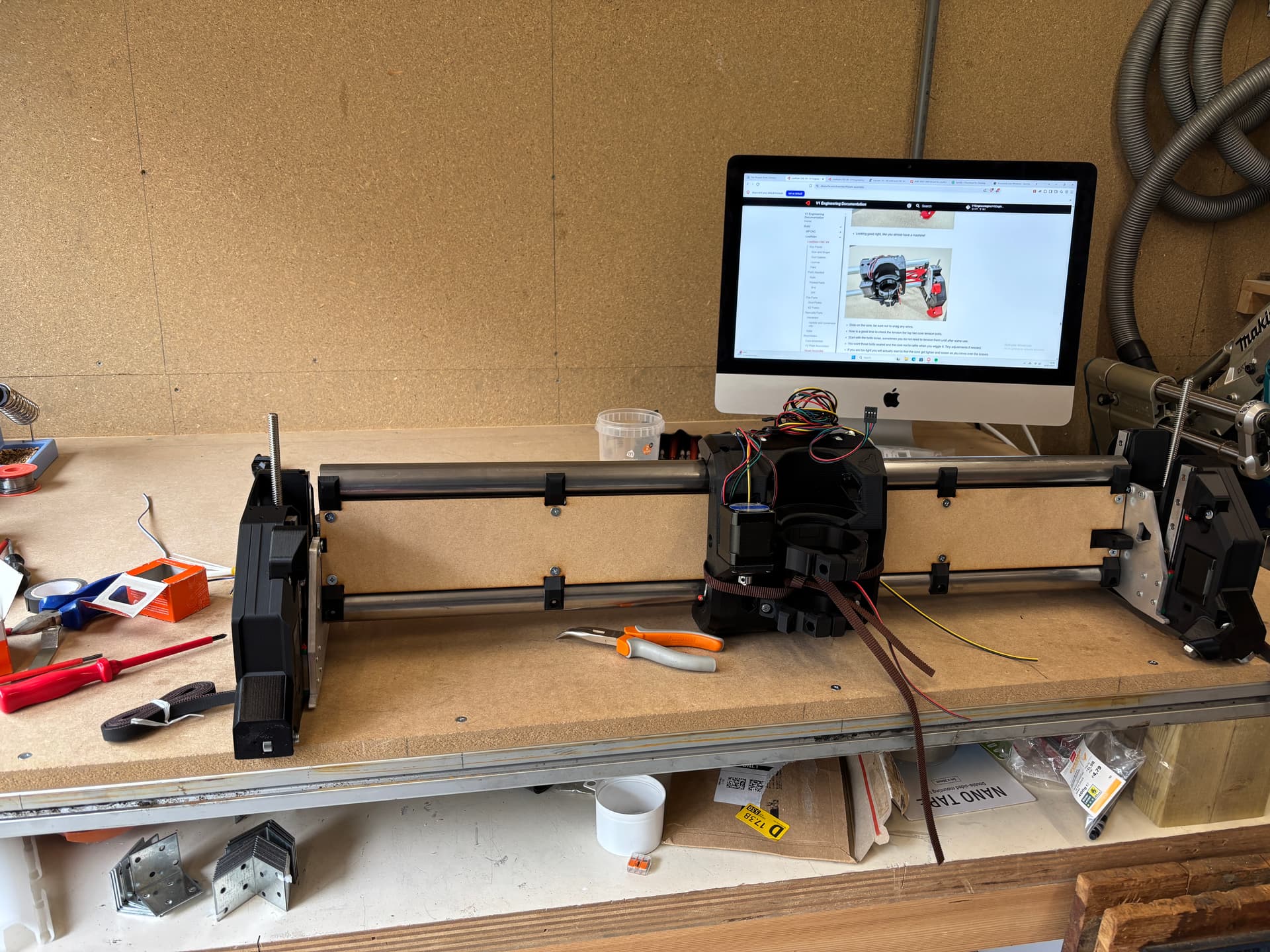

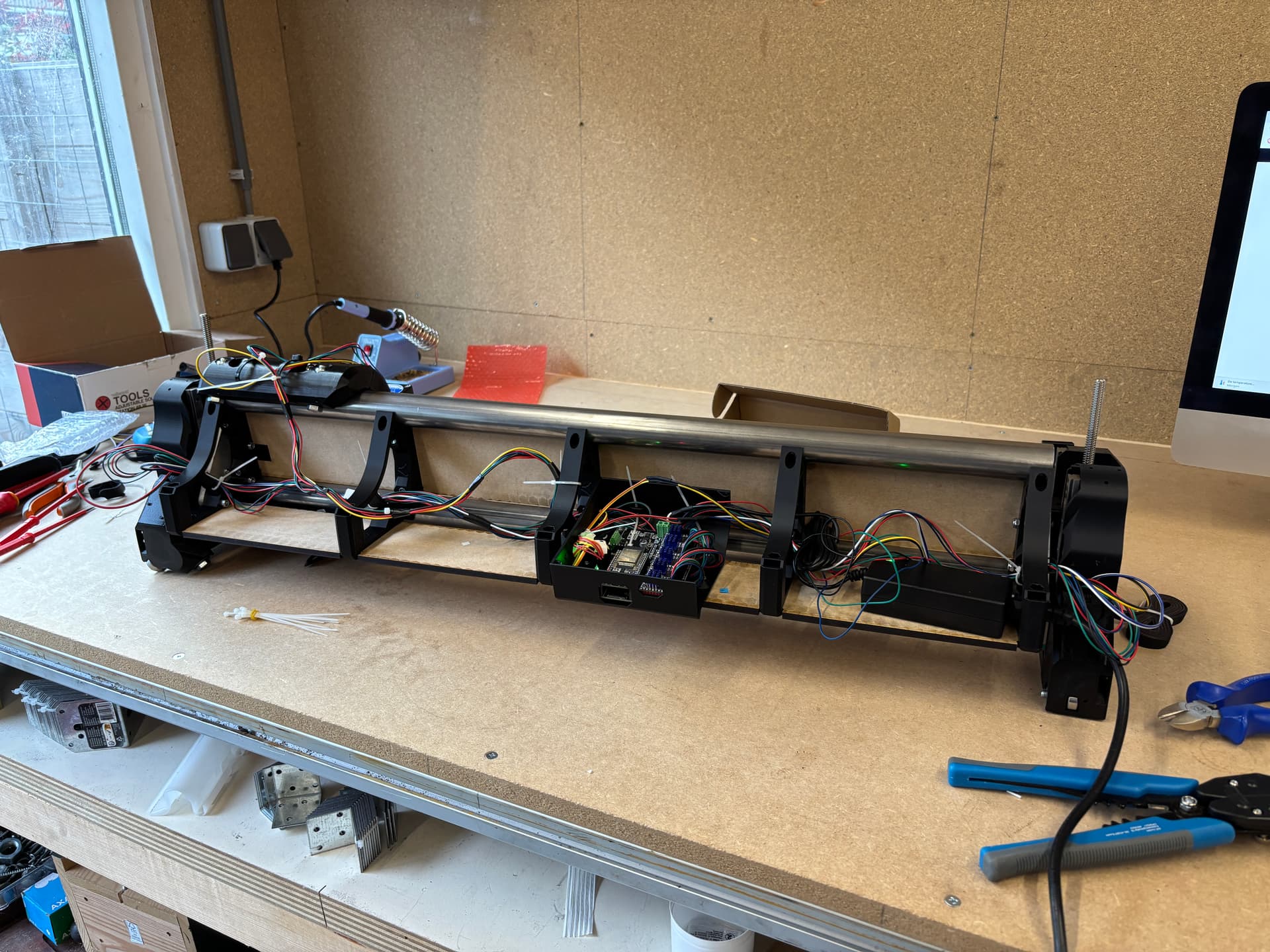

So I treaded myself to a Jackpot controller, some new motors and endstops, this to ensure I start fresh with all electrica components not to run into the same issues again. Now I have started the V4 build and I’m a long way in.
The Jackpot I ordered is setup for the MPCNC, so I need to dig and read what I need to do to get it to the Lowrider config. But hey we will get there.
It’s a treat compared to Marlin - you just upload the LR4 config.yaml using the FluidNC web interface and you’re done.

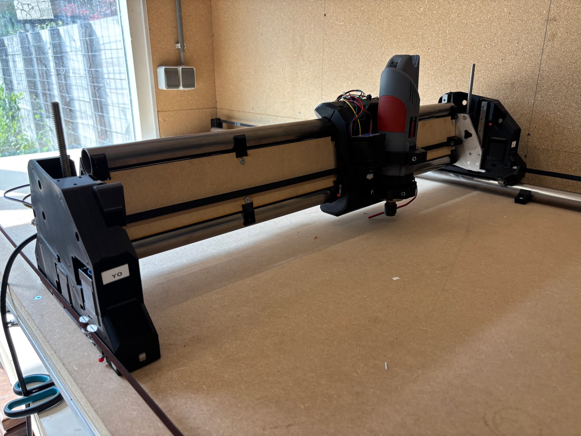

It’s alive. It moves on all 3 axis and the endstops work. Next up squaring.
Oh and a shout out to @Tokoloshe for the AMB / Kress mount. Thank you!!
You are welcome, would not have worked without the Step file of the router that AMB provided (on a Sunday… :smile:). That’s really great customer service.
Ok, got is squared. Levelled my Z initially with a water level. Now did some probing, one side is 0.2 mm lower then the other. Which I think is acceptable :smiley:
Since I can’t find the Z pull off option I think I will just leave it that way.

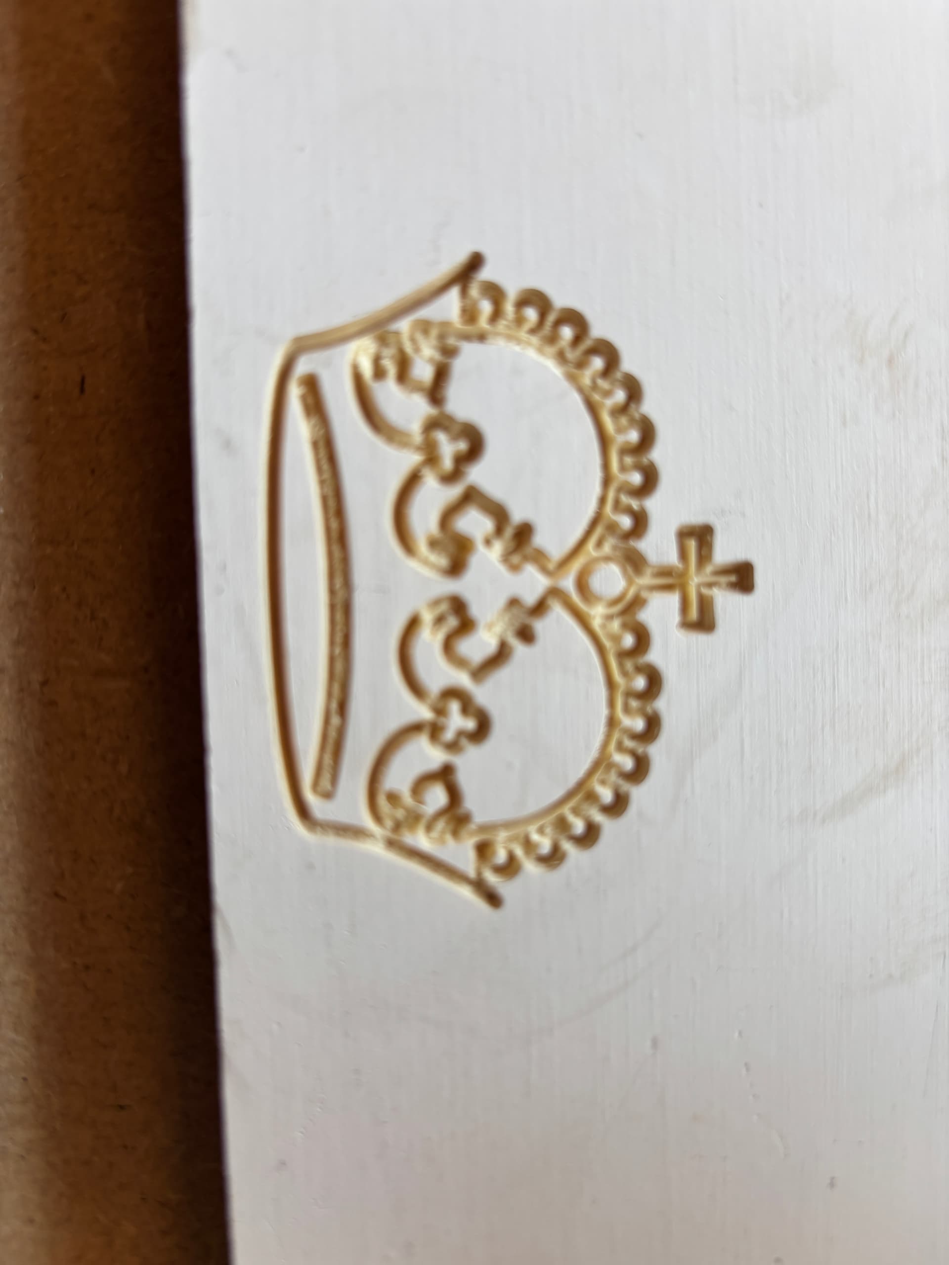

Oké did my first carve last weekend.
Done with a 30degree V bit, but not a V carve operations.

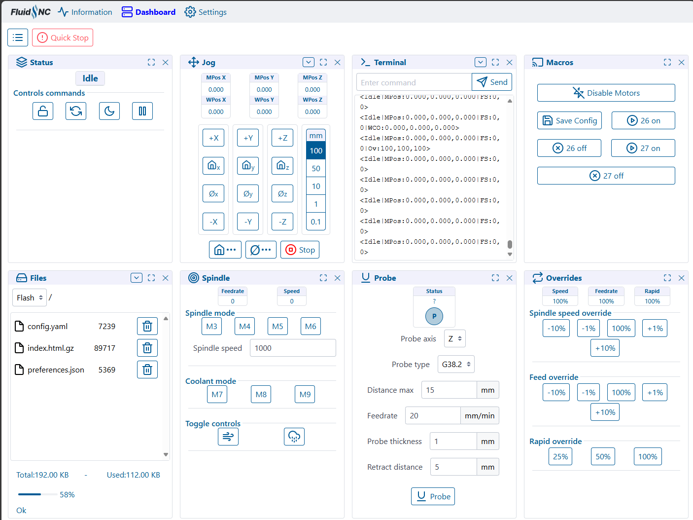

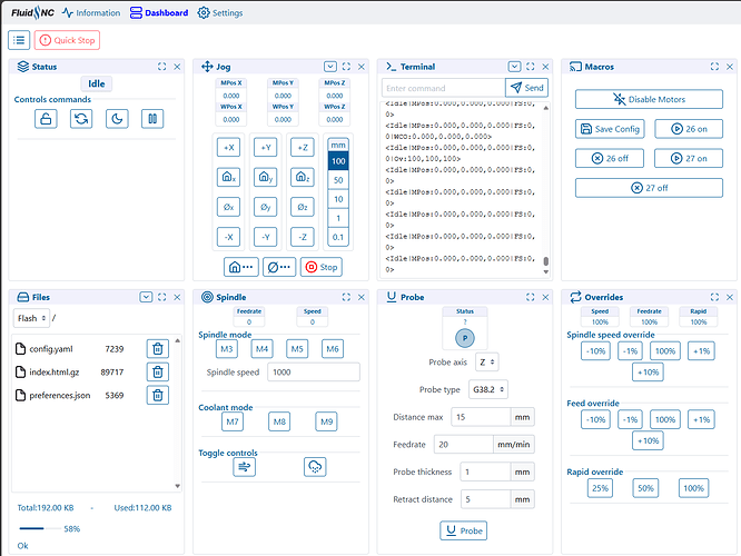

Question, I’m now I think on the default version of FluidNC.
Does it make sense to upgrade to the V3 UI? Not sure what the benefits would be, is there somewhere a link that explains the differences?
Functionally, they are mostly equivalent. I much prefer v3 but some prefer v2.
With the base config, it looks like this:

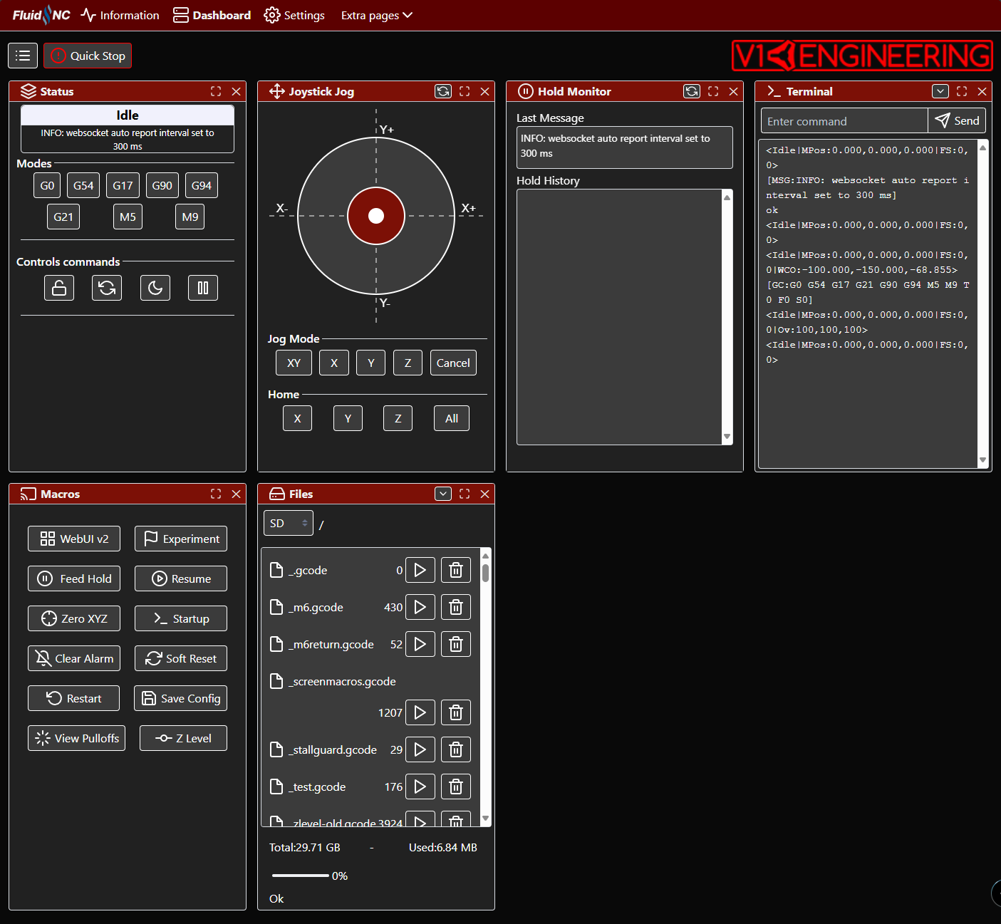

My current configuration, removing panels I don’t need, re-ordering the panels how I like, adding a theme, adding custom extensions:
Thx! To get to the V3, do I need to reflash, or only swap out the config directory?
You only need to update the files on flash. I would backup index.html.gz and preferences.json. You do not need to change config.yaml. You only need the v3 versions of those 2 files plus you can grab favicon.ico.
There’s an updated version out, I would grab the index.html.gz file from the latest release here.
