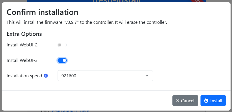

But the WebInstaller…
This is where I don’t know all the details. The WebInstaller (https://installer.fluidnc.com/) is sometimes quirky for me and I don’t really use it.
Not too long ago, they added the option to add WebUI v2 or v3 with that. At some point, Mike will create a PR to update the FluidNC repo, which will then make that the version installed from the web installer.
But, I don’t think that installs a preferences.json file. It’s not that bad to setup yourself, but having a start helps.
So, yea, it’s a little all over the place, but ignoring my stuff, it’s not any more all over the place than WebUI v2. This is why I understand Ryan trying to put stuff all in a single folder to help to simplify things a bit. I’m not sure what the complete solution is.
