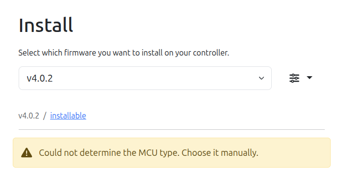

I received the Jackpot V3 yesterday from elecrow. It had some web demo firmware installed so I went to https://installer.fluidnc.com/ and installed the latest 4.0.2.
Then I went about setting up the FluidTouch Pendant https://forum.v1e.com/t/fluidtouch-wireless-fluidnc-pendant/ . Got that going however 4.0.2 is not tested, so I went to downgrade to a 3.9 version of FluidNC….
First problem is “Could not determine the MCU” –> this did not happen on the first install of 4.0.2

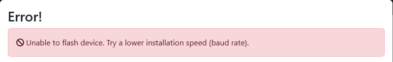

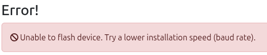

If I select and try to fresh install 3.9.9 it fails with…

I get this too, but it hasn’t been a problem. You just select esp32 and continue.

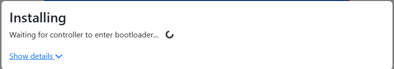

Once you click install and see this message, you need to press and hold the boot button for a few seconds.
If you don’t do that, you’ll see this.
I think that’s all this is.
Fantastic, I’ll give it a go to put my mind at rest.
Pressing the boot button worked and it proceeded to install the firmware without errors. What a relief.
