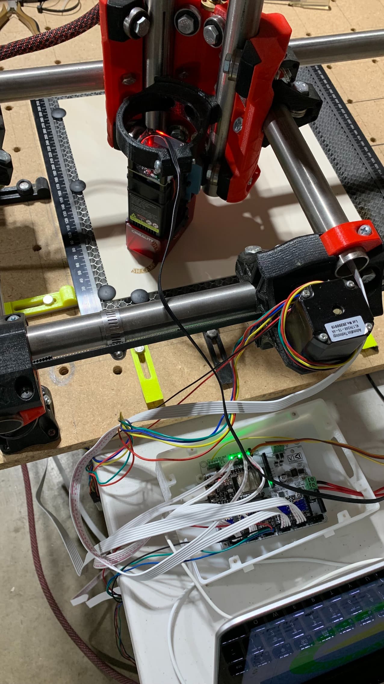

New Jackpot is up and running on my MPCNC Primo
I received my new Jackpot control board yesterday afternoon. I plugged it in and got my MacBook connected to it finally. I had to install the CP2012 drivers. It took a few tries, but I got them installed and working. I was able to connect to it over wifi also.
This morning I disconnected my miniRambo and installed the new Jackpot and endstops. I got all of that working. The endstops are a great new addition.
Then I tried connecting to Lightburn and using my laser. I was able to connect and move the laser around without any problems so I enabled the laser settings in the config.yaml. Nothing would work! I couldn’t move the laser or connect reliably. So I reinstalled the default config and everything worked again. I reread @MakerJim 's post about his JL1 laser. I saw where @Ryan said to remove the gpio.27 setting in User Controls. After I did that it was all working!!! Woohoo
Here’s my first laser burn with the Jackpot.
I will have to make a separate laser section in the docs. Everyone is immediately enabling the laser.

I’m really happy my posts helped you. Congratulations on getting your Primo running on the Jackpot!
Thank you @MakerJim .
What’s the hose clamp on your tubing for?
@Zashi, I used them for mechanical endstops. Now that I have the Jackpot and dual endstops, I’m using them to trigger the switches.
