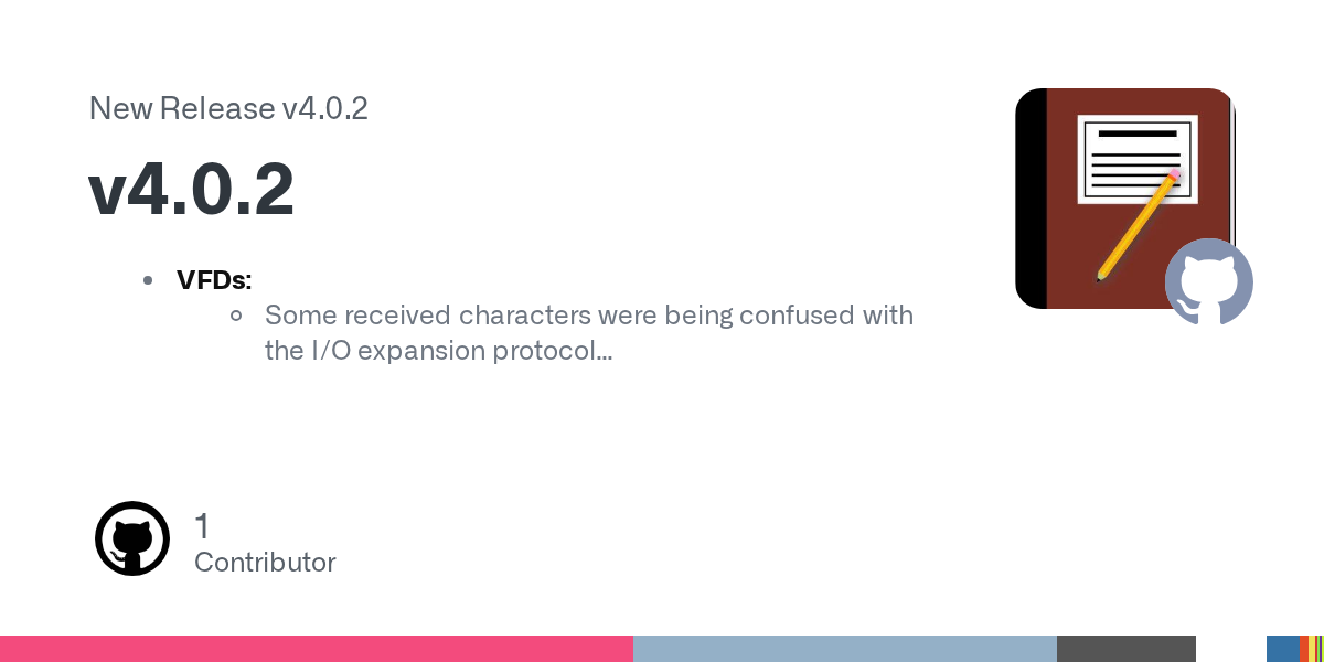

FluidNC v4.0.2 was just released. I’ll be testing this one as I believe it may be stable now. (If you’re relatively new, don’t try it yet until we’ve done some testing.)
4.0.2 and there is a slightly newer webui, 3.0.10.
