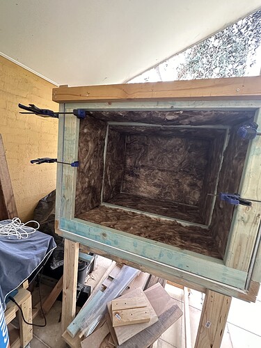

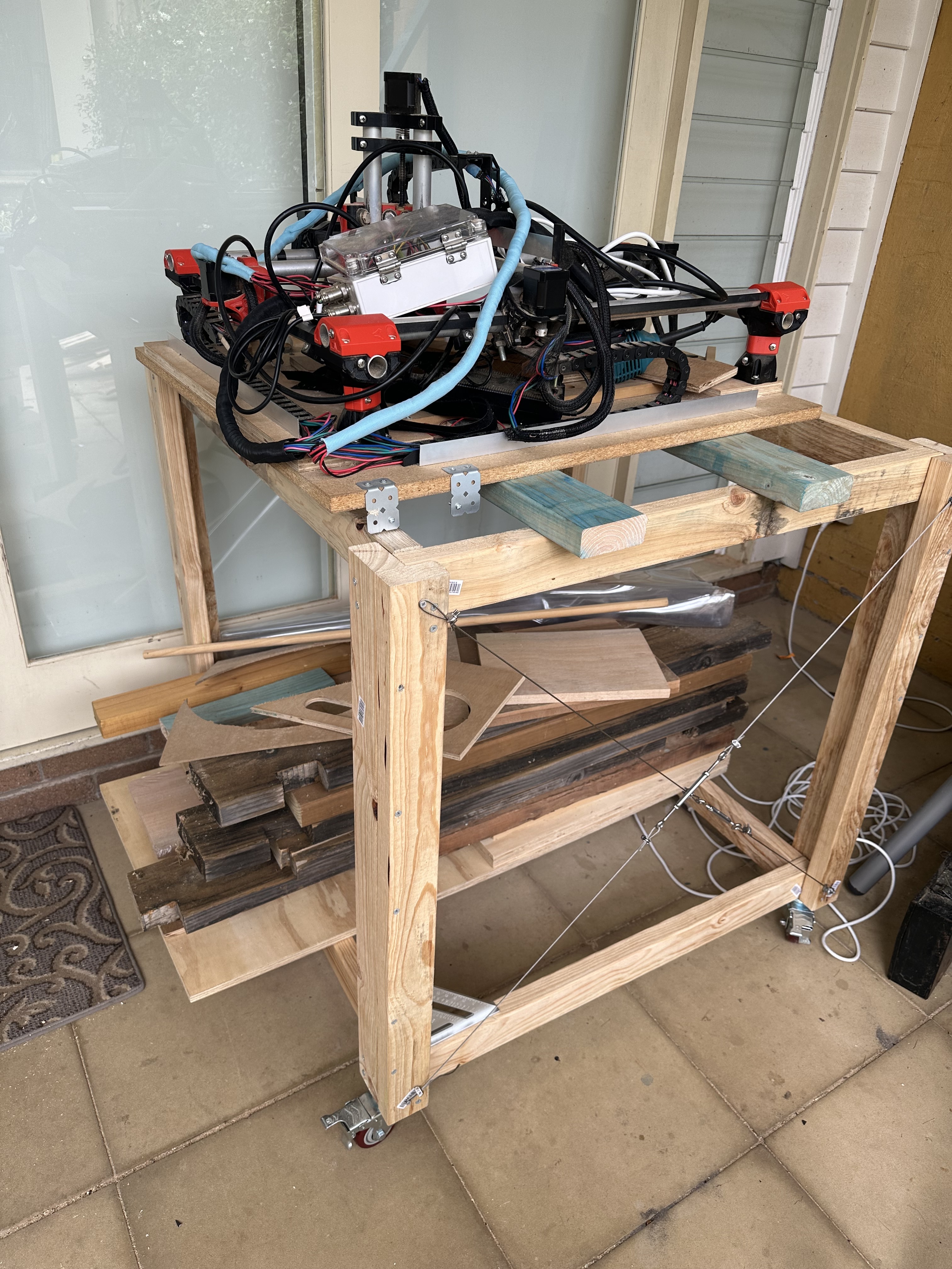

So I’ve finally bugged the neighbours enough that I’m making a soundproof box for the MPCNC.

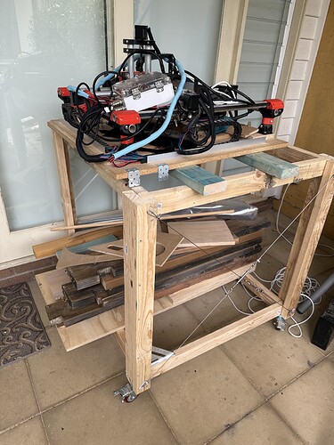

I’ve now made an enormous wheeled stand for it, and am in the process of making the box.
The plan is to enclose 900w x 900d x 700h, and it will be lined with gyprock (plasterboard) then rockwool then another layer of gyprock. Door will be similar, but with a perspex window. Haven’t quite worked out the door sealing yet.

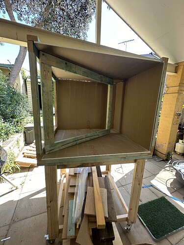

frame mostly done. two outer walls cut.
wheely base is done. it’s just holding my woodpile and the disconnected primo right now.
i’ll be mounting something on the top either a board or some more 90x35 to support the soundproof box.
4/5 outer walls fitted. should be able to get started on insulation today.
ooh so close :slight_smile:
well i still have a door to make but hey
Very nice! I’m thinking about doing something like that under a bench top. I’m curious how much it cuts down the actual noise. It’s been ok for now, but don’t need a noise complaint from the HOA.
i don’t want to speak too soon before the door is fitted but it’s noticeably quieter inside the enclosure if you put your head in. like your ears are blocked. it’s really weird. it’s definitely a bit of an experiment to see how quiet i can make it but i’ll run some tests and post results!

Soundproof box is going very well. There’s still some work to do on that, some additional rubber seals around the door frame and dust collection will be next on the hitlist. So far the majority of carves are quiet enough to not disturb anyone (ie barely noticeable), however these carves on plywood were noisier than I’d like.
