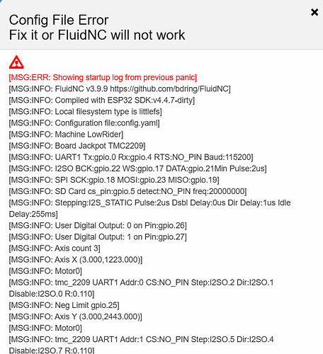

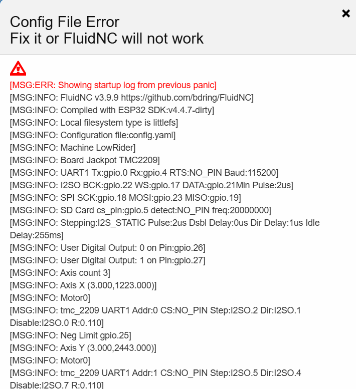

I reconnected to check if the things that Jonathan asked for and got this message
Keep in mind that I can’t have a live view in the forums if I’m connected to FluidNC because I have to disconnect from my home Wifi. And if I’m connected to my home wifi, I can’t connect to FluidNC. So I have to keep leaving and coming back, that is driving me crazy. I can’t help but wonder if that is somehow contributing to this problem.
Something is going weird for you to be getting config file errors all the time. That one is above my paygrade unfortunately.

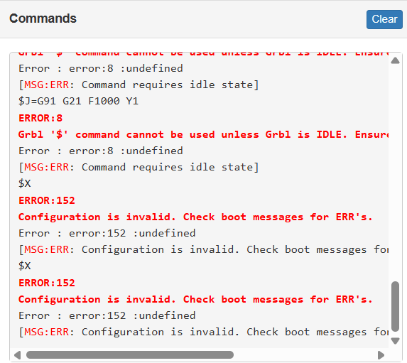

I have an alarm now that I can’t reset, so I can’t check the limit switches as you previously requested that i do.
Also, how do get to the Terminal? I can’t remember how I got there last time, I’ve twisted my head in knots.
You should have a screen similar to this. its the lower right window. If you type ~ in that window I think it will clear the alarm. Its been a while so I might be incorrect
That is also the same place you would type in $limits
