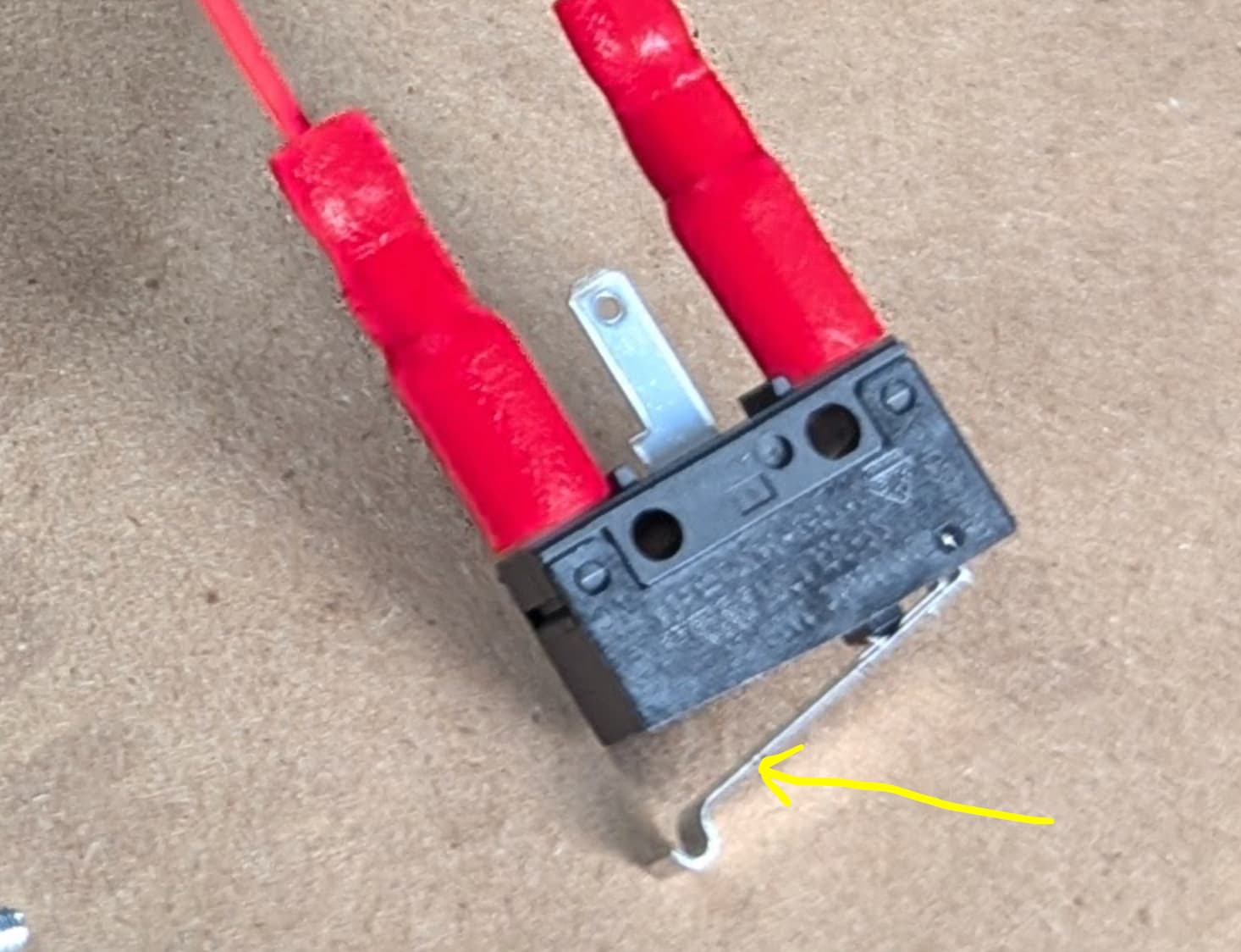

Press this lever is what he means.

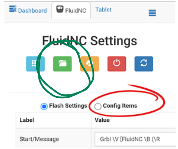

FluidNC tab. Green circle (not red)

So that means my limit switches are set up correctly?
Yes sir it all looked right to me. Still not understanding the issue with jogging you are having. That one is beyond my knowledge base
