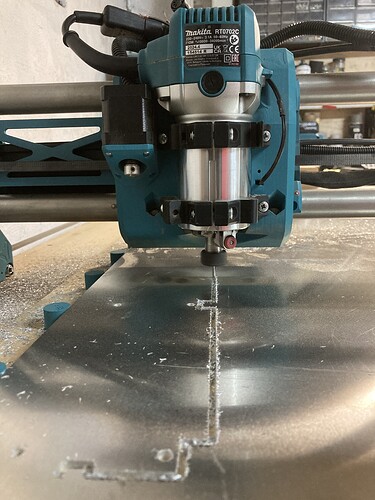

New build Makita style
Dang it that is sharp!

1/8th bit one pass 3 mm. aluminum!
This machine is incredible.

Strut plates finished. 1/8 bit settings were a wild guess. Slow but full one pass cut. Router at lowest speed.
How are those measurements? Are they spot on? :slight_smile:
Nice build and cuts!
1/8" single flute upcut bit, 3mm DOC, Feed 127mm/min, Makita lowest (~10k rpm), Plunge 20mm/min, straight cuts (i.e. no Trochoidal or Oscillation), no Vac or air assist.
Cutting Alu 6061?
I have no clue but it did the job.
Just take your calipers and measure the holes and tabs? :stuck_out_tongue: It’s important (see above) that the struts are pretty accurate.
Measurements are spot on
