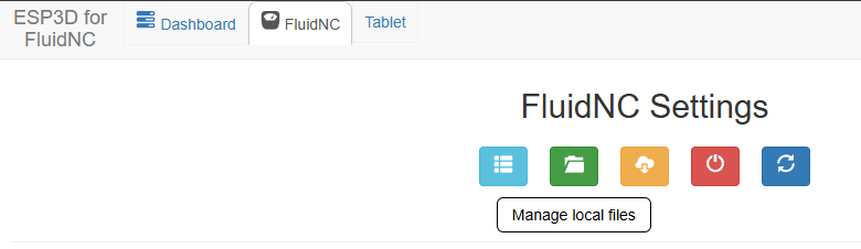

I am at the step of connecting all the end stops, stepper motors, etc to the Jackpot controller, playing around with FluidNC to test that things are in working order. However, I’m having an issue where the steppers connected to the X1 and Y1 ports are not moving when jogging their relevant gantries. At that, the stepper plugged into the Y1 port is jogging when the Z stepper is jogged.

I ran the $SS command in the terminal, as was recommended, and unfortunately I do not have that with me to post (yet) because the tablet I was using ran out of juice before I could copy it. However! I did notice that there was a line that read Machine: LowRider, which makes me think perhaps the wrong firmware was loaded onto the Jackpot?

The fix is easy just upload the MPCNC config OTA and it will reboot as an mpcnc controller.

In case you need a bit more direction to load the MPCNC config, you want to download the config.yaml file from here:
FluidNC_Configs/MPCNC/UI V2 MPCNC at main · V1EngineeringInc/FluidNC_Configs
Then you can upload it in the WebUI by selecting the FluidNC tab and the green folder button where you can upload the file.

I just want to make sure I’m understanding correctly, so order of operations is as follows:
  1. Download config to my device.
  2. Upload config to WebUI directly from my device via green folder button. Does uploading the new config file replace the LR config, or do I need to do that manually?
  3. Power down Jackpot and restart. Is there a power down command/button, or is it simply just unplugging the Jackpot?
Yep, you got it.
It will automatically replace the existing file.
I usually just cycle power. Technically, you can run [ESP444]RESTART in the terminal.
