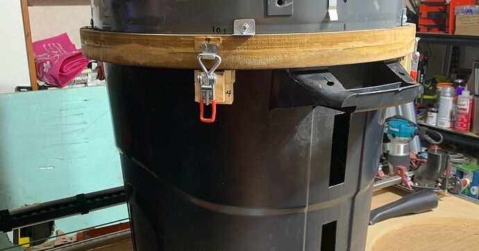

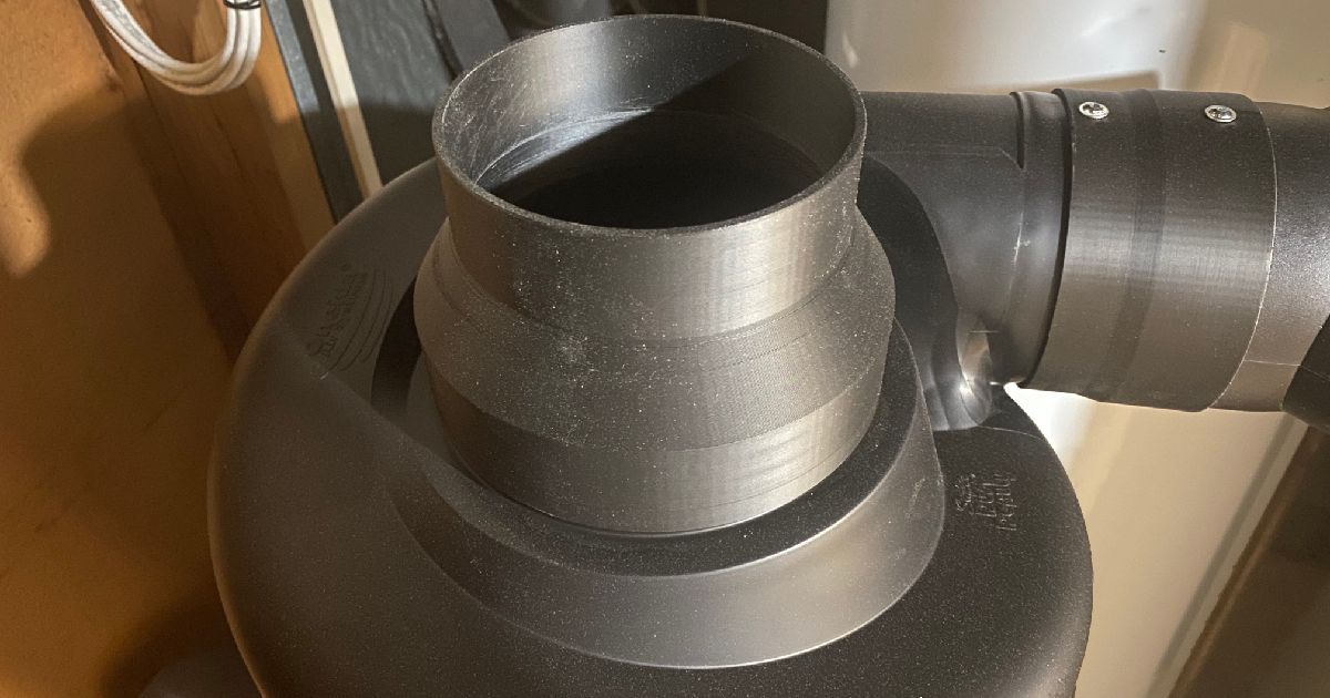

@Beans I should have mentioned, I have added a “Super Dust Deputy 4/5” to my HF dust collector, which… the Dust Deputy is sitting on top a big trashcan, mounted to a reinforced trashcan lid. For that matter, I altered the HF dust collector to have any dust that makes it that far, go into a bag inside a trashcan, modified to be clamped to the underside of the baffle.
Pics of the Dust Deputy trashcan lid mount concept are in this listing:
And pics / details about the mounting of a trash can to the underside of the HF dust collector are in this listing:

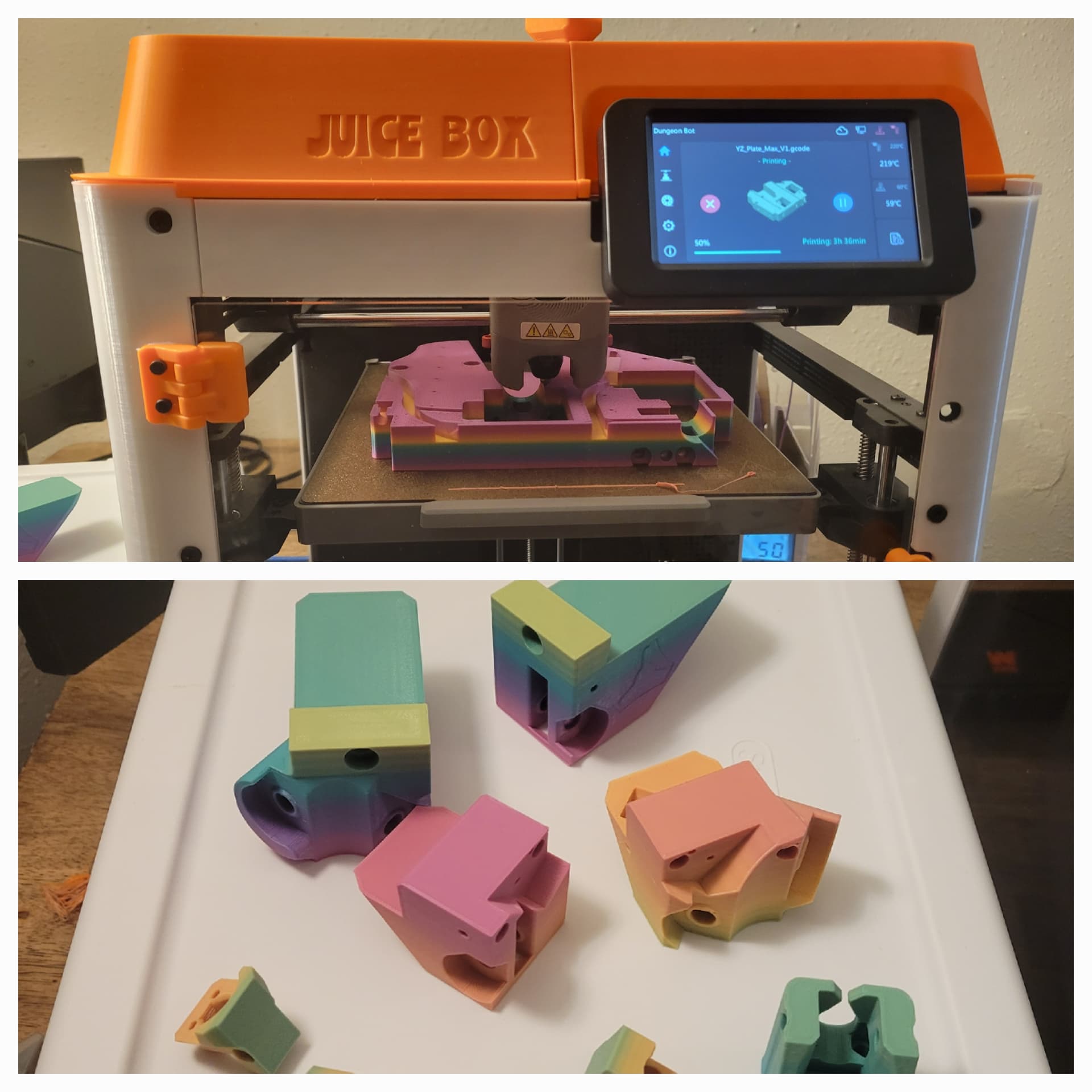

It’s been almost a month and things have moved along – maybe a bit slowly. I had the opportunity to visit @mbamberg and learn an incredible amount of useful information about how the machine is built, why its important to follow the yellow brick road, software workflow, common issues, and how to plan ahead for future modifications. I got to see two of his machines (and parts of a third). If it wasn’t for the fact that my work queue just exploded, I’d have gone back down for some hands-on build experience. My day with Mike confirmed that I’ve chosen the right path for my needs. He also helped convince me to go with a 4x4 cutting area to start and now that I’ve seen how simple it will be to upgrade to 4x8 later on, I feel good about that decision.
I’ve got all the (non-printed) parts here, along with a Carbide spindle that Mike recommended. I bought the Flashforge Adventurer 5M and built the enclosure according to @DougJoseph ‘s instructions. I have to effusively thank Doug for the tip. I got the printer and the enclosure kit for $265 all-in. The rainbow candy PLA was 2-for-1 on the FF site – extra bonus!
Last night I began printing the LowRider parts:
