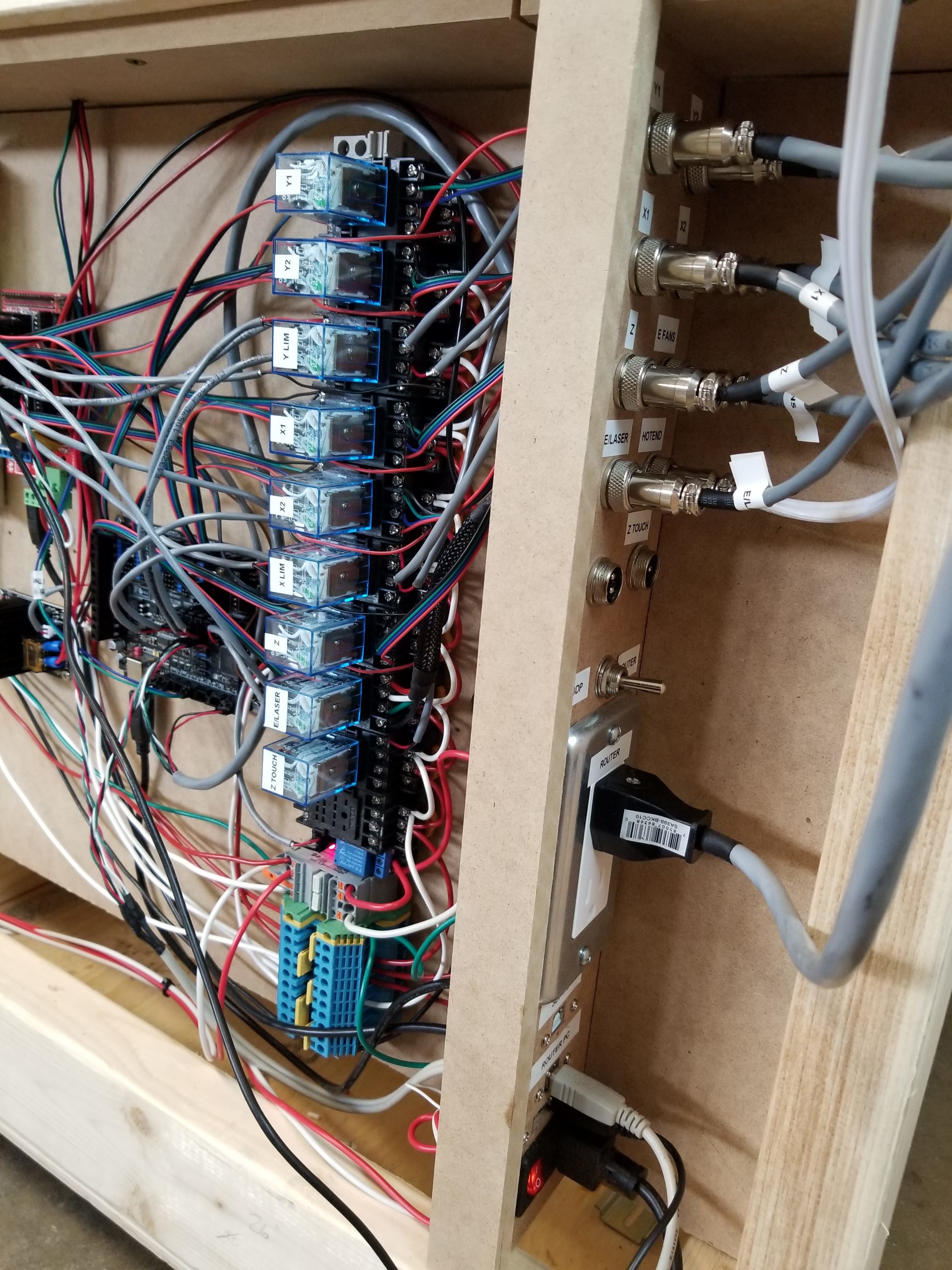

Hello all! I started this project almost exactly 2 years ago, and after lurking in the forums for a couple of years and slowly making progress on my MPCNC, I’ve finally got it moving! I have decided to call my machine “Jack”, because I always intended it to be a Jack-of-all-trades (master of none). My goal was to do milling, laser etching/cutting, drag-knife cutting and also large 3D prints. So against all recommendations, I made a fairly big 24" x 18" x 8" usable area machine with 1" stainless tubing and dual endstops. My router is a Bosch Colt GKF125CE that I got on sale awhile ago, with a 1/8" collet from elairecorp.
I stumbled upon a failed 3D printer project on craigslist that provided me with the steppers, RAMPS, leadscrew and a bunch of other bits and pieces for super cheap, so that got me on the way. The rest of the hardware was mostly from Aliexpress, Homedepot and a local electronics store.
With wanting to be able to do all sorts of things with this machine, I decided it might be easier to have 2 sets of firmware; one for CNC/laser, one for 3D printing. To do this, I used 2 control boards; RAMPS for CNC, Fysetc F6 (6 driver board) for 3D printing. To easily swap between the two boards, I put in a bunch of mechanical relays to swap steppers and switches etc. between the two. Thus far, that hasn’t seemed to hurt anything (other than the time it took to wire the whole works), but I haven’t tried the F6 board yet.

Wow. That is a lot of relays. Looks big too. That crown and cal test look great. The stainless really makes it pop. Thanks for sharing.
Yeah, they’re 4-pole relays, so 1 per stepper, 2 for the endstops, then 2 for accessories. Could probably make do without switching the Z-min, but I haven’t decided if I want that for 3D printing or not yet. Also have a small relay for turning the router on and off.

I thought about doing this kind of dual board setup, but gave up because it sounded like a lot of trouble. My Idea was a bit different though, I was thinking about making a single wiring harness plug which would fit both boards. This way I’d just have to unplug the first board and then plug onto the second board. Your idea is more elaborate, but even more complex, I’d be a bit afraid about long term reliability, troubleshooting might be difficult (but it’s a fun mod and it might work just fine, try and see!)

Thanks. Yeah, I debated doing something like that, just having different plugs for the different boards. But for me personally, the relays actually seemed like the simpler, more elegant solution. We shall see how it holds up though!
