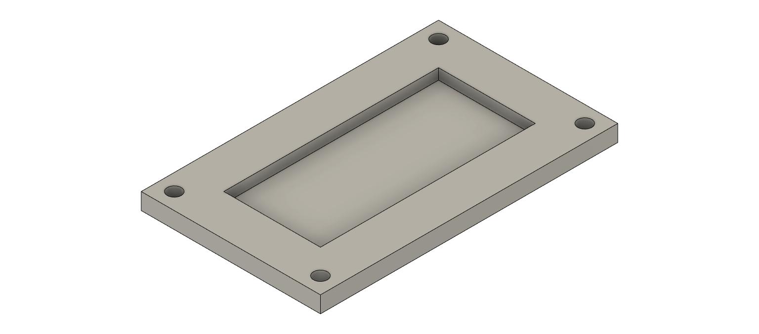

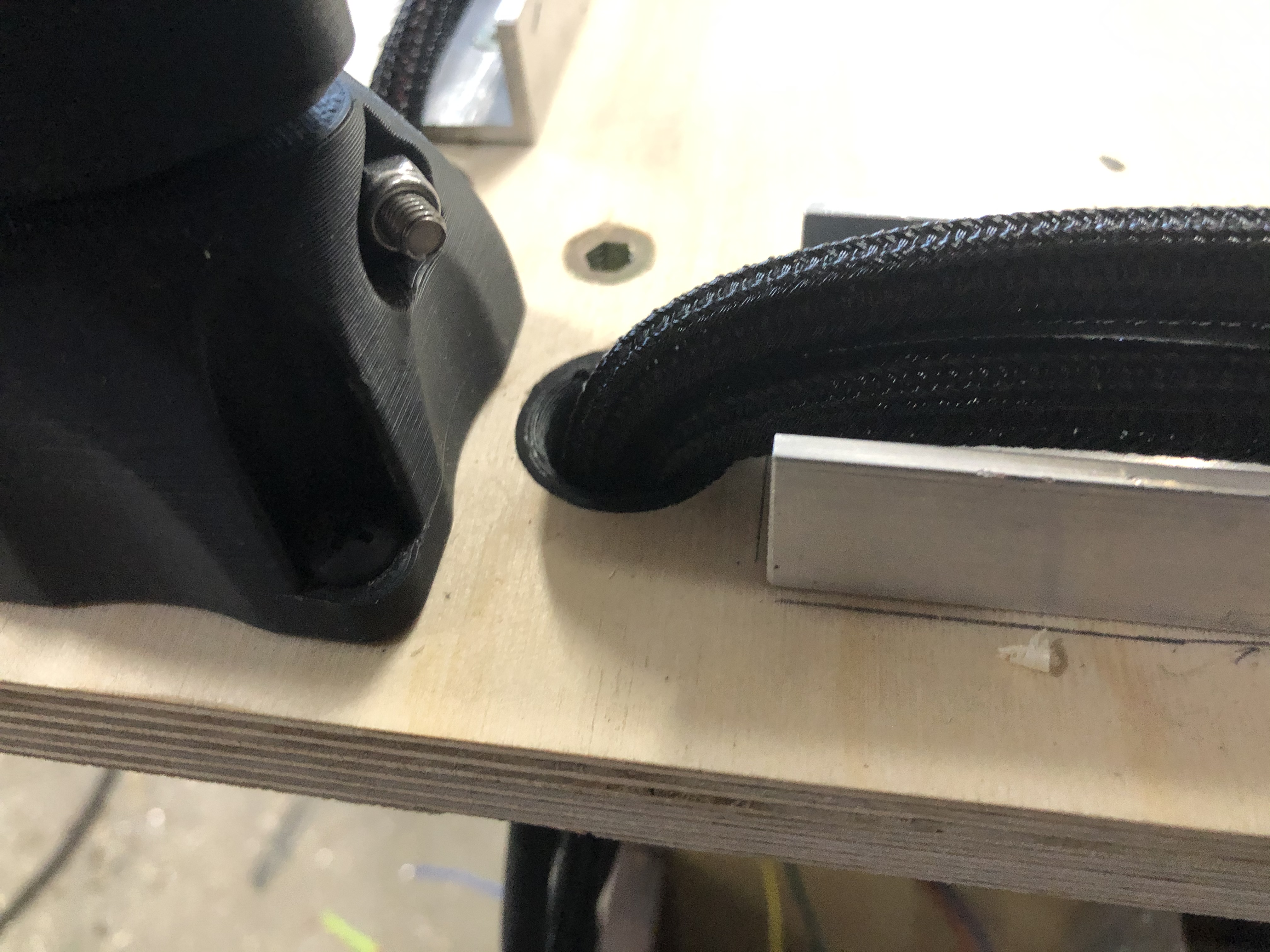

In addition to the tubing grommets I designed some table grommets where the wiring passes through. Nothing crazy here, but for the sake of being complete I will include them. In the first photo below don’t pay attention to the extra two holes, I reused this board from my original MPCNC and this was the old drag chain mounting location.
3D rendering:
STL and STEP file:
Table Grommet 3D Files.zip (63.9 KB)

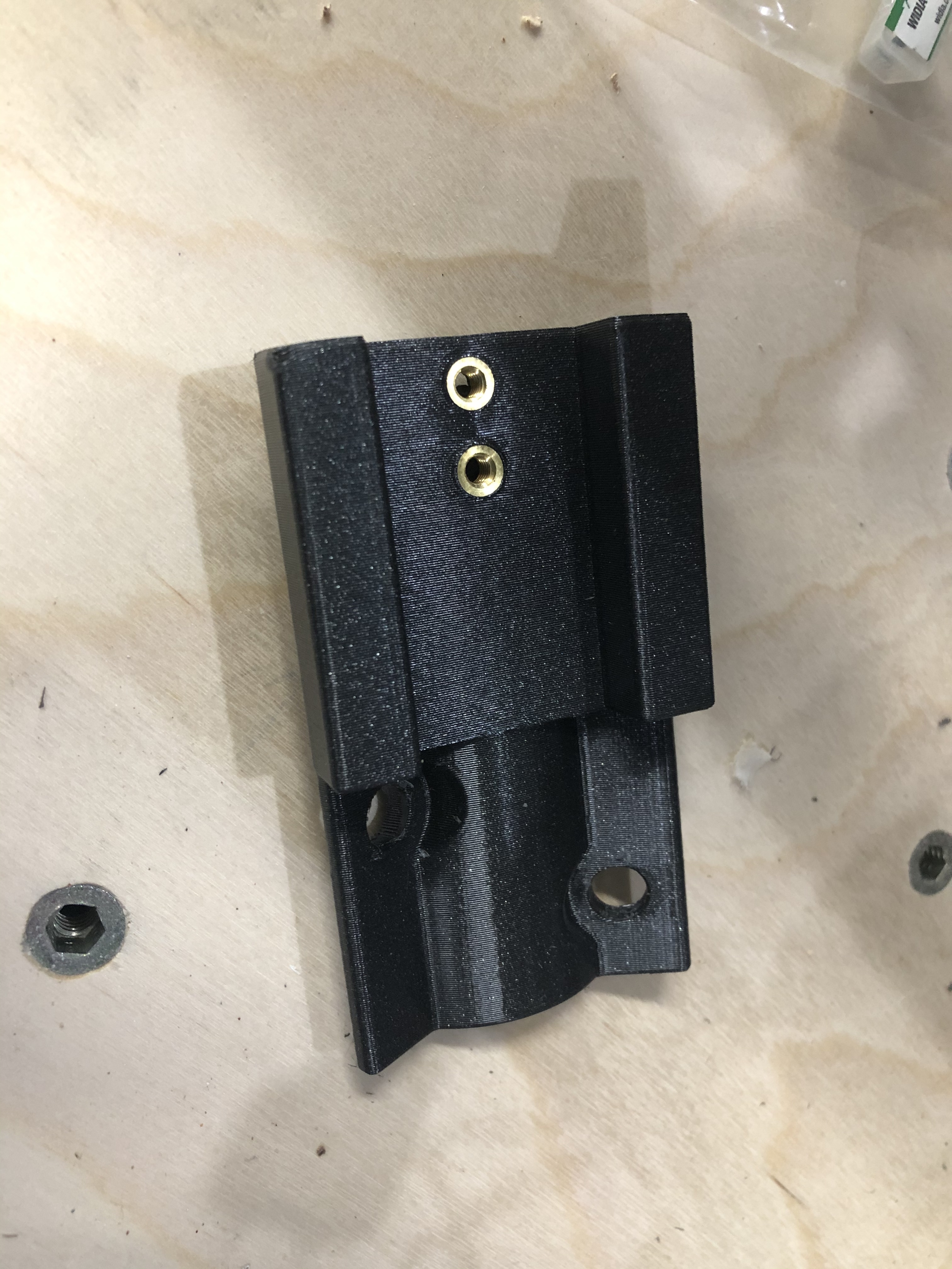

The other feature that was somewhat of a challenge and required multiple prototypes to figure out was the lower drag chain mounts. There are actually two separate designs here because I had to use two different drag chains. For the MPCNC minimum Z height, which I used here, I could not fit the larger drag chain under the lowest rail. I reused my old, smaller drag chain and, as a result, had to redo the mounting points for the unit as they are different. Overall pretty simple modifications. In the end, you can customize the lower mounts to match your use case.
I would not recommend using the smaller drag chain I did though. It’s a pain to use because the top doesn’t open to run the cable though like it does in the larger ones. Again, links to everything will come.
3D Rendering:
Bracket for the larger drag chain:
Bracket for the smaller drag chain:
STL and STEP Files:
Truck Bracket.zip (279.6 KB)
Truck Bracket Small.zip (295.2 KB)
Hardware:
M4 x 8mm flathead screw to attach the large drag chain to the underside of the bracket via heat set threaded inserts. These are the same screws used on the step above.
M4 x 5mm socket head screw to attach the smaller drag chain to the small bracket.
M4 heat set threaded insert to be used on the underside of the bracket, the same ones used in the upper bracket.
Larger drag chain (same one as used for the Z axis above)
Smaller drag chain (I don’t recommend this one but it does work just fine for the Y axis that is closer to the workbench).
It is worth noting that the drag chain mounts I designed will reduce your useable cut area. This was a non-issue for me because it didn’t reduce the area any more than the vacuum attachment I also printed. The router mount and vacuum attachment is not my design although I did remix the vacuum attachment so it can be secured with screws and threaded inserts.

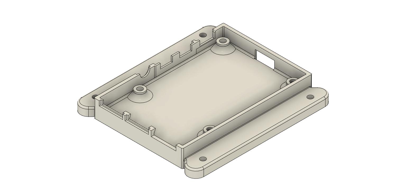

Continuing from above, the electrical cabinet
Hardware:
Power supply
Raspberry Pi 4 8g to run OctoPrint
Fan for Raspberry Pi
USB-C cable for Raspberry Pi Power
Buck converter 12v to 5v to power Raspberry Pi
3D Renderings:
Raspberry Pi Case, I remixed this from another design but only use the bottom since this is already in an electrical box
Buck Converter case, this is a very simple design, there are no mount points on the buck converter I posted so I simply epoxied the board into this case and then was able to screw it into the electrical enclosure.
STL and STEP Files:
Raspberry Pi Case.zip (185.9 KB)
Buck Converter Case.zip (8.7 KB)
