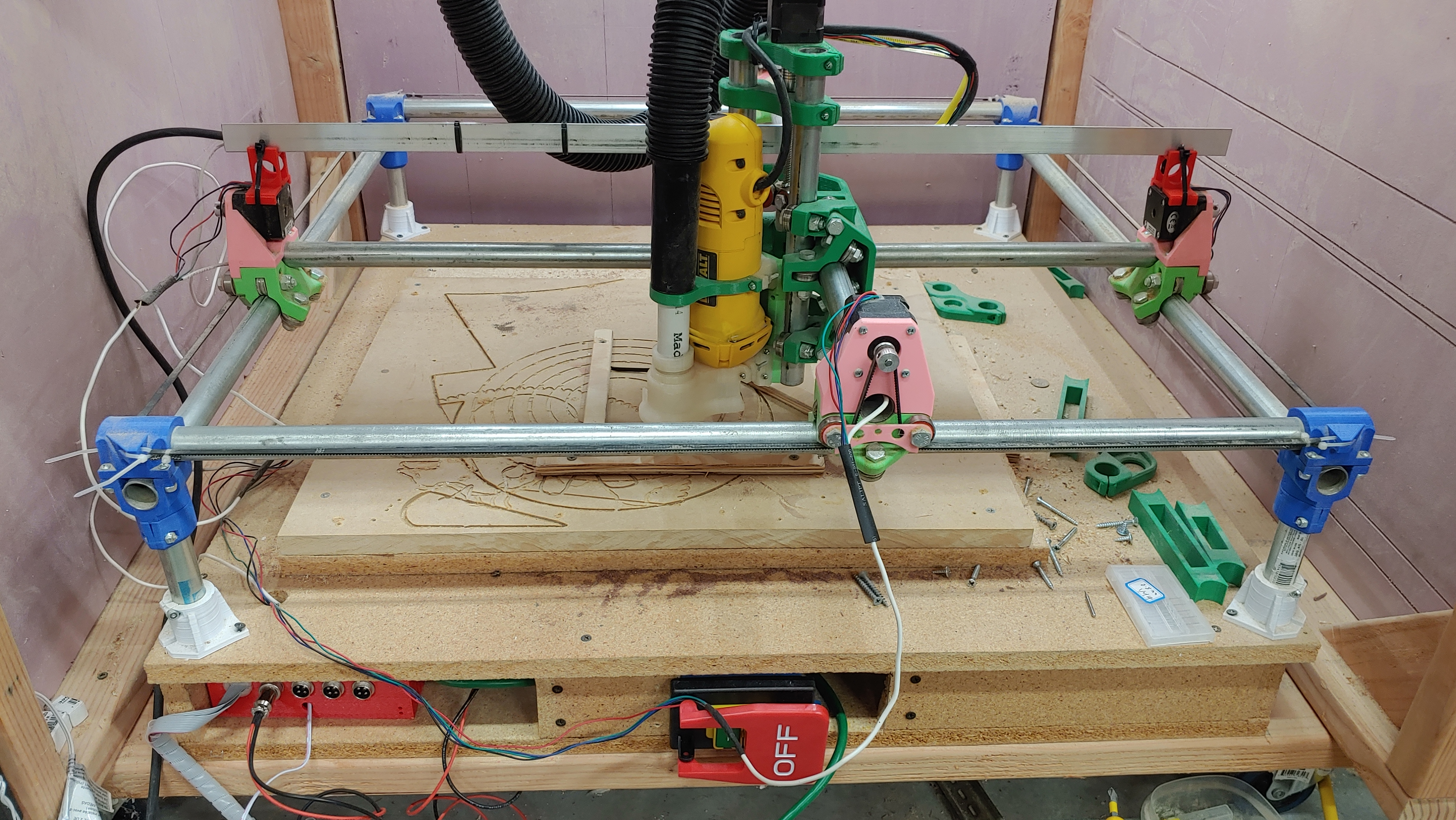

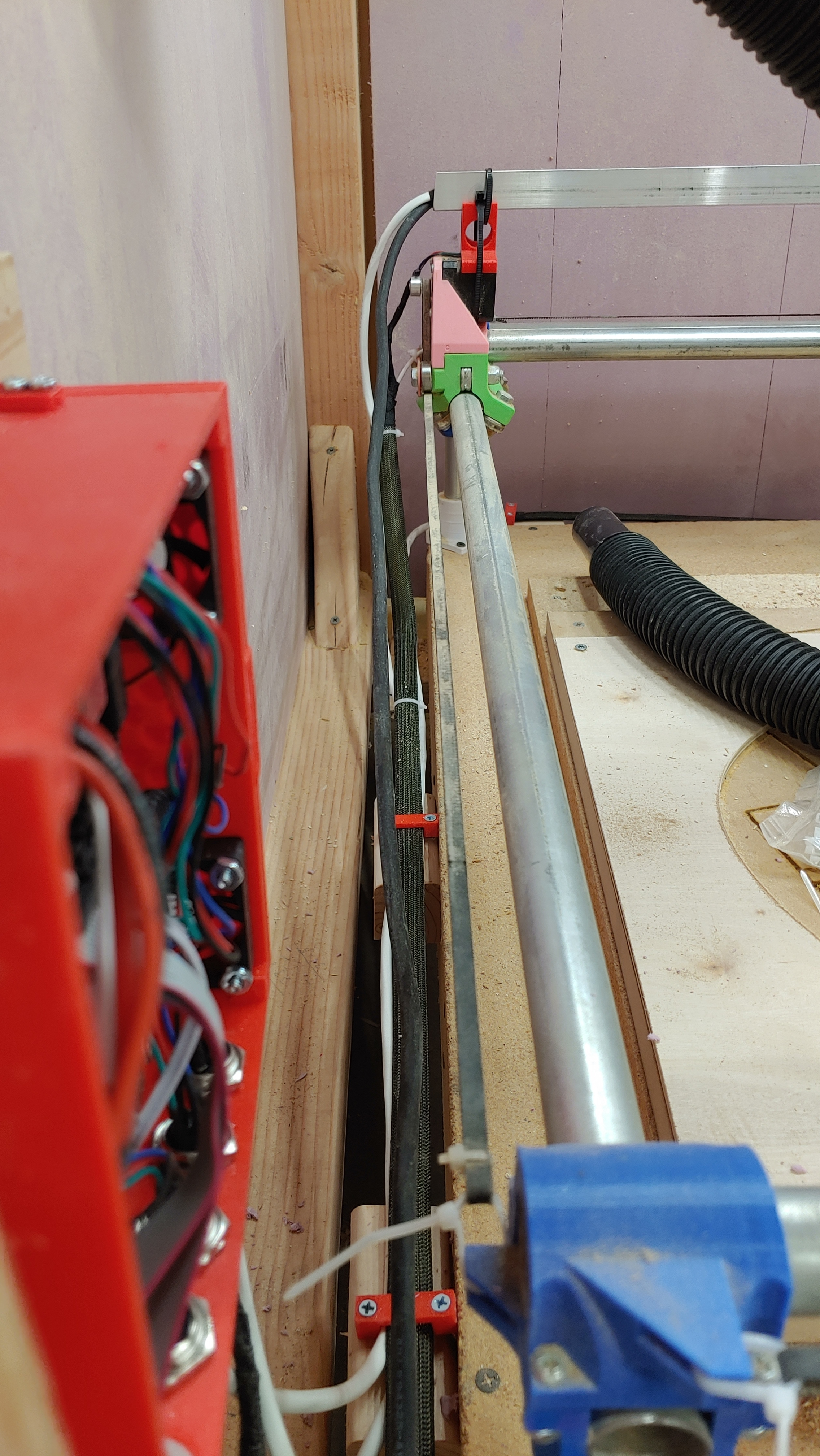

Ok. Picture…
Next up on the list of things to change… The Y axis cable is currently coming out of the front of the machine. I want to re-route that out the back and around the edge. Then I want to do the tape measure trick on the X and Y axis. I bought all the materials to sleeve everything.

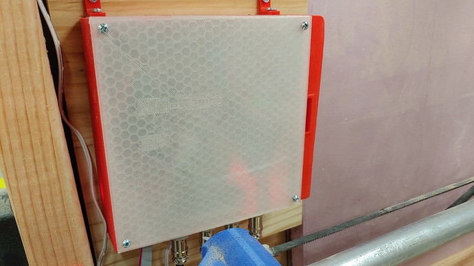

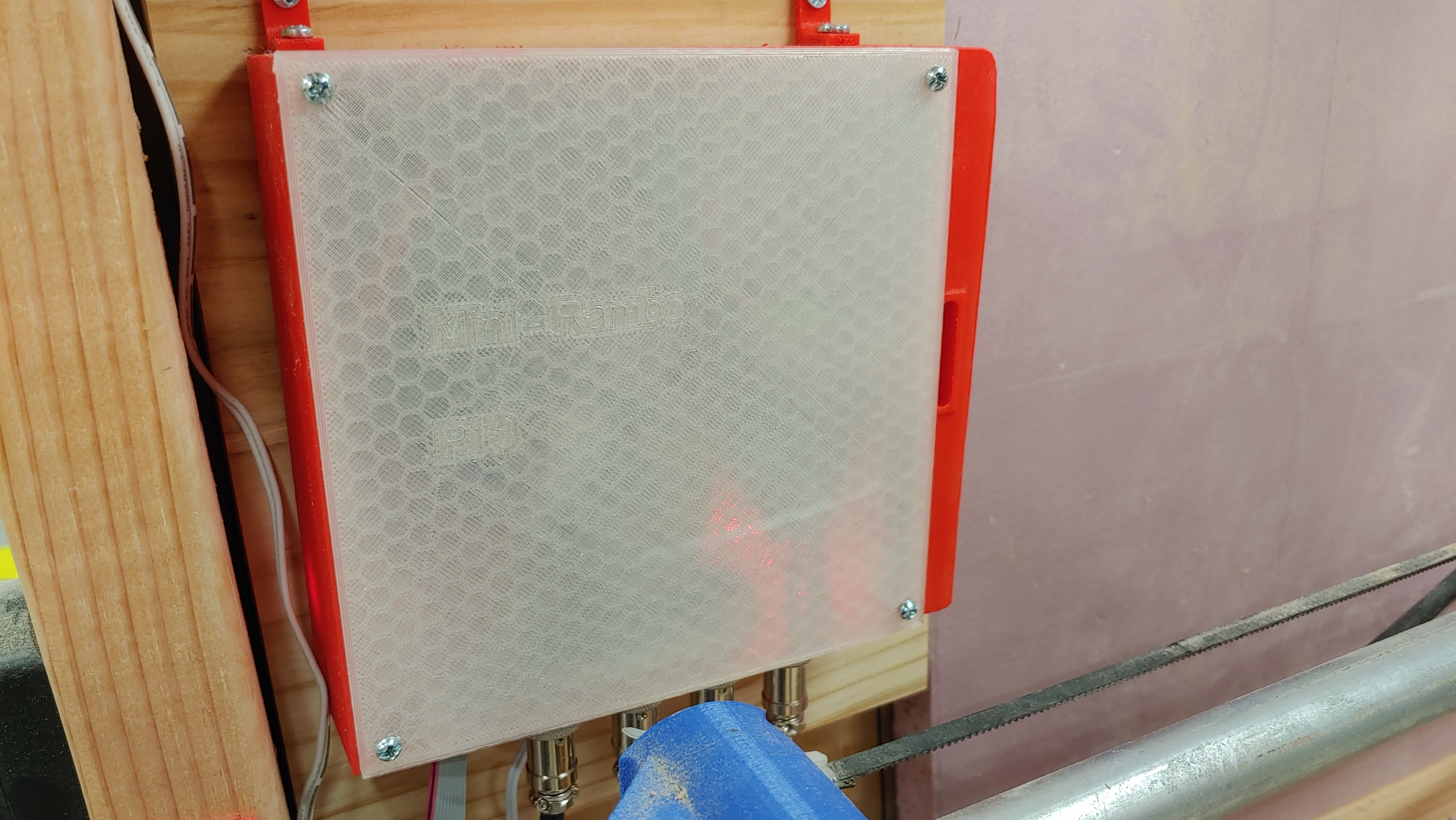

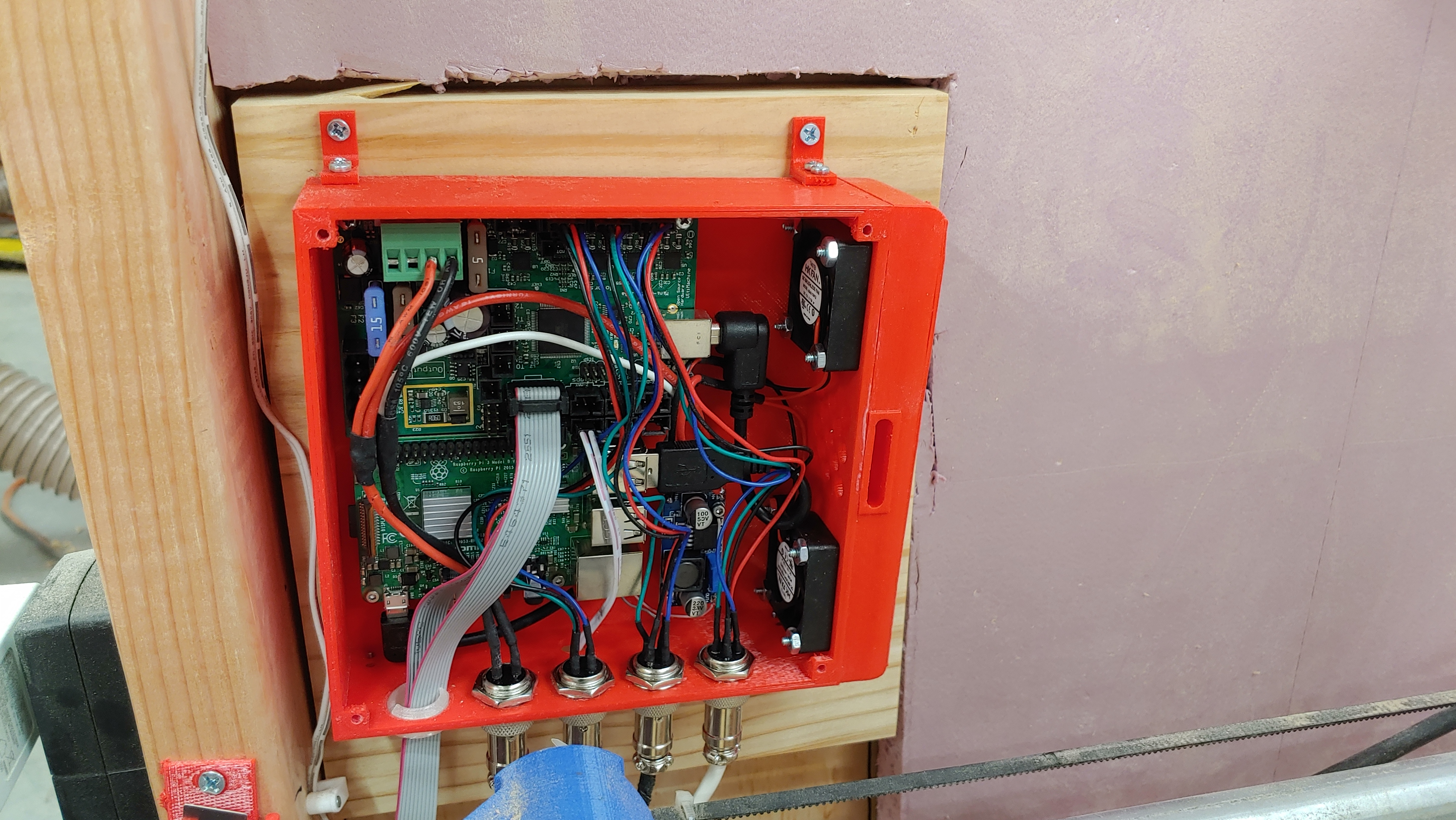

And I want to mount the Controller to the inside wall on the left hand side.
Finally, I want to 3d mount a bracket for the LCD and the touch plate to hang from when not in use.
All that requires me pulling the machine away from the wall and taking the back and side panel off. Luckily those are just screwed on.

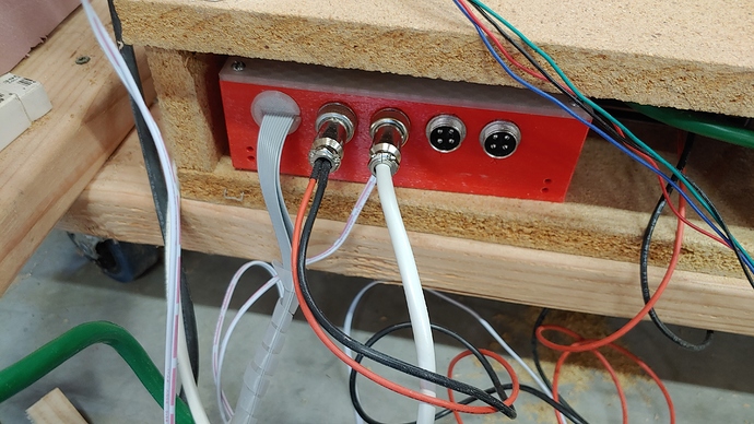

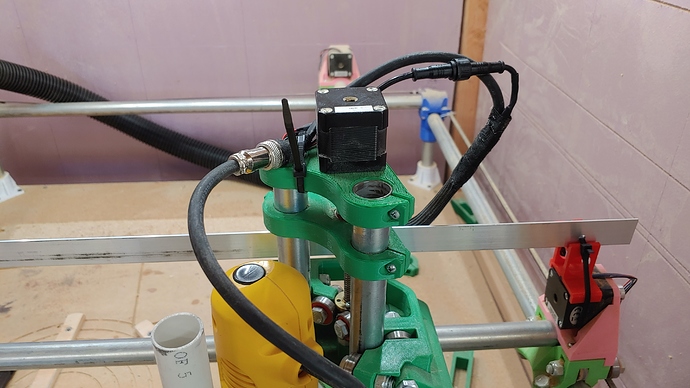

It doesn’t look like much, but it took me an hour or so to fully rewire the Z axis. I also took the time to cut the spindle’s power cable and run it through a connector. I can now undo two connectors and pull the entire Z assembly off.
BTW: make sure you unplug the spindle before cutting the cable… got a nice spark out of that one.

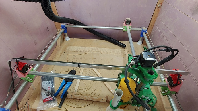

Finished adding cable management to the rest of the axis and got the controller mounted.
That looks great.
Oh. And you can see the new air duct I added to the right side. The fans draw air from holes on the bottom and the exhaust blows out the front.
What are those 4-pin adapters called that you have affixed to the case? Are those GX16-4?
Those are aircraft connectors. They have them with many different pin count. I have both 2-pin and 4 pin ones.
