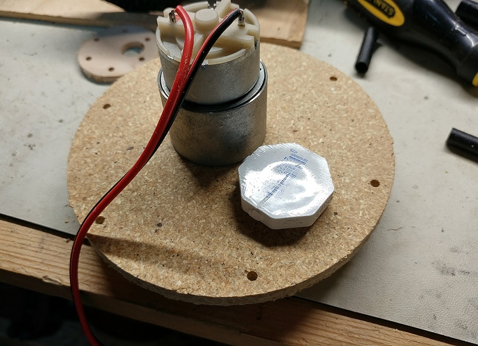

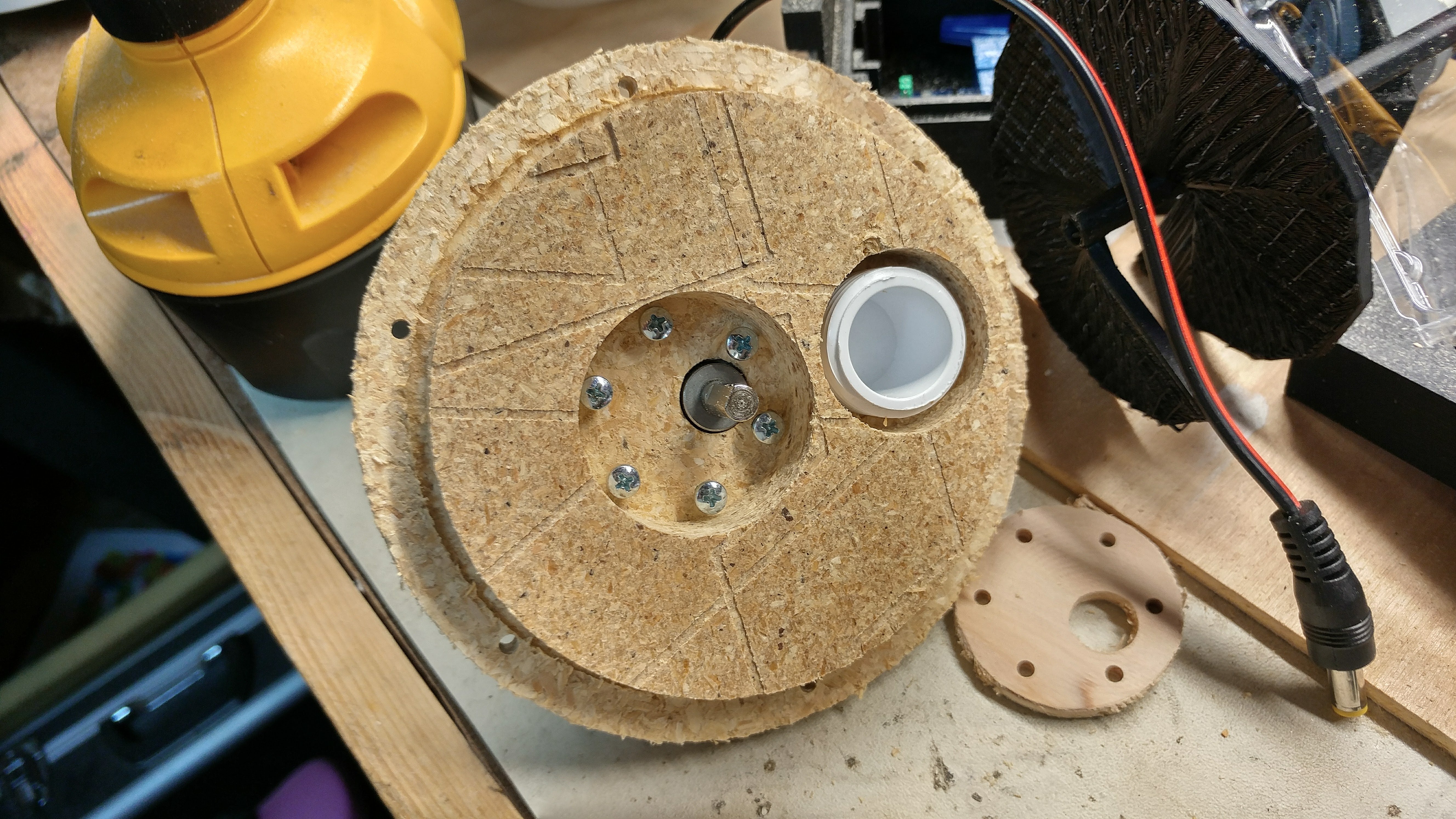

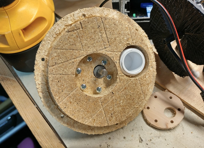

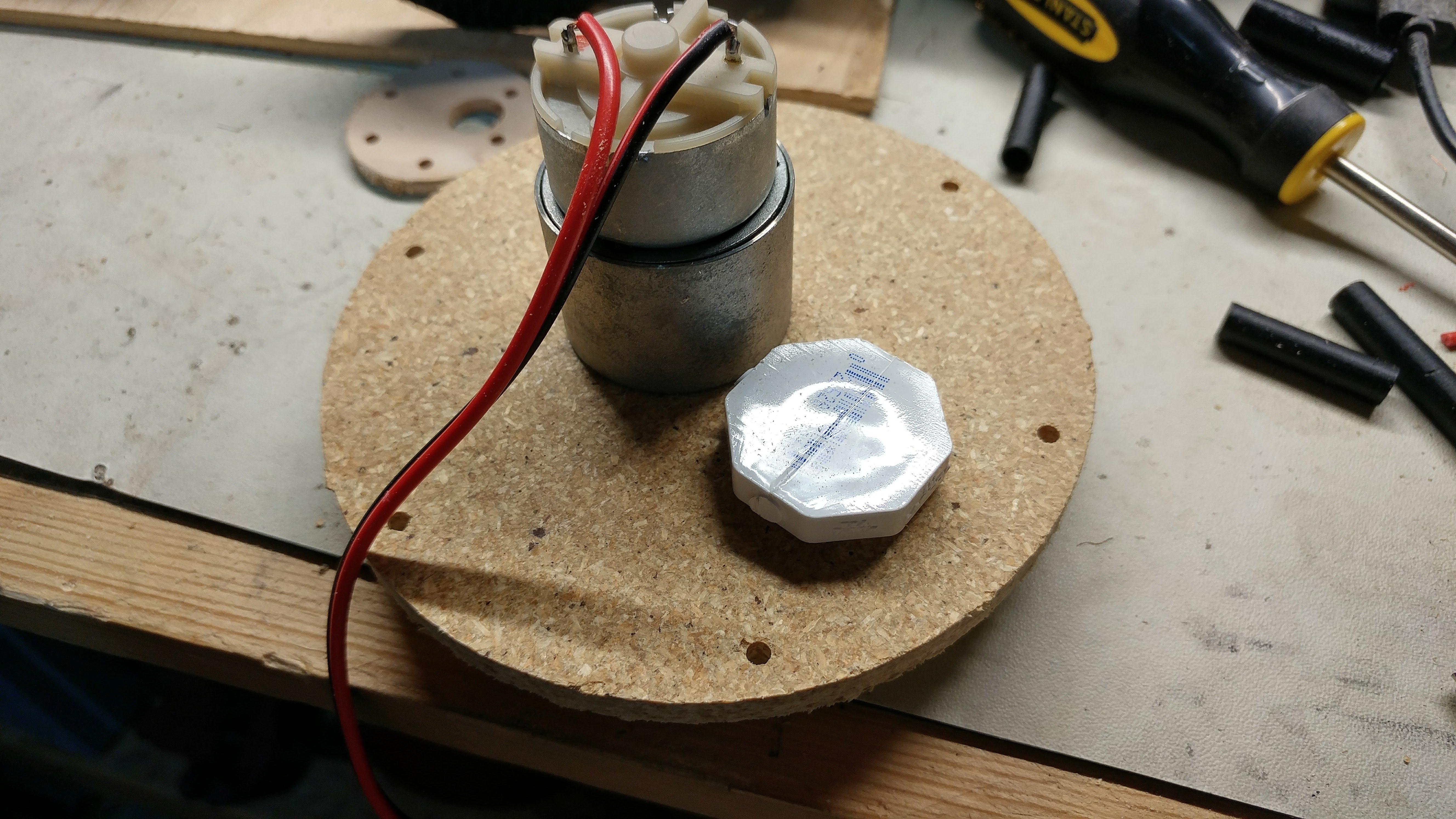

I finally have my first fully finished designed part for the Kalk Reactor. This will be the clean out lid. It has the electric motor mounted to it and a 3/4" NPT hole for adding more Kalk as needed. I changed my mind on trying to make it a screw on lid with milled threads and went with multiple M3 bolts to hold the lid on. It won’t be pressurized, so there shouldn’t be a need to seal it, but I can always add an o-ring or gasket if needed.
Ignore the random cuts in the top of the piece. I used scrap for the test pieces.
Now to finish finalizing the rest of the pieces.

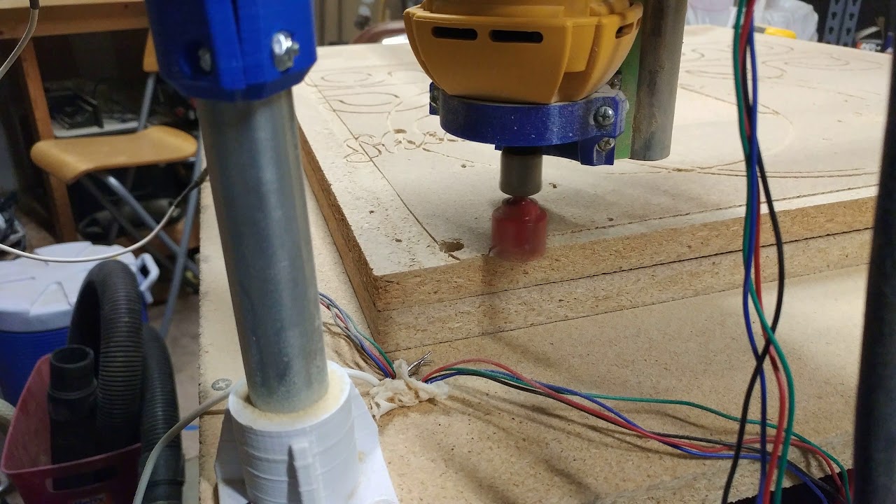

It’s been a while since I’ve spent some time with the CNC. I’ve always made recommendations on good ways to level a spoilboard, but I never did it myself :confused:
I finally got around to doing it this weekend. I used a 1" end mill running at 300mm/min. My 24"x24" board too 2hrs and 10 mins to fully surface.
I also noticed my Z isn’t perfectly perpendicular to the board. Never noticed this with the smaller bits, but the 1" end mill left a nice stair step in the Y axis.
