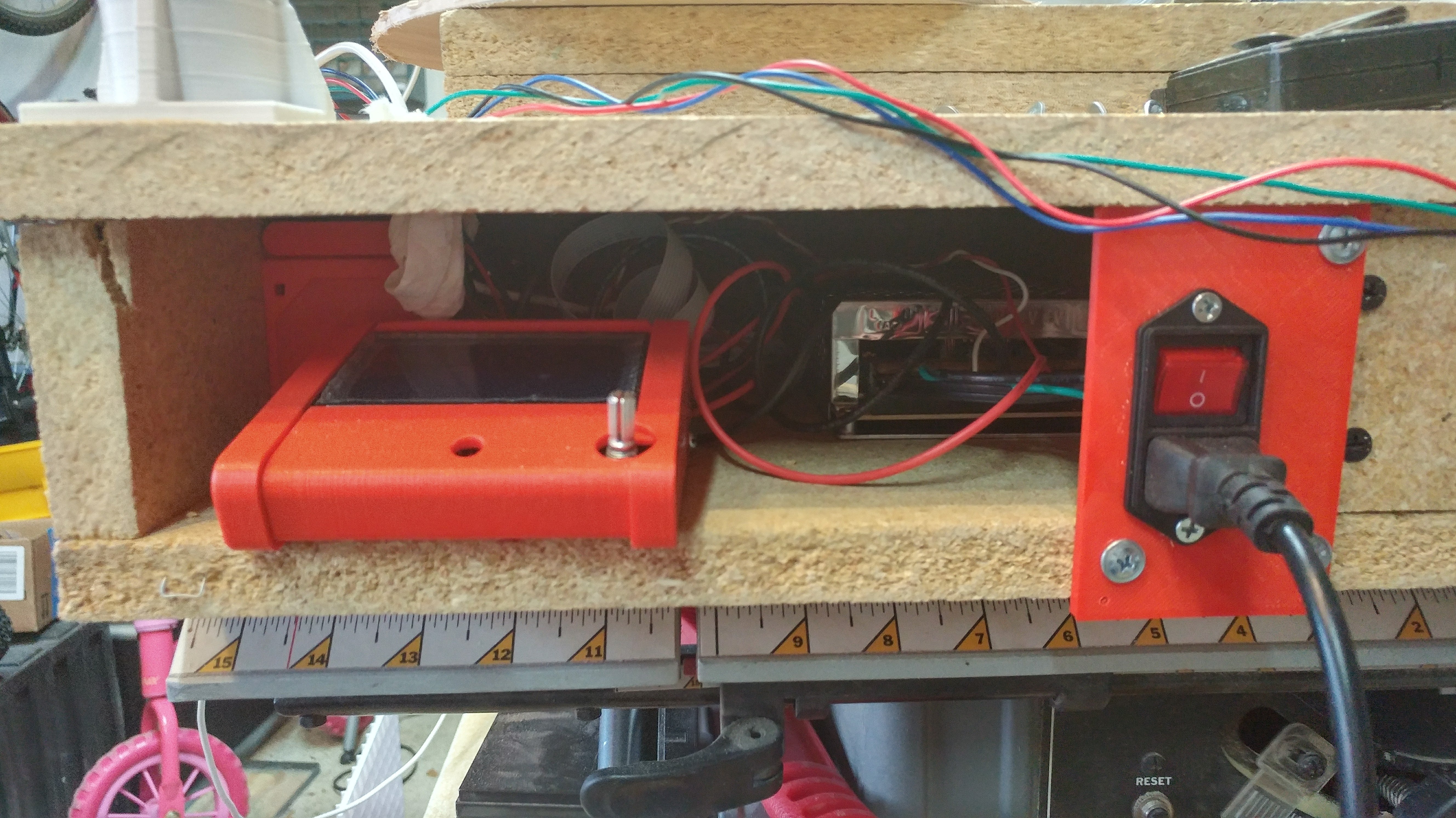

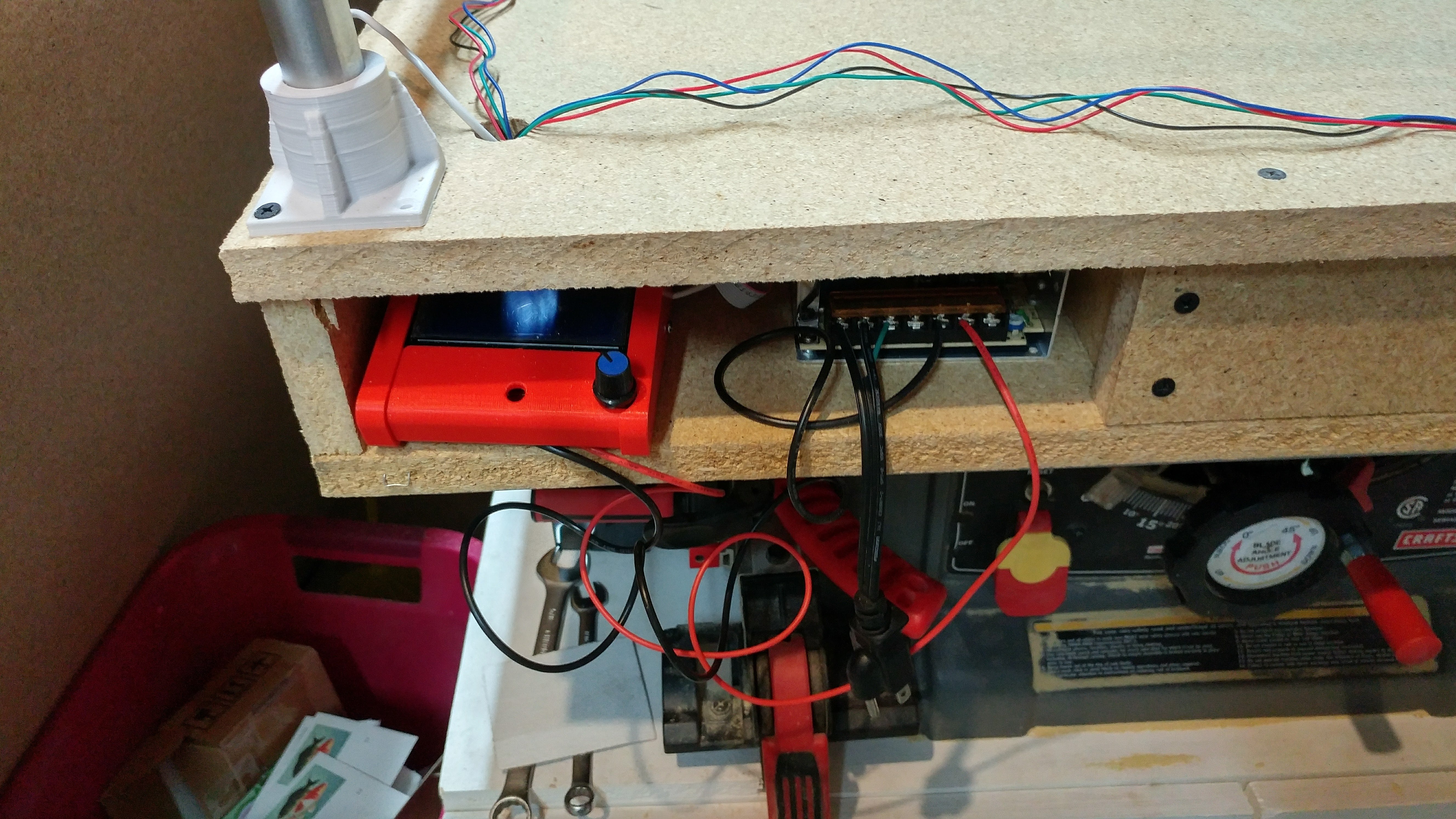

Pictures. When I made the torsion box, I left a panel off. There’s just enough room inside for the Ramps 1.4, power supply, and LCD. I’ll mount a power switch on it when it comes in. I also plan on putting a spoiler board on it (that’s why there’s so much height)
Looks sharp. Is that a table saw under there?

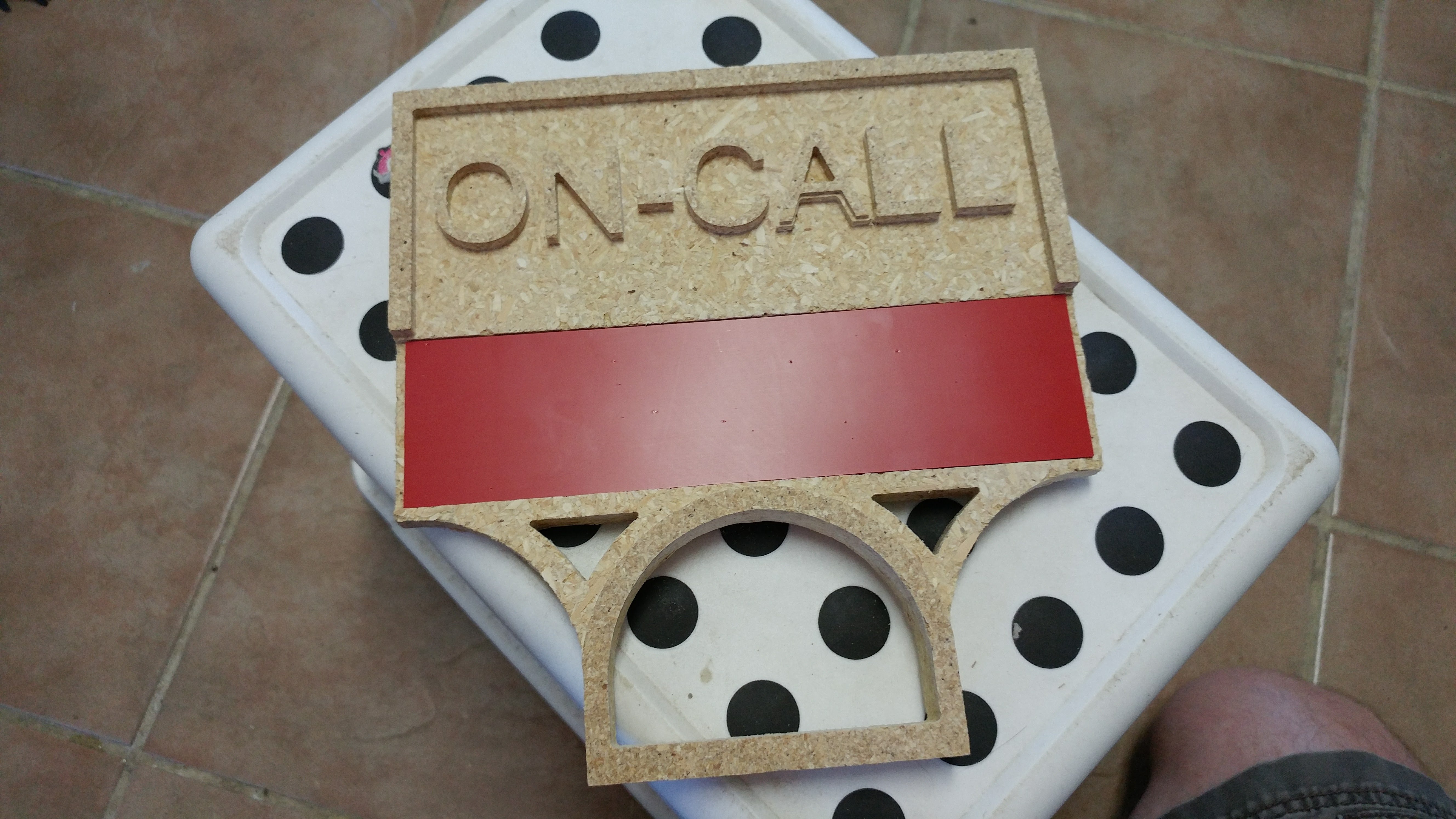

I did my first cut today that required a tool change.
I used spring clamps on the X and Y axis to set my 0 point. They worked really well.
The rough work was done with a 1/8" end mill, then I switched to a 1/16" to finish out the finer detail around the letters and the triangle-shaped holes.
Not sure why the 1/16" cut didn’t go all the way down around the letter A. Maybe I clicked the wrong path when creating the tool job in HSM.
Here’s what it will look like done, and the part I have cut out.
[attachment file=“On-CallRender.png”]
[attachment file=32985]
That looks super clean. I didn’t expect that kind of detail! Thanks for sharing.

I finally got my RAMPs board mounted in an enclosure. I gave up on trying to design one as I finally found one on ThingiVerse that fit my requirements.
I went with the dual 40mm fan version of this one
I can put the case on its side and it slides into the slot on my table perfectly. The dual fans provide more than enough air flow to keep the drivers cool.
