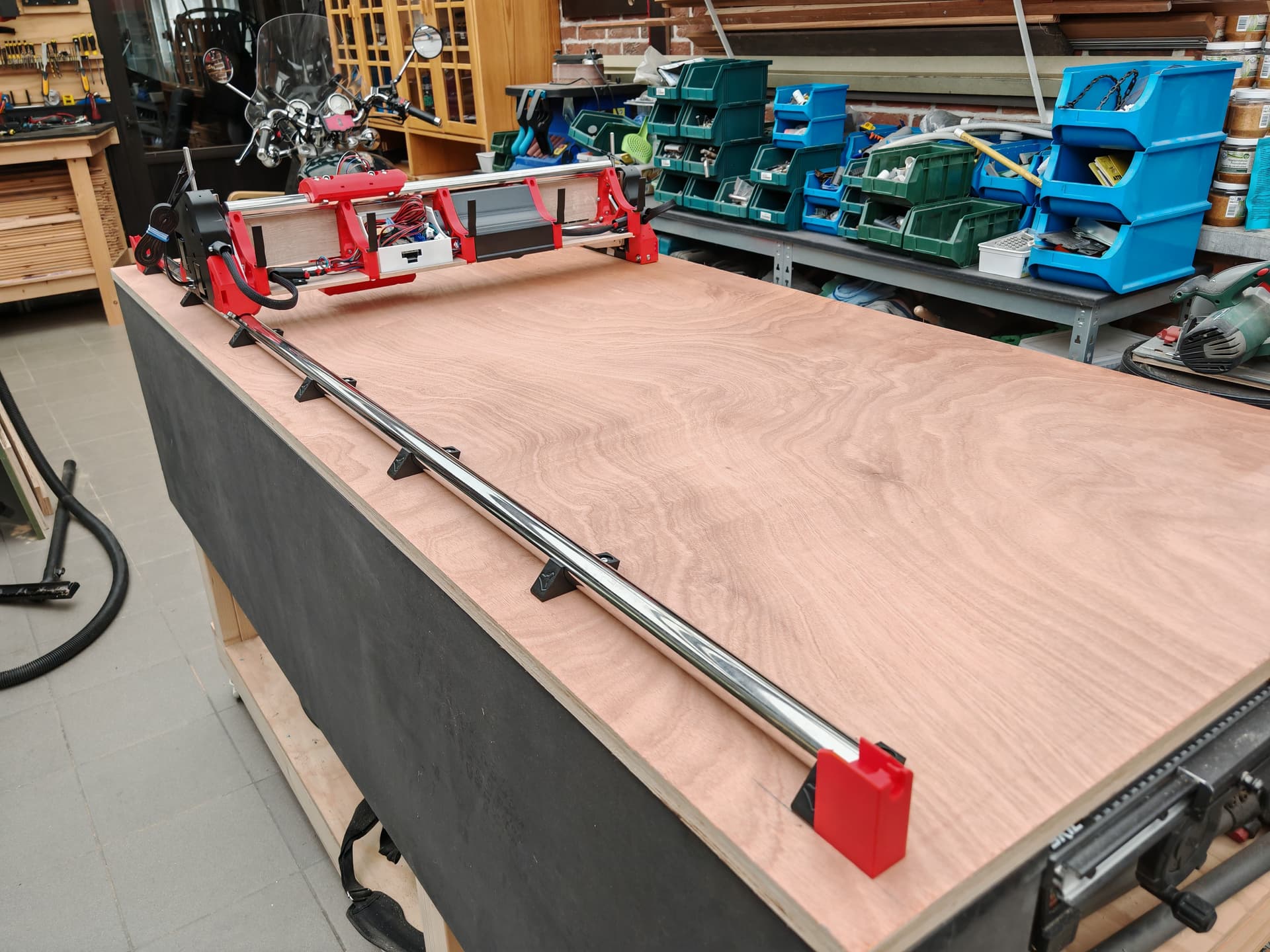

NEW BUILD greetings from BELGIUM
Hello Ryan,

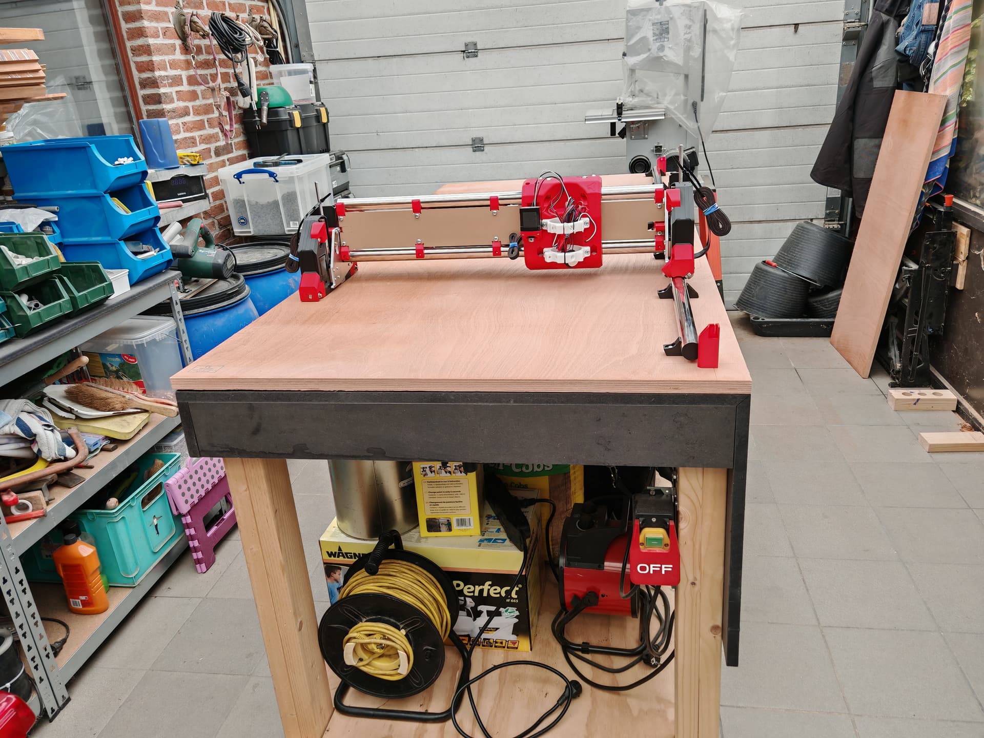

I don’t have much space in my workshop. The usable cutting area will be 548 mm x 1637 mm.
Thank you again for your exceptional work.

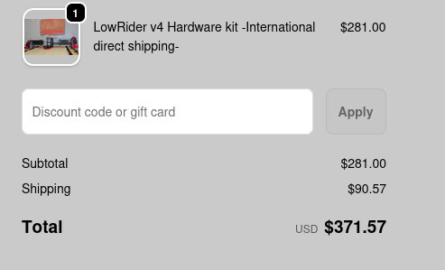

yes, but an additional 60% price goes to shipping and taxes. Maybe there were more efficient ways :).

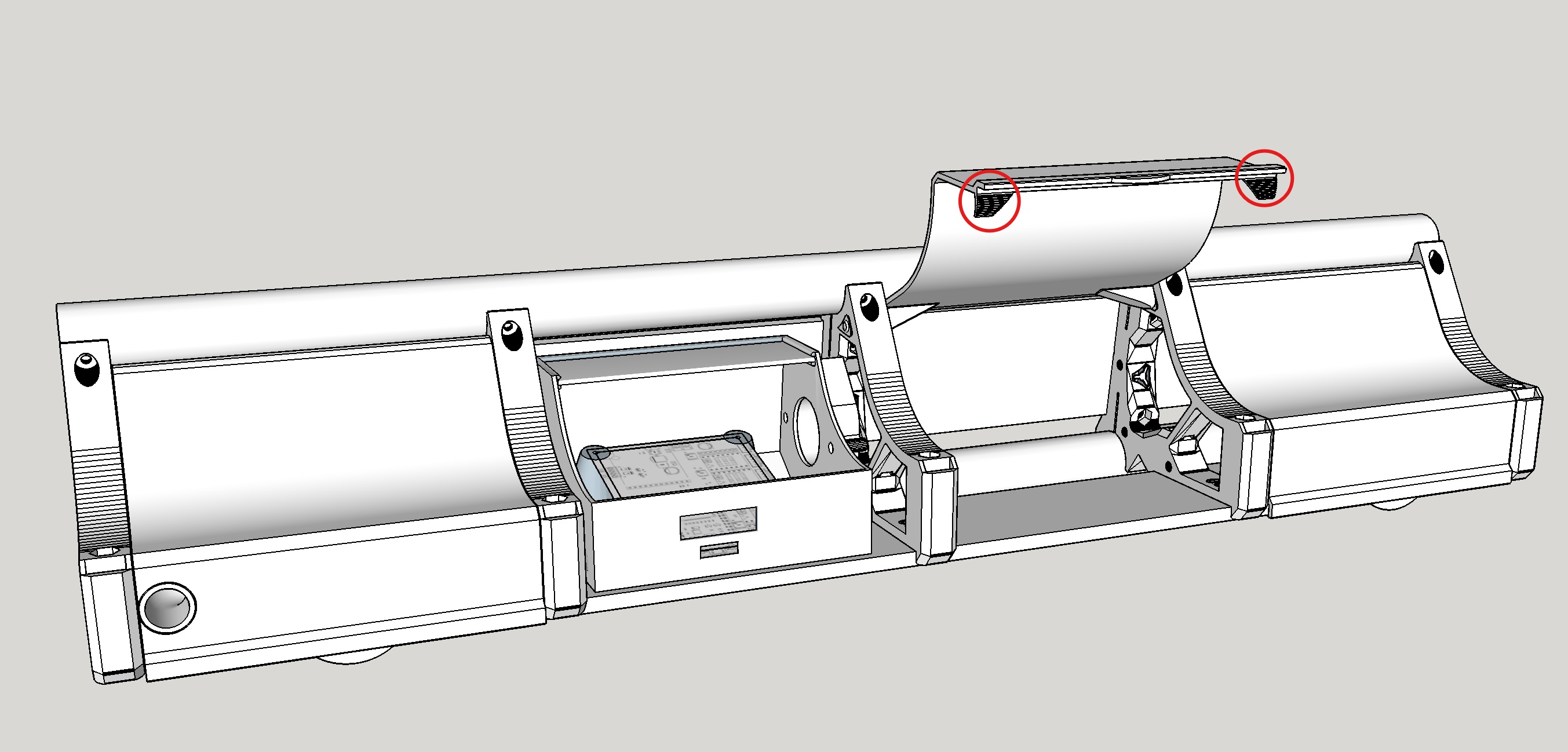

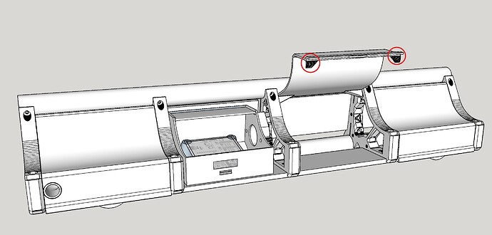

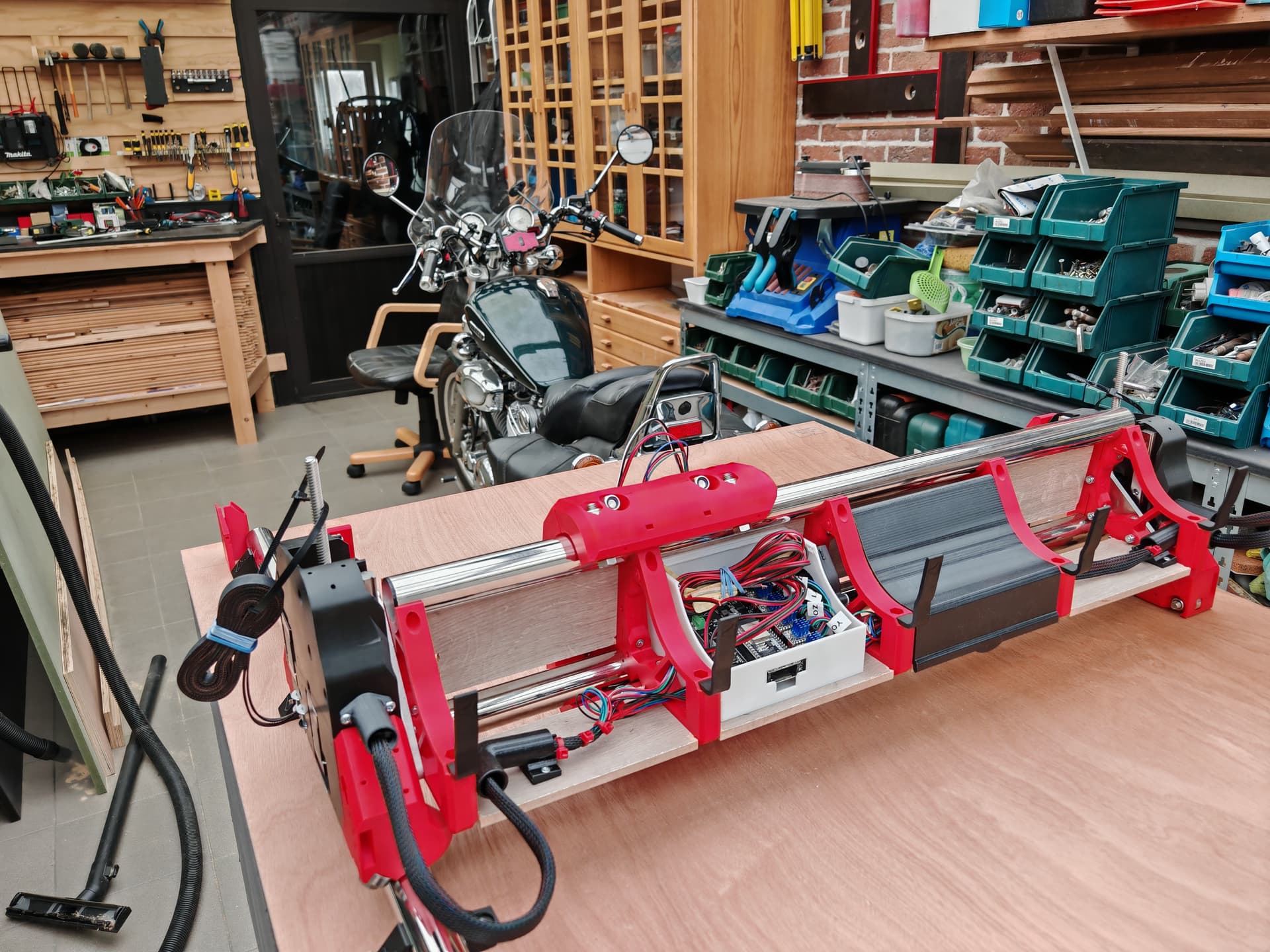

Some try out
If you cover your entire beam with those covers, be certain they are very loose, or they can very easily force the X rails into a curve fighting the lower strut plate. I love the look of them myself but I am very worried about not having a straight and true X axis.
Hi Ryan, Thank you for your advice. I’ll keep this in mind. The covers are indeed quite loose, and the teeth barely touch the lower strut plates, and the X-axis is also rather small. I’ll keep an eye on this. We’ll stay in touch. More to come…
I have a tig welding rod I think would make a good hinge/pivot for the covers but I haven’t had time to remix them to fit 32mm rails and have holes aligned to fill in parts for the braces.

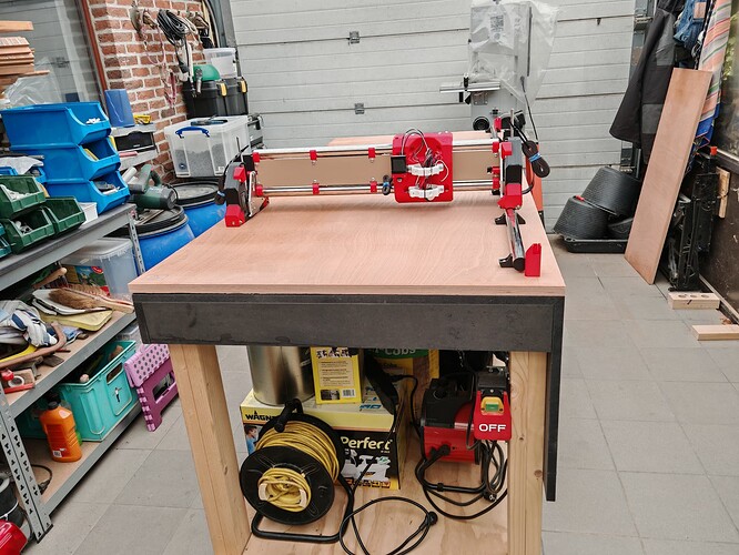

UNDER CONSTRUCTION ….
Very nice and clean build! BTW I am jealous of how neat your workspace is!!

It’s sent directly from China though, not the US. Not sure whether it’s DDP. :sweat_smile:
Currently, it is not DDP unless you want to message me directly and I can send an updated invoice for the difference.
I have been working on DDP for the last two weeks. I can have all not DDP, or all DDP, but I am not able to offer a choice.
