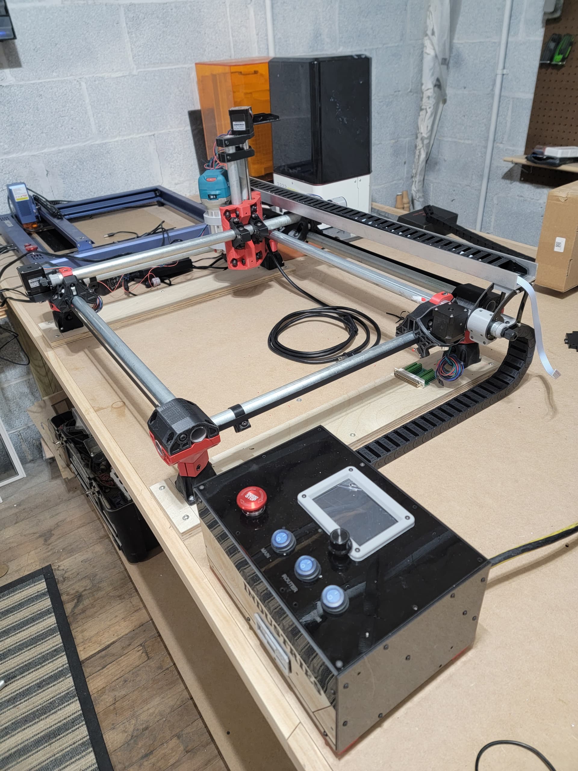

Been a lurker for years and finally decided to take the plunge. Over the holidays, I printed out the parts for the Primo. I am also working on my own version of the control box.
Goal is to control the Primo, be able to turn the Dust Collection and Router on and off from the board and have an E-Stop.
I have laser cut the acrylic sheets for the box and printed the connection pieces. (I do not like the tabs and slots you see on laser cut boxes).
Anyway, as I progress, I will post progress. I ask that if anyone sees anything that will cause me issues later, please let me know.

So it looks like you’re using a DB37 for all your cables coming into the box. I guess you’re going to have an octopus cable going to the machine? I’d like to see how that turns out when you’re done.

I am using the 37 pin connector. I am still working on cable management and how I want that to work. I do plan on using drag chain. I will post more as I go along. I will need to get the power to the router, so I am worried about interference.

Worked out the design for my drag chain. I will add it to Thingiverse if anyone would like to use it. But, I am still waiting on the aluminum to deliver (tomorrow) and will post it all as soon as I get that installed.
The chain for the Z is made from 3mm Acrylic laser cut and the plug in the EMT is a split bushing and a draw cone inside to hold it fast.
I made the x rail 200mm longer and the y rail 100mm longer to accommodate this design

Looks interesting, the recommendation is to not fasten anything to the Z-Axis though. There are a few models that circumvent this.
Well, the control box works. Tons of wiring done. I’m going to recut the front to accomodate the ESP board.

Box works as follows
Estop drives a 20a contactor.
24v PS drives the board and switches to the 10a relays for the router and future dust collection.
Steppers and stops are wired to the 37 pin connector. Had to use a heat gun to mold the wires. They are pvc coated and stiff as a board.

Minor progress. Waiting on a hardware replenish to finish drag chains, but belts are done, box is done except programming the ESP Wifi. Z and Y drag chain installed. X is being stretched and flattened in the background. Now i have to wire up the steppers and stops.
If y’all see anything wrong, please let me know.

Well, here she is. If yall see something janky, please let me know. Going to draw a crown now.
Wiring was all from scratch, 20awg silicone with those crimps. I made the wiring harness extension to handle the bundle of wires going into the box. I also used this for the out to the z probe plug. Made up the pendant and it seems to work as its supposed to.
Router power is in the box as well. So will dust collection.
Bout as good as im gonna do as far as cable management, but it seems to be okay and doesnt look like a birdsnest.
