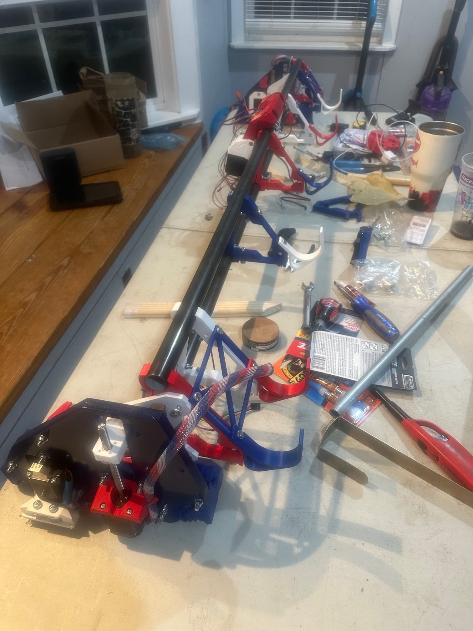

New 2 CNC start* LR3 build
Cool little side note.
If you are too lazy to walk to the shop and get a real one the temp braces can be used as a square to make sure the braces are straight and square. I know I know this is temporary until the final braces go on but if you dont start square no way to finish square.
Core installed. Hint the core slides on from either side. I didnt really see anything in the assembly instructions about how to get the core on so I took the bottom bearings off installed the core and put them back on. It may be there I just didnt see it and looked more than twice for specific instructions on how to install it. Found out how it goes on when I lifted the beam to check some screws and the daggum thing slid right off. Well Ill be a son of a gun!!
Side assemblies installed, but not tightened yet. Enough for tonight. will tighten and continue later.
Getting really nervous about the point I am at. The final wiring and installing electronics scares me to death, never tackled this in depth control boards and such but here we go. Get ready Jeff and Ryan and who ever else will listen. I feel a lot of leaning on your shoulders coming in the very near future!!
You can only do that with the beam off of the XZ plates. Once you bolt the beam in, those bottom 2 bearings are the way to remove/install the core.
Just in case you (like me) let one of the M5 nuts thst hold the tool mount fall out of the core, and can’t get past the strut plate to put it back.
Yep you are correct but in the assembly instructions it really doesn’t elaborate except to say install the core. It does talk about not overtightening the bearings and I still dont know what that is all about it doesn’t seem to make a difference when I put the two bottom close bearings back on. Course I really didn’t go cranking on them to see but it slides smooth, not clicking and doesn’t catch on the braces. Now i will have to be extra careful when I install the tool mount not to let the nuts fall out.

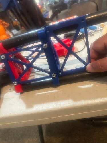

Well just found a problem I left a brace out should have been a total of 8. I know the assembly instructions say to not “snap” the braces in but does this create a problem if I only need to add one? Or should I just do it right and pull off a side assembly, end brace, temp strut support and add it? @vicious1, @jeffeb3
