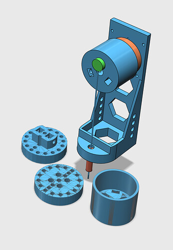

This post primarily focuses on the needle cutter, as the upgrade from LR3 to LR4 went very smoothly. I did encounter a minor issue with both the Y-axis pulleys slipping a few days apart, but nothing that a little Loctite couldn’t fix. But I digress!
For the needle cutter, I mostly used the @jhitesma design, with a few modifications to suit the hardware I had on hand. Specifically, I used a 1mm steel wire (cable support from a Voron build), motors from a drone, some old bearings, and an ESC with a knob to control the speed (ESC on Amazon). The rest of the components are 3D printed in ABS. The setup worked quite well, and I was able to cut out a FliteTest Storch plane in about 2 hours, broken up into 20-25 minute sessions to allow the needle to cool down.
The setup is powered by a 12V 920KV BLDC motor (Motor on Amazon) that spins a flywheel at around 4000 RPM. I used a feed rate of 300 mm/min, with the needle mounted about 7mm from the center. I would like to cut the process time in half i.e. push the machine closer to a 600 mm/min feed rate.
I’m looking for guidance on improving the performance of the needle cutter. Here are some thoughts I had:
  1. Motor Load and ESC Performance:
  • I’m using a 2212 920KV motor, and I’ve noticed that the motor slows down when it engages with the material (Dollar Tree foam board). Is this normal due to the increased load? The ESC throttles power when it reaches a temperature threshold, but it’s difficult to tell if I’m hitting that limit. Any recommendations for a better ESC or motor setup?
  1. Reducing Flywheel Moment of Inertia:
  • I’m considering reducing the moment of inertia of the flywheel by moving the bearing holding the needle closer to the center. The current motor shaft size is around 8mm, and with a radius of 4mm, the closest I could mount the needle was 7mm from the center. Since the foam board is only 5-6mm thick, I don’t really need 2x7mm (14mm) of travel. Is there a way to mount the needle closer to the center, or would it not help much even if I manage to do so?
  1. Bearing Size:
  • I’m currently using a 10mm OD bearing (Bearing on Amazon) for the needle. I have a suspicion that it is generating a lot of noise which can’t be good. Do you have any recommendations for a different size or a better alternative?
  1. Wire Thickness:
  • I’m using a 1mm thick steel wire, and I’m wondering if that’s causing too much friction with the MIG tip. The needle moves freely by hand, but might a thinner wire reduce friction and improve performance?
  1. Lubrication:
  • Would adding lubricant to the eccentric bearing or MIG tip help or hinder performance? This setup is high-speed rather than heavy-load, so I’m concerned that lubricant could introduce drag, especially given the small clearance in the guide. What are your thoughts?
  1. Heat Management:
  • The needle and sleeve heat up quite a bit during use. I’m considering soldering a metal plate to the MIG tip to help dissipate the heat. The plastic parts are insulated by the wooden block, but I’m not sure if this modification will help the performance.
  1. Needle Retraction:
  • I’ve read that the needle should fully retract inside the guide during the upstroke. Does this actually help in any way?
Let me know if you have any suggestions or advice on these points. Thanks in advance for your help!
That looks really good. I played with my foam ripper for a while and came to some conclusions.
I tried removing the guide bearings to reduce the friction on the wire but that caused excessive wear in the MIG tip. I tried a lighter flywheel and that did help
The problem is heat buildup so adding radiators should help, also spending time getting the flywheel balanced pays off. The wire size is pretty much dictated by the MIG nozzle.
I think lub will just get all over the workpiece.
Having the needle supported as it reverses direction would, I think, be a good thing so tuning your stroke to the workpiece might help but maybe too little clearance between the top of the workpiece and the tip at the top of the stroke might cause problems as the needle warms up and liquid foam sticks to it, it might depend on how rigidly the foam is held.
I could never find a set of grooved bearings. :slightly_frowning_face:
/my 2p worth.

I had a lot of heat issues with my first attempts at a needle cutter. The bearings were one step towards helping with that by guiding the wire before it gets into the tip so there was less friction in the tip.
Size of wire does make a difference - it needs to be a loose fit in the tip…but I would size the tip to the wire rather than the wire to the tip. It looks like I used 0.62mm/0.025" - so almost half the size of yours. The wire does flex and that does create heat - having thinner wire requires less work to flex so less heat and stress. I would definitely look at trying thinner wire (and possibly a different sized MIG tip too then)
I did see less heat with a inflation needle like used on soccer/basket/volley balls. But it also wore out very quickly due to how thin the needle material is.
I do use a few drops of light oil on mine - I actually stuff a bit of cotton ball into the top of the wooden insulator and put it on there. That helps quite a bit with heat and if you’re not too heavy handed with the oil it doesn’t make a mess.
The needle retracting all the way did also seem to make a difference - though I’m not entirely sure why. One theory is that it lets the needle pass more heat into the tip to be soaked away - vs. needle that never goes into the tip only gets air cooling.
The biggie for me was speed - just guessing the speed based on the motor KV and throttle proved highly problematic. ESC’s aren’t usually linear and without knowing the curve on their throttle it’s impossible to know what kind of RPM you’ll actually get at what speed setting. I picked up a cheap $15 optical tachometer and found I was running almost twice as fast as I thought I was - once I got the speed under control I had a lot fewer issues with heat and needle failure.
Once I had it dialed in I was able to cut continuously with no heat issues. I regularly would cut 2-3 planes worth of material (6-10 sheets of foam) back to back - just needing to occasionally add a drop of oil to the cotton ball and the MIG tip would get warm - but not so hot I couldn’t touch it.
All the bearings I used came out of old motors. With my flying “skills” and joy of experimentation I had a habit of bending shafts on motors rather quickly and wound up with a sizable pile of unusable motors I scavenged for bearings to use on other projects.
I can’t quite tell from your photos - but it looks like your MIG tip is mostly up inside the wooden insulator.
I think you may actually be using the same motor I did on my first cutter - with a crankshaft before I switched to the flywheel/bearing…I think it came from one of the early Flite Test power packs - note you can see the bit of cotton stuck into the top of the frame around the needle in this shot:
On the revized cutter I actually made that hole even larger to fit more cotton in there so I didn’t have to oil it quite as frequently:

Thanks, everyone, for your suggestions! After implementing them, the operation looks much more promising now.
Changes Made:
  • Switched to a thinner wire (0.025") along with the appropriate MIG tip.
  • Added a small well to hold cotton infused with mineral oil.
  • Reduced the gap between the final two bearings just before the wire enters the MIG guide.
  • Moved the needle rotation point closer to the center of the wheel (5.5mm), resulting in about 11mm of travel.
  • Resized the needle length so that it barely retracts into the MIG tip at its highest point.
  • Soldered a metal plate for better heat dissipation.
Results:
  • The needle remained cool throughout the 40-minute run, staying close to room temperature.
  • The rpm drop under load was significantly reduced—idle rpm was around 7600, and under load, it only dropped to ~7100. For some reason, when I tried touching 8000 rpm, the motor locked up. I suspect its the ESC.
  • I was able to increase the feed rate to 480 mm/min. At 600 mm/min, however, the needle broke after about 20 minutes, which requires further investigation.
  • There was a noticeable reduction in noise.
Overall, the performance has improved significantly, though there are still some aspects to refine.
