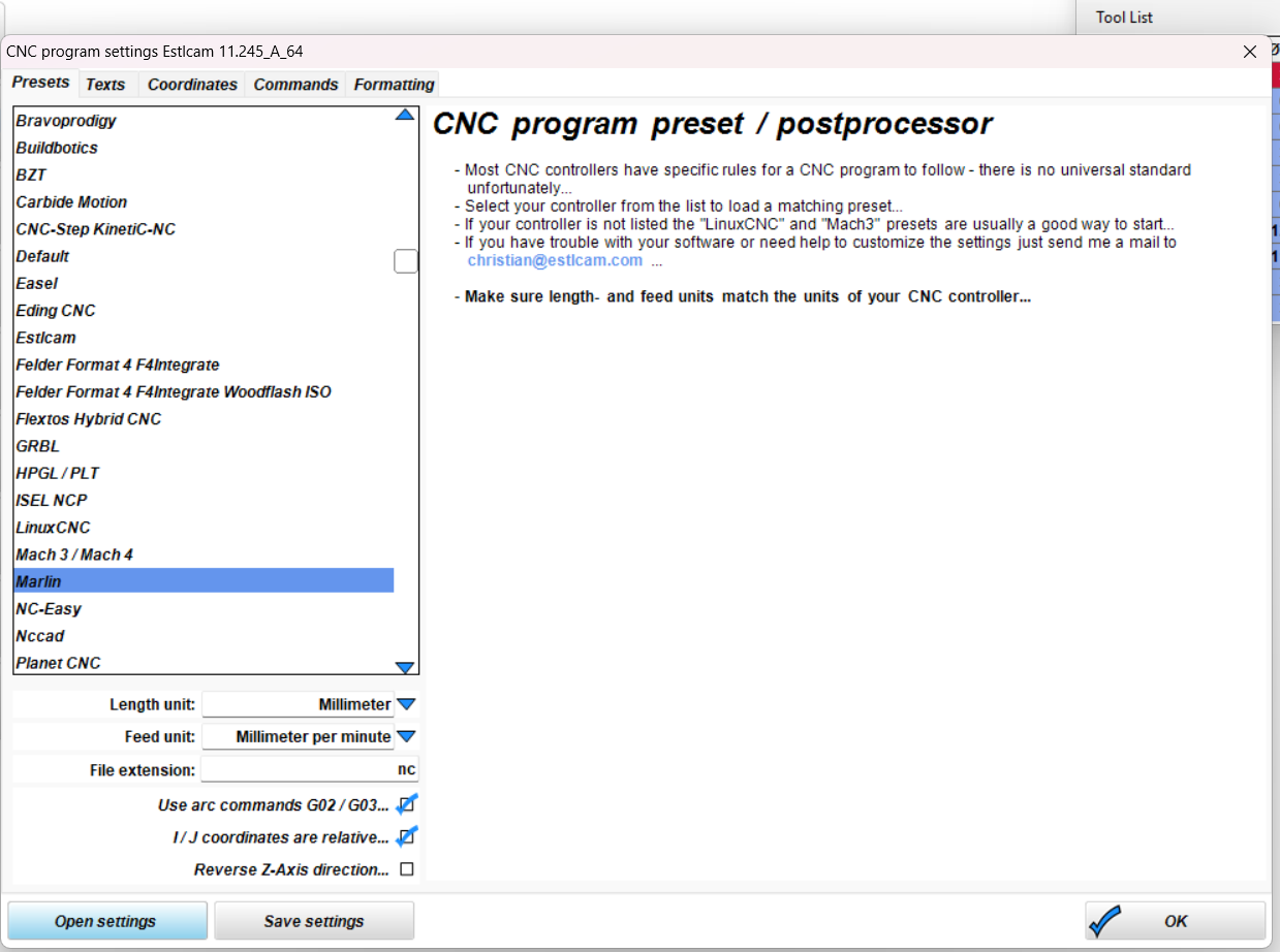

The problem I need to solve is my machine runs on a modified version of marlin. The 1st issue I’m seeing the the way the M3 code is defined in the firmware. In Marlin you turn on spindle with the M03 & M04. The code looks like this M03 S24000; setting to max speed. In the modified version it is turned on M03 P100; 100% of Power. I’ve noticed estlcam set the speed I’m guessing by RPM and I need it to come out from a scale of 1 - 100.
Has anyone has to make these kinds of changes to the post processor before?

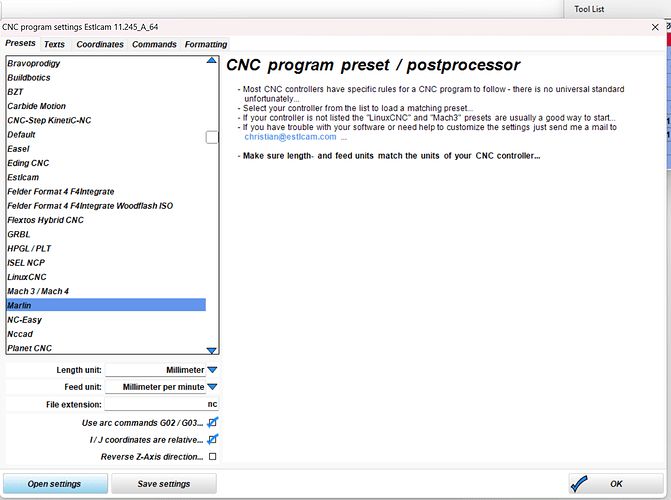

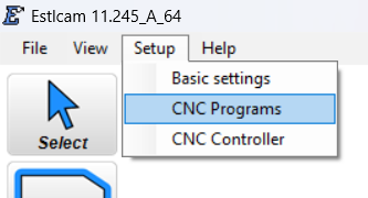

You can edit and save your own post processor in estlcam. I did it to run klipper. There is a page with functions sand commands that you can customize. It works.
It’s unclear to me what page you are talking about.

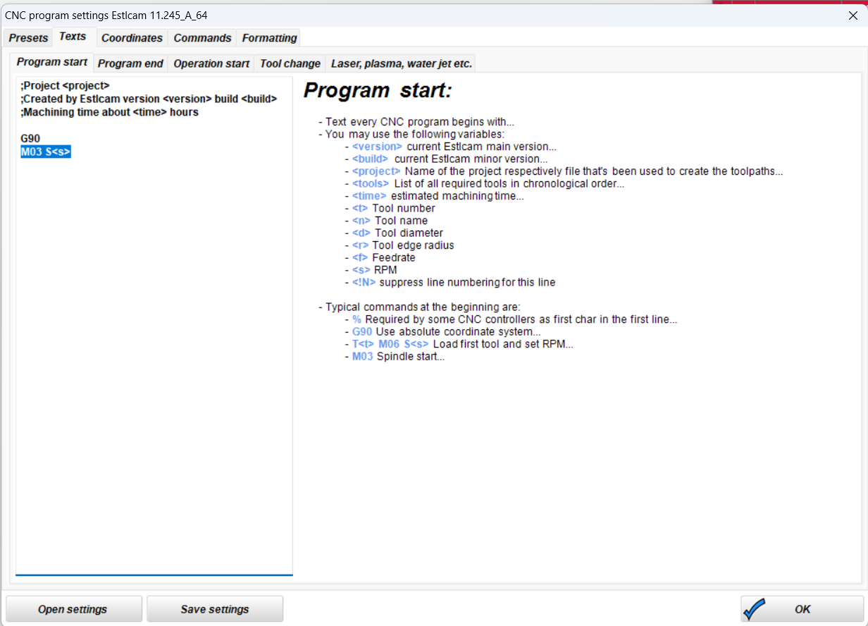

The page I was referring to has to do with motion in the commands tab above, but if you look at the text page:
the M03 is the command you seek I believe. You can change that to whatever you want.
Sort of. I don’t see a variable for percentage. You can change that line to M03 P<s>, but then you need to make sure the RPMs in the tool settings are always between 1-100.

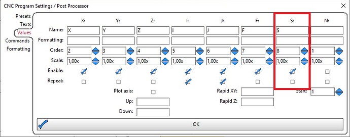

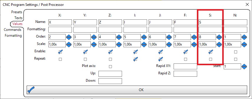

You can change the “Scale” of the “S” / “RPM” value.
If your spindle is running e.g. 20000rpm max you can enter 100/20000 = 0.005 as scale factor and then it will output 100 for 20000rpm / 50 for 10000 rpm and so on.
(0,005 will rounded to 0.01 in the textbox - but Estlcam will still use 0.005 for all calculations)
