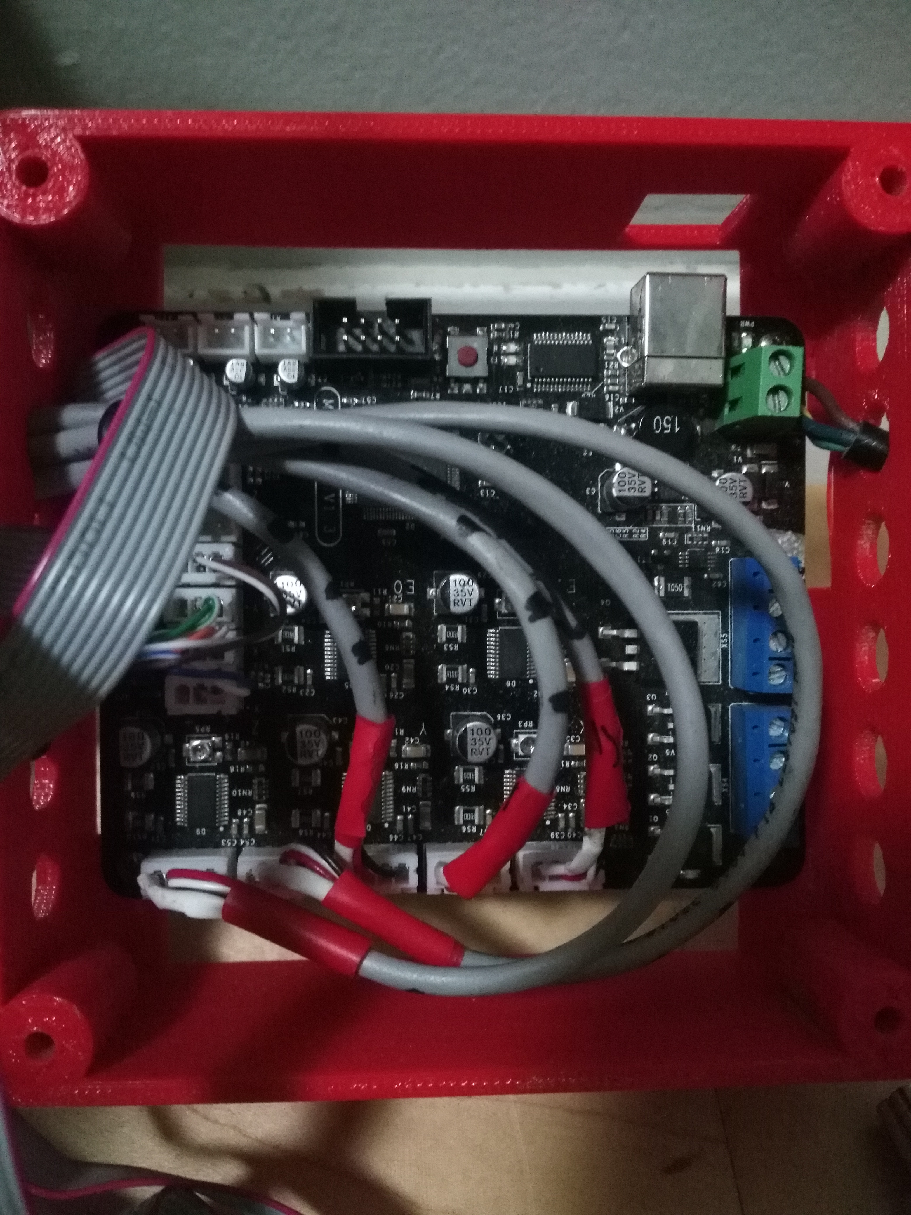

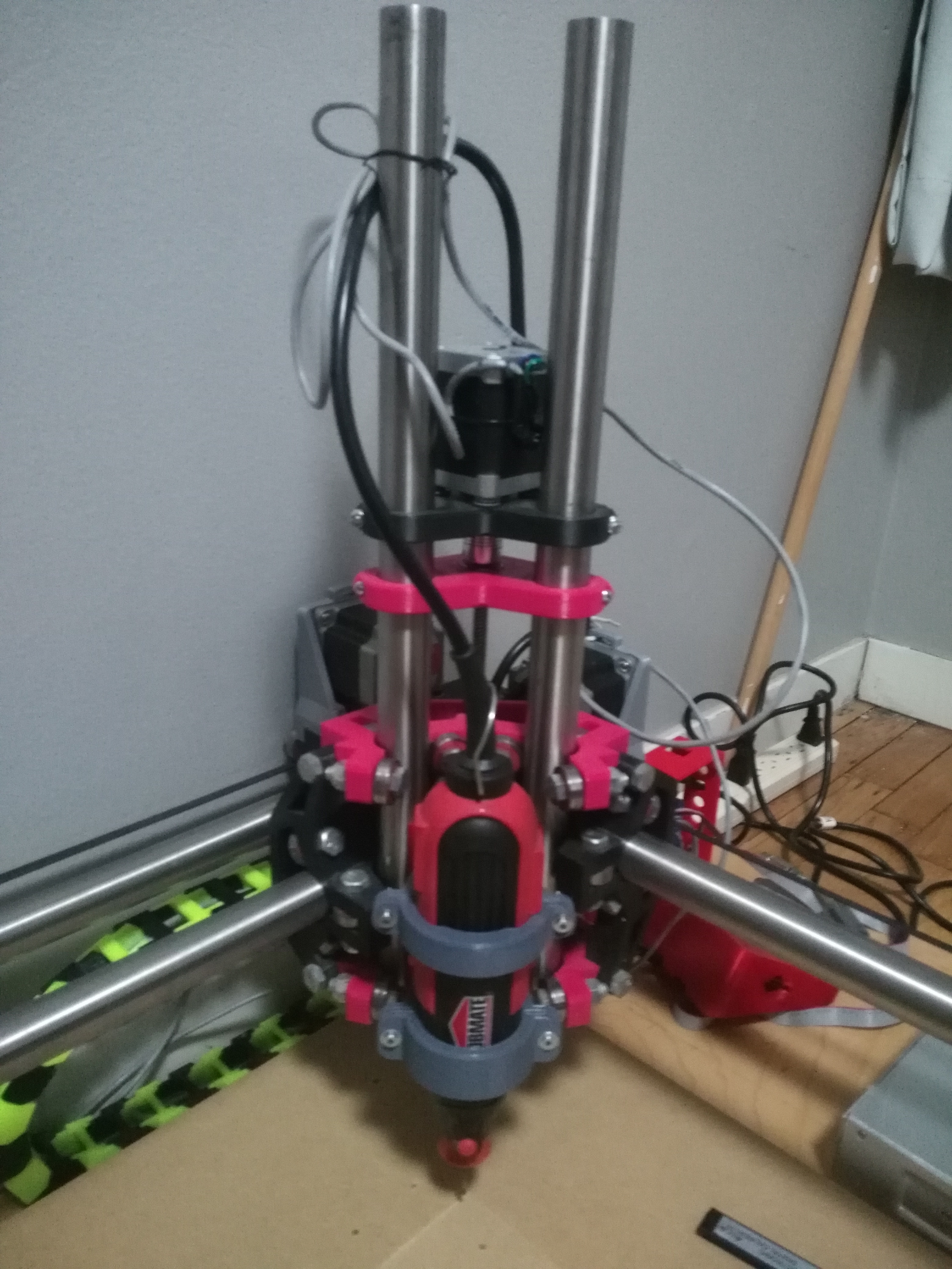

I aquired my mpcnc from someone and came with a MKS 1.3 controller with Marlin v1.1.9 and it has a pre-set limit for the z-axis to 20mm.
Is it possible for me to increase this limit in the firmware and if so how can I change this.

20mm length or 20mm/s?
You can’t easily change the machine size from gcode.
If your firmware actually has a pre-set limit on Z travel it will be here -
#define Z_MAX_POS 20
That is in Configuration.h around line 1105 (in the version I am looking at…YMMV)
You might be able to turn off the limit.
20mm lenght travel on the z-axis. I would like to go down lower for milling 3/4" MDF.
