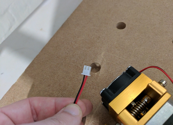

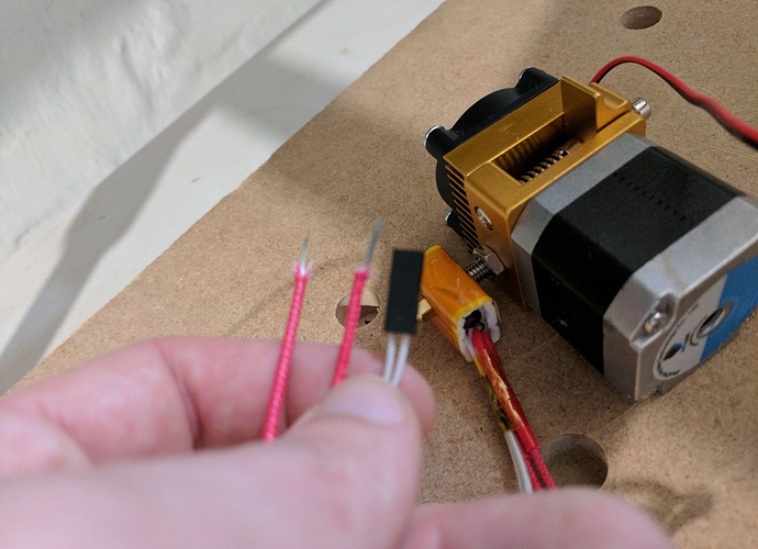

I’ve been looking at the MPCNC guide for how to wire it, but I’m a bit confused as my cables are different colours.
Could someone give me a bit of guidance? I appear to have a connector for the fan, two red and two white cables coming from the hot end (the white ones have a connector on them), and the servo cables.
It also came with two drive gears - a 26 teeth and a 40 teeth. Which is the correct one to use?
Many thanks!
The two small white wires are the hotend thermistor, the go to port T0 (where the resistor used to plug into).Polarity does not matter.
The two red wires go into the port D10, polarity does not matter.
The red and black are the heatsink fan and should be on at all times, usually we wire this to the power directly. Polarity does matter here red is positive. Not to be confused with a print fan that would wire into D9.
If you are using the old firmware you should be good to go, if you updated then you need to flash the extruder enabled one.
You will need to power both sides of the green plug as well.

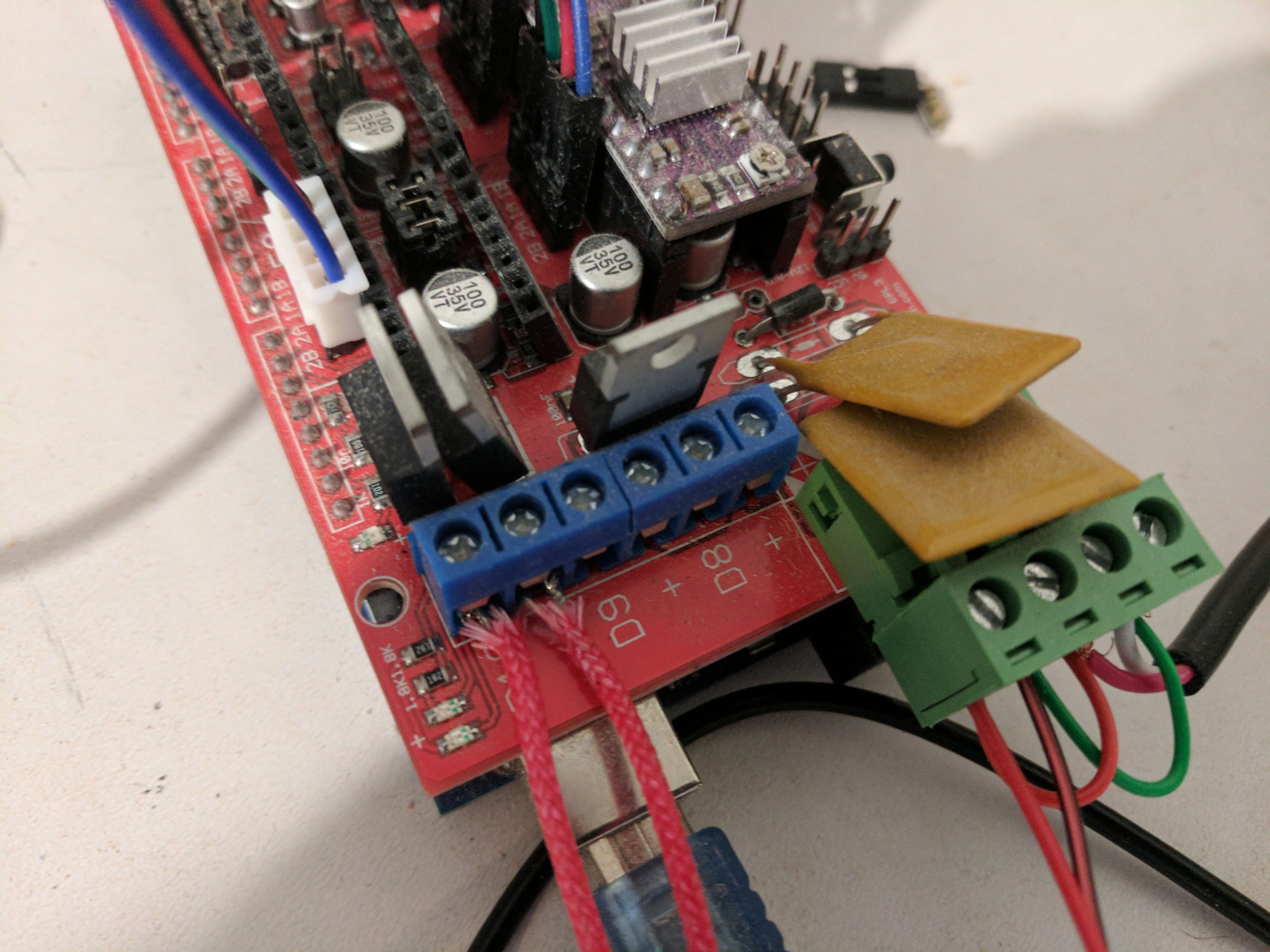

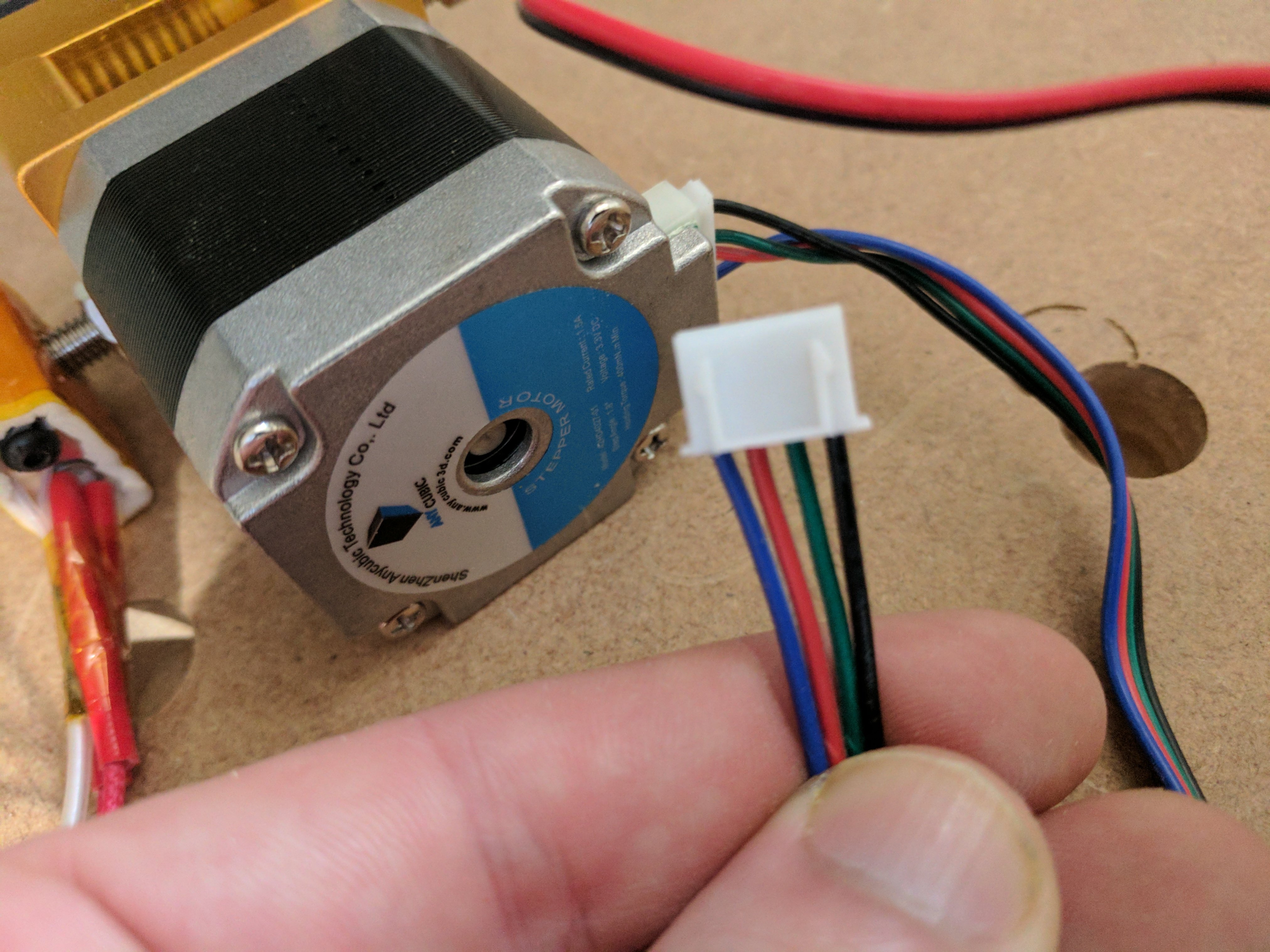

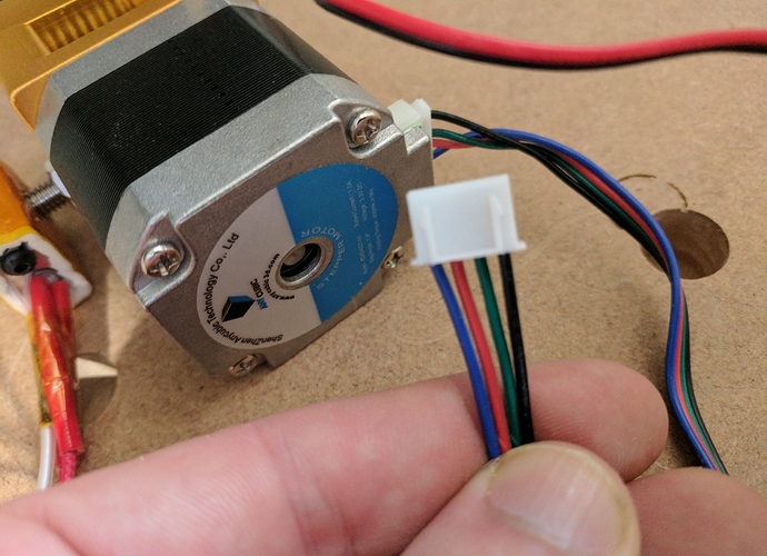

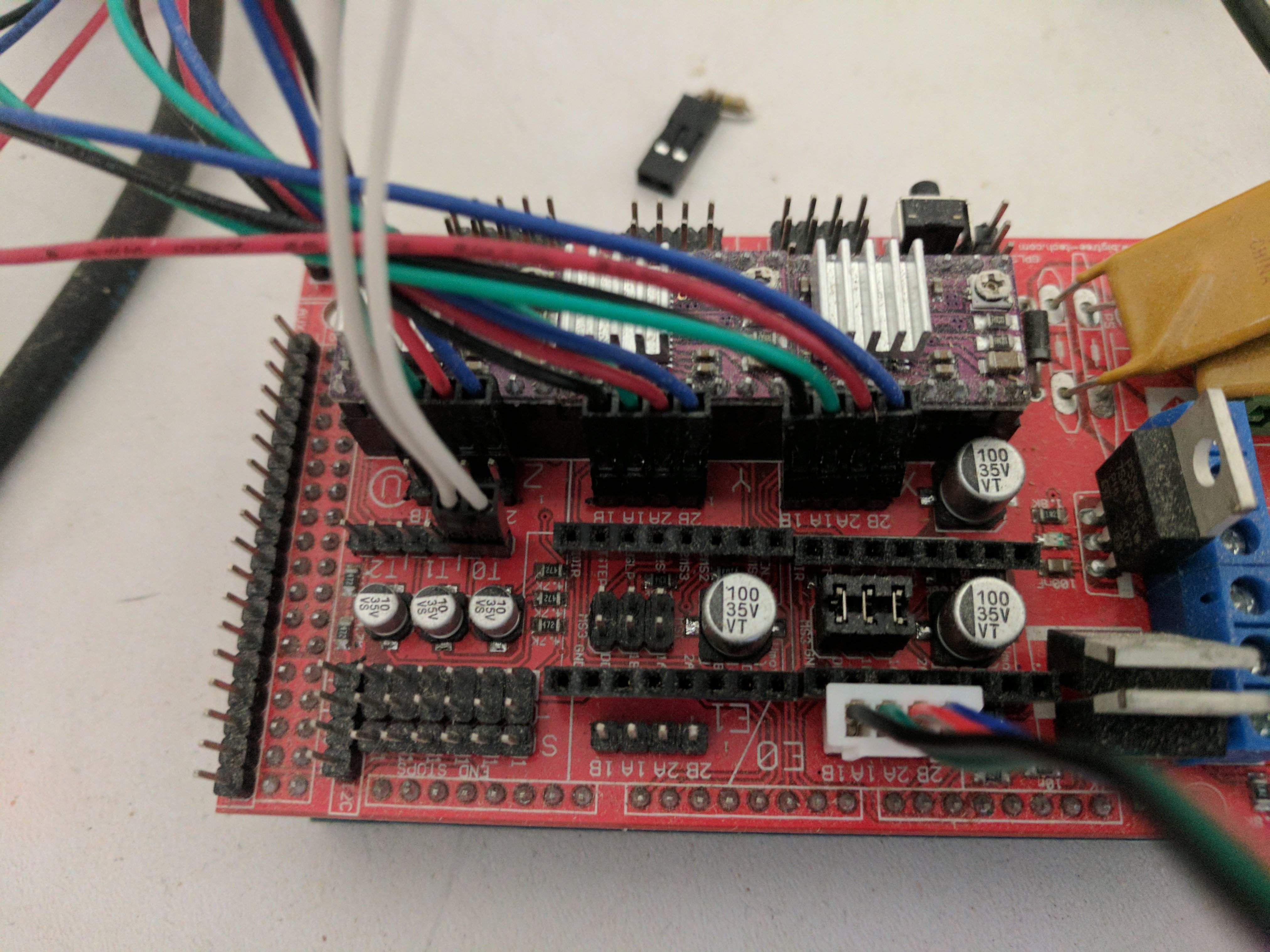

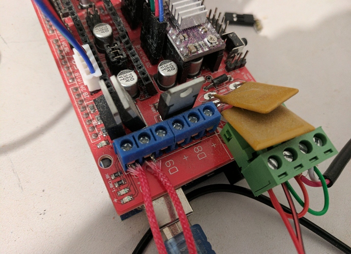

I think I’m wired up, but I’m unsure how to tell whether or not it has worked.
Can you see any obvious mistakes from my photos?
Is there a way for me to easily debug the situation?
Repetier-Host is logging “echo:Active Extruder: 0”
(Apologies, I’m new to 3d printing!)
You need a driver on the extruder axis but the rest looks okay. The wires on your green plug are a little frazzled fro me to be comfortable, you do not want to let the positive and negative touch, loosen up the screws, twist the ends and get them completely inside.
When you do put a driver on you will need to set the voltage first, before you try and move it.
You can start repetier/or check your lcd for the extruder temp, at room temp it should be 25C±5C and the heat sink fan should be on.
