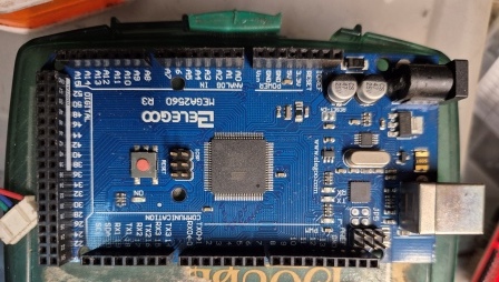

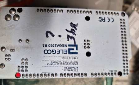

This is a revisit to an upgrade, got 2 in 2 Out Extruder 12V 40W Dual Color Cooling Chimera Hotend working somewhat. Both hotends heated on PLA preheat, only extruder 0 works off of Smart controller.

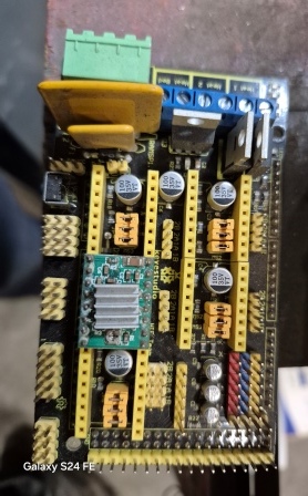

A Milled printer (V1 design) with RAMPS 1.4 for Arduino REPRAP Mendel PRUSA 2560 Board that I built in 2020 that I managed to get working with Marlin version at that time. , I need a complete download as if starting from ground 0, as config.H asking for files I don’t have. I’m in process of upgrading my printer to dual extruders single Hotend.
I got Marlin to recognize dual extruders, need to change coding on Reprap Smart Controller 12864 LCD Display to move extruders individually.
Did original programing with Arduino, kind of lost using Visual studio. Any help would be appreciated. Including coding I have been working on, base off “V13DP_Ramps_MK8”

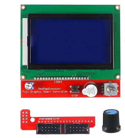

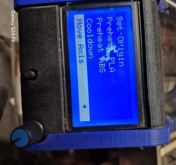

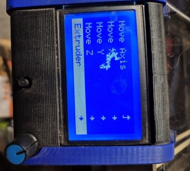

Have done that, but need help to change menu on LCD Graphic Smart Display Controller Board, that is on the printer. allows printing from SD card.
lcd controller
What do jou want to change
Need to change menu, see attached and add code for Extruder 0.
LCD
LCD1
Sorry, Extruder 1, Extruder 0 already there.
Found this in menu_motion.cpp
#if E_MANUAL
inline void _goto_menu_move_distance_e() {
ui.goto_screen({ _menu_move_distance(E_AXIS, { lcd_move_e(); }); });
inline void _menu_move_distance_e_maybe() {
if (thermalManager.tooColdToExtrude(active_extruder)) {
ui.goto_screen({
MenuItem_confirm::select_screen(
GET_TEXT_F(MSG_BUTTON_PROCEED), GET_TEXT_F(MSG_BACK),
_goto_menu_move_distance_e, nullptr,
GET_TEXT_F(MSG_HOTEND_TOO_COLD), (const char *)nullptr, F(“!”)
else
_goto_menu_move_distance_e();
#endif
Found this in old coding under ultralcd.cpp
static void lcd_move_menu_axis()
START_MENU();
MENU_ITEM(back, MSG_MOVE_AXIS, lcd_move_menu);
MENU_ITEM(submenu, “Move X”, lcd_move_x);
MENU_ITEM(submenu, “Move Y”, lcd_move_y);
if (move_menu_scale < 10.0)
MENU_ITEM(submenu, “Move Z”, lcd_move_z);
MENU_ITEM(submenu, “Extruder”, lcd_move_e);
END_MENU();
Not sure how it sends code to Driver E.
Would be nice to upgrade coding to “V1ZXY_Ramps-2.1.1” example under Visio Studio Code Version: 1.96.4 (user setup) Date: 2025-01-16T00:16:19.038Z

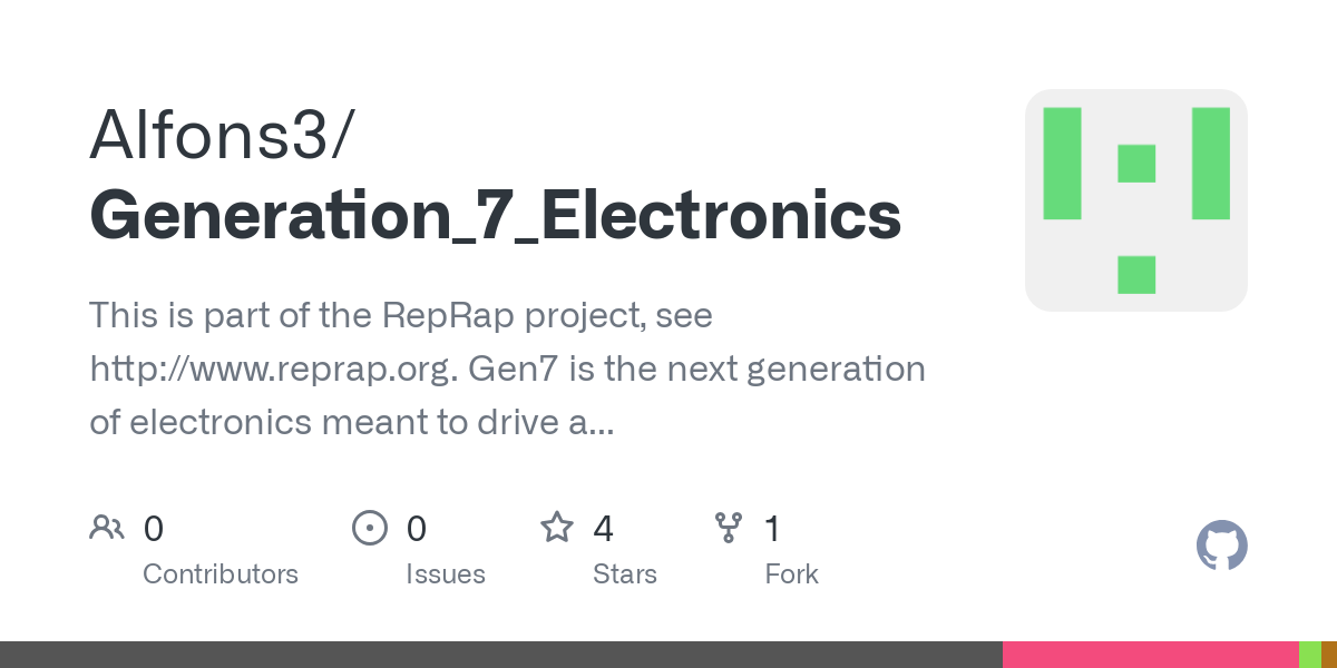

You use Ramps V1xxxx? search for BOARD_RAMPS_14 in the marlin software and change it to set it to 2 extruders (look in boards.h wich to choose) . That probably solve your problem.
the is a fork on github.
