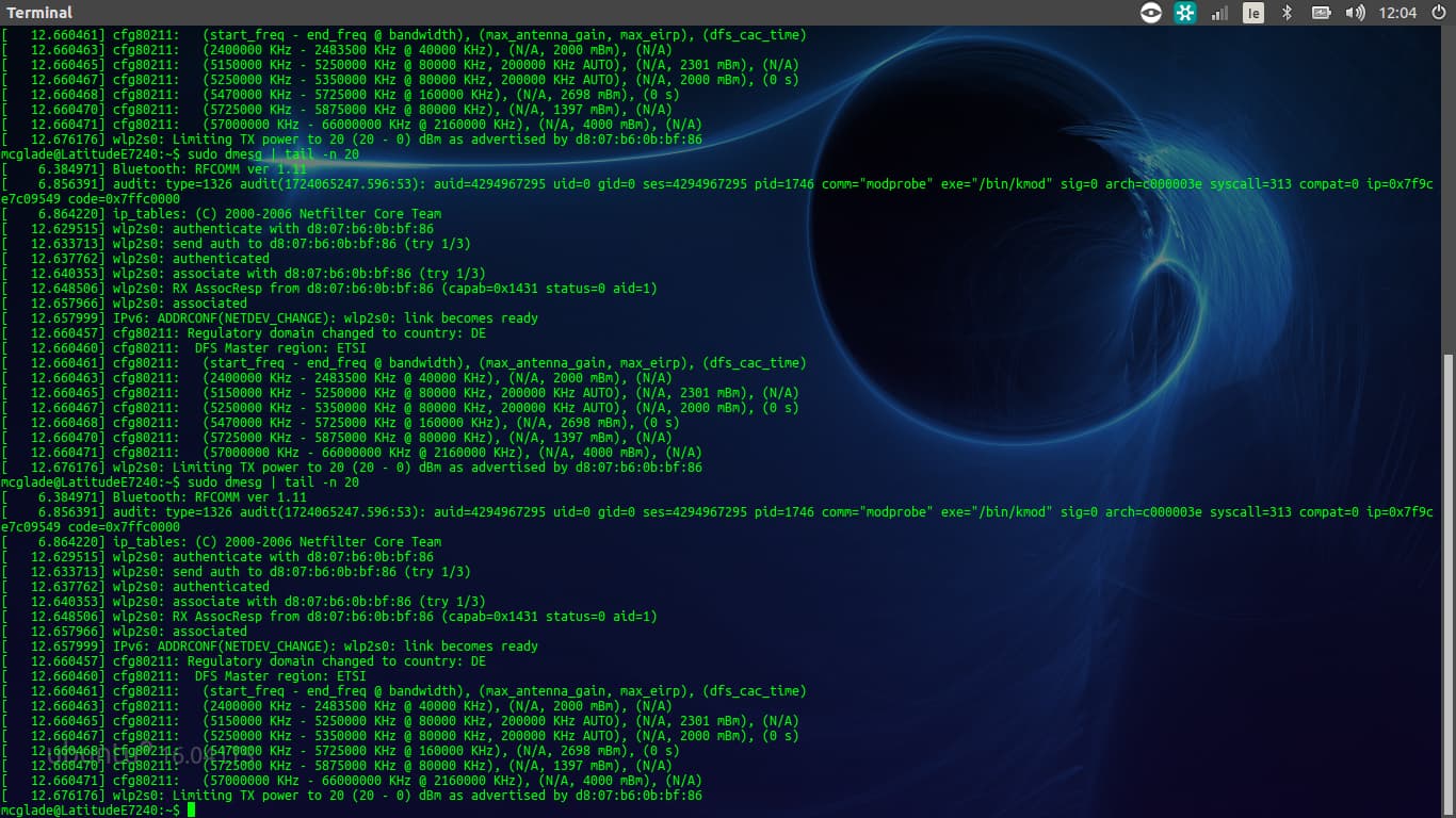

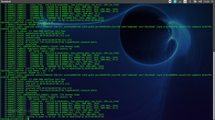

Tried a few cables and no no unidentified thing comes up might try a Linux OS once I get laptop back from friend tomorrow I hope
That will be a good test.
Grab the tail of your dmesg when you plug it in, that should tell a lot about what is going on with the board.
[plug in board]
sudo dmesg | tail -n 20
its as if the device is not their ?? maybe best to replace skr-pro board ?
That is my recommendation. All options I can think of now involve electrical test equipment and component replacement. Probably better to replace the SKR.
:frowning: yeah might be a bit before I can do that but next step thank you all for the help with this
happy to help!
one last thing to check- on the SKR there is a jumper that sets whether the microcontroller gets power from USB. make sure that jumper is set if you’re only plugged into a computer,
