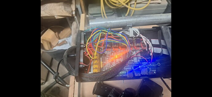

Hello any help would be hugely appreciated purchaced a kit a while back for the lowrider 3 and build using the guide on the website had it running( in its test phase) but had an issuse with homing going backwards to arrow directions. So from forums decided to flash firmware for skr-pro board now nothing wants to move tried few other firware file but to no avail the system setting on LCD screen show in info system : unknown system machine: 3d printer board : bigtreetech_Gd_tft35_v3.0 firmware:v27.x feb15 2023 in 120mhz SPIFLASH USED 96.78%
THE SKR-PRO BOARD IS BIGTREETECH SKR-PRO- V1.2
dose anyone know of anyways to get this moving again wireing is good and all was good till flashing attempts please any help as I scoured everything I can find and read thread after thread please help thank you in advance

Can you please post pictures of your SKR board, showing the cables going to the TFT board, and also photos showing the same cables where they attach to the TFT board. I want to check if your connections are somehow crossed or otherwise incorrect.
Your endstops are wired wrong. You have them across 5V and Ground, which is grounding out the 5v rail on the SKR so nothing is working.

Also its better if you pull the plastic guards from around the sockets where you want to hook up DuPont connectors. They will slide on much better and be much more secure. Like they are now you will be fighting loose connections all the time ( I speak from personal experience here :smiley: ).

Its been a while since I have messed with a SKR board but from memory you should have 3 lights here…
After you fix your endstop wiring and you power it back up see if you have all 3 lights.
Hopefully the SKR survived that. Some do, some don’t.
Aside from this, the TFT has the wrong firmware in it. This has BTT firmware, not the V1 CNC firmware.

You shorted the 5V rail with the endstops. The 5V LED is now on, so you’ve cleared the fault with the endstop. You may, or may not have, blown the board with just that.
You have also repeatedly tried flashing the board, when it didn’t need that.
You may, or may not have, corrupted flash.
If the microprocessor is alive, and the voltage regulator is healthy, but the flash or bootloader is borked, then it could still be fixable. But all of that is racing down rabit holes that might make things worse.
