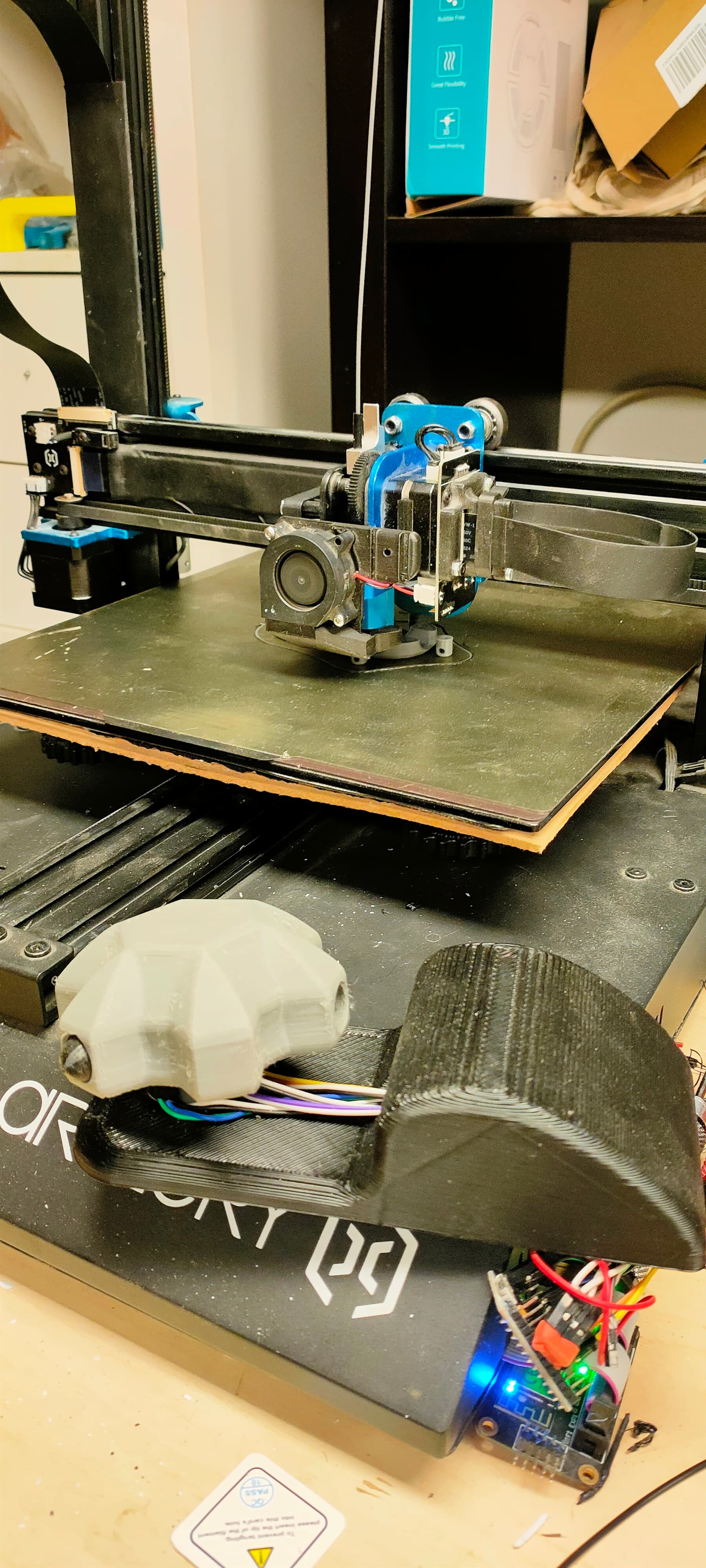

I just printed the main shell, but yea, it’s still pretty big.
I am interested but I think I’ll wait for V3?
EDIT: Followed the white rabbit and now I’m also printing the parts
It’s pretty tall in fact, but that’s because the board is tucked beneath the joystick, I think it’s quite easy to fix…

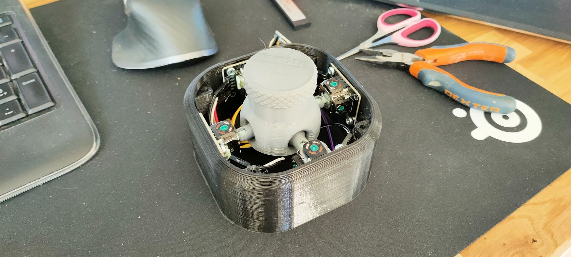

I finished printing the parts and assembled it, flashed the board, but I’m stuck in defining the custom spacemouse board in arduino ide…
Copy everything from C:\Program Files (x86)\Arduino\hardware\arduino\avr to ~\Documents\Arduino\hardware\daemonbite\avr
Well yeah… I don’t have this folder on my computer, so…
Where would you place the board? :slight_smile:
If anyone has a zip of this folder, this would be greatly appreciated…
Using the latest git release of arduino-avr only brings new compilation errors >_<
I found the files here:
C:\Users\[USER]\AppData\Local\Arduino15\packages\arduino\hardware\avr\1.8.6
Also printing…
Thanks!!! It worked!
