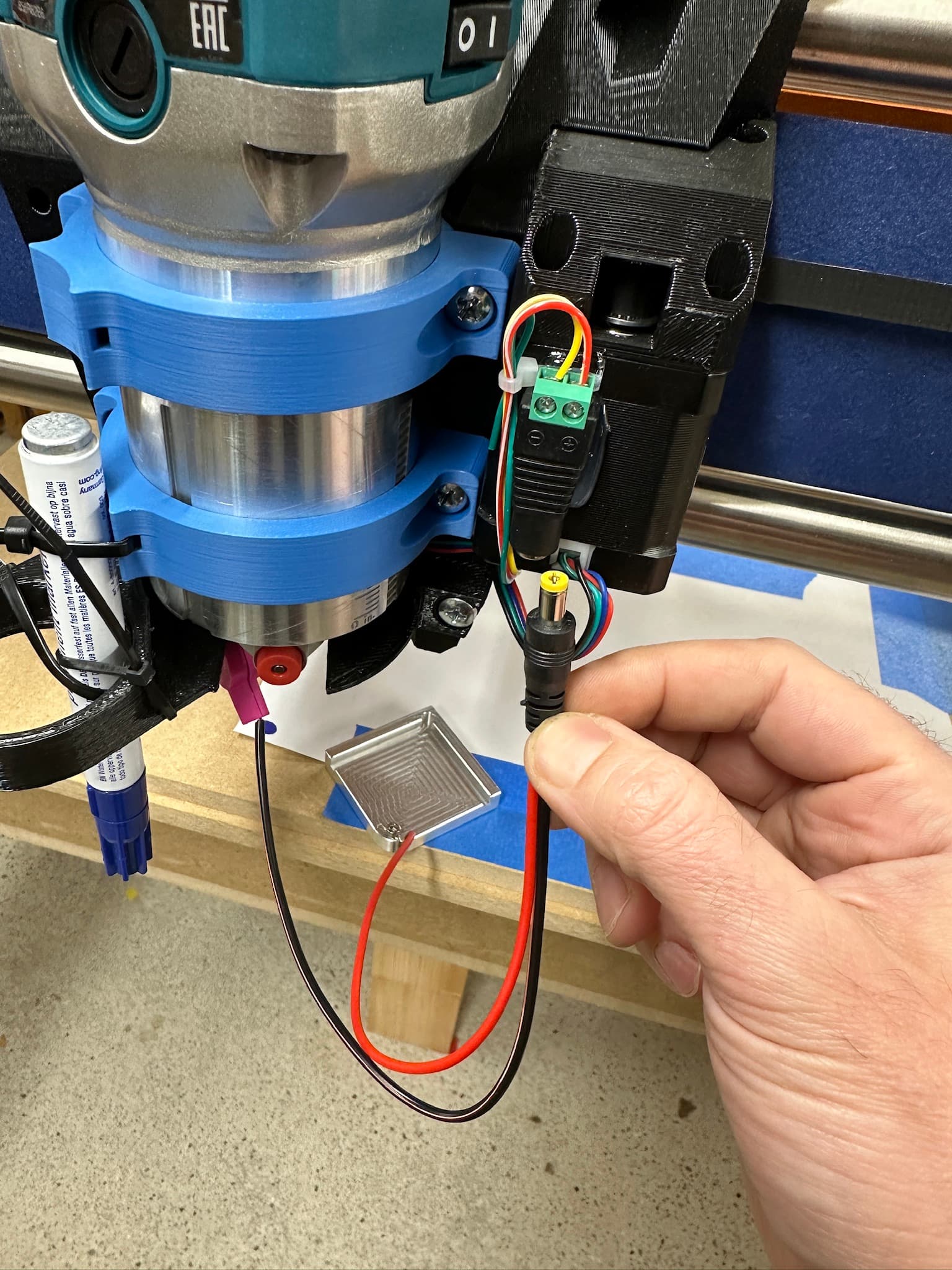

I did make my touchplate after seeing today in a post from @Tokoloshe how he connected it to his machine. I got this touchplate as a present from a friend but as I can not use it for the XY-detection (for now? :smiley: ) it will only be used for Z-probing. I decided to make the whole touchplate assembly disconnectable so I can stow it somewhere safe during cut.

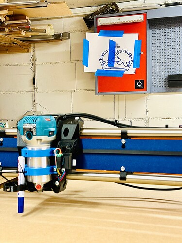

And I drew the first crown :partying_face:
My first project with real cutting involved might actually be a frame for that piece of art :smiley:
That’s a pretty crown! :slight_smile:
Awesome! Great job on the crown!

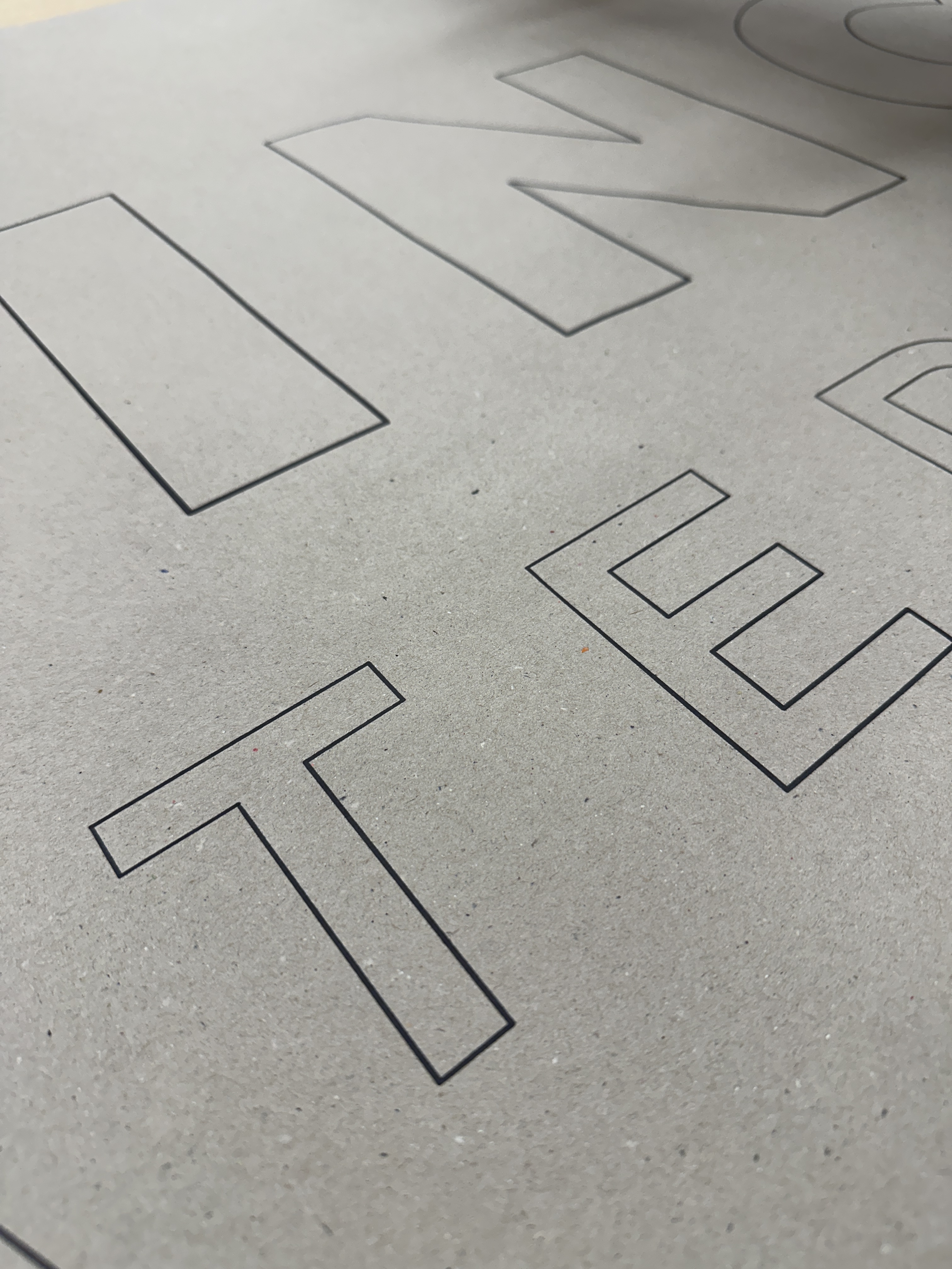

In the meantime enjoy this 2m plot which I am really fond of somehow :slight_smile:
