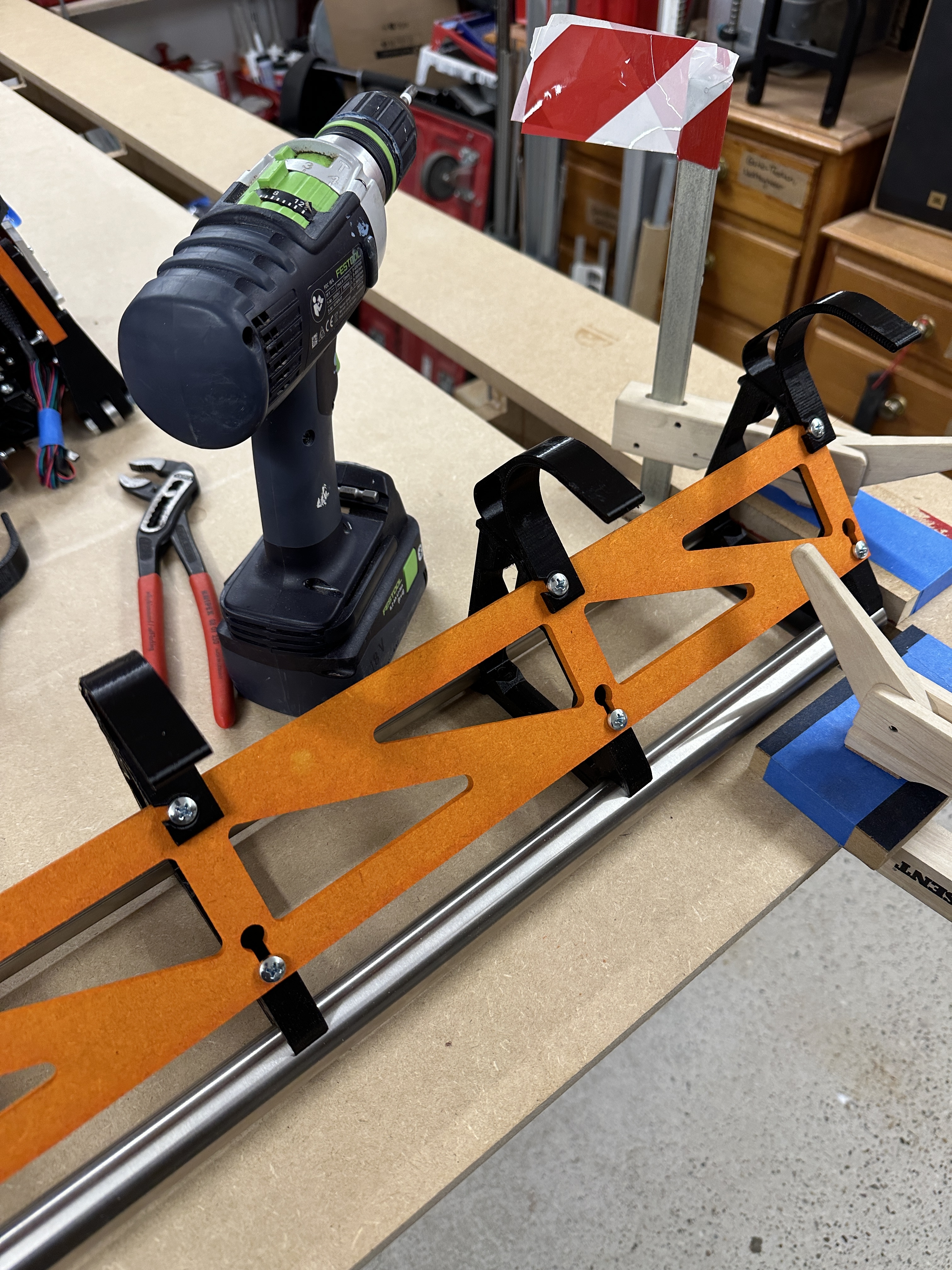

Also, the screws I have do not fit through the keyholes, both from the original generated svg and also the openScad Variant for the nameplate. So to take out the strut plates I have to remove a lot of screws, I would rather avoid to take them out again… They are too wide at their hat. Following makers: be advised to check this beforehand since it will make assembling this much more comfortable :slight_smile: Ryan, maybe if something got mixed up or the generator should maybe be adjusted for tolerances in your supply… I got them with the kit. Can send measurements later, forgot to do it.

I had this same issue.
So were the rails cut too long? or the struts cut too short? If you slid one tube out far enough to get a pipe cutter to fit…, and then slide it back in and the other one out.
Something like this:
https://amzn.to/3Oeg5RD
EDIT: Well, just now thinking that 1.3mm is too close to the edge for that kind to work right.
…Maybe grinding off the excess with an angle grinder, or cutting off with a dremmel tool loaded with a cut off wheel.
So sorry to hear this. Don’t know of an easy fix.
Yeah, the mistake is entirely mine, I cut the rails 1mm each too long :smiley:
the struts are to the plusminus 0.1mm 1422mm long as generated by the calculator.
But from what I get from your answer, I will wiggle the pipe out far enough to make another cut - and try to not have to disassemble the whole thing… to try and maybe safe time on fixing this. I will rather stay on the shorter side since undersizing by 0.5-1.00mm seems to not be a problem so much than too long tubes :smiley:
Might not work with the wiggle-out since the 9 clamps have a very good amount of lateral grip already without any bolts tightened, but then I will just take it apart, in the end it’s not too much.
I can still rotate the pipes in the clamps if I force them, but they sit absolutely tight and dont move sideways if not rotated at the same time with much force. Sliding them on was a perfect fit - the tolerances seem to be just right with this. :+1: Props for the design of this part, very snug :slight_smile:
OK, let us know how it goes.
If you are referring to the braces on the gantry (beam) that’s all Ryan’s genious!
Yeah I know, that‘s where the praise was directed at. I hope he sometimes looks into these threads and is happy to read about it :smiley:
So… I did take out the rails again and cut them again. This time I undersized them .5mm. It all fits perfectly and is very sturdy. Looking forward to making the rest of the assembly this week.

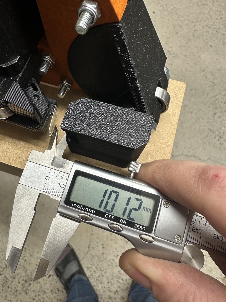

I laid down the marks for the belt holders and the rail blocks and I have a question. For now all things match: the space left and right of the Lowrider on my table, the position of the Y-trucks and the outline for the belt holder etc.
Also the table is square, the toe and heel distance of the Lowrider is the same front and back etc.

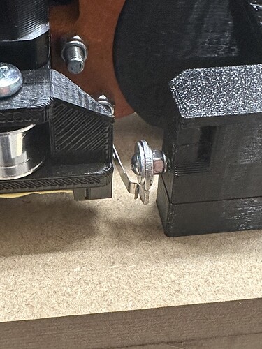

But: When I roll the machine all the way to the front of the table, the right side triggers its endstop about 10mm before the left side does, even though they are placed at the same distance from the end of the riding plate… I can hold the low rider on the right endstop and pull the left side to the endstop to trigger both at the same time… It does not require a huge effort. Is this normal and something that will be handled later on? Or should I correct this better now than later? I could loosen the rail blocks and rotate around their centerblock to maybe skew the difference down a notch? A millimeter at the top and at the bottom over 2,70m might make a huge difference.
Any advice greatly appreciated, I feel uncertain how to judge the situation and whether this is actually “pretty okay” or “very bad” :smiley: The rail is a bit skewed and I can rotate it so the skew is minimal in the XY-direction…
Endstop on the right just triggered:
Endstop on the left still 10mm out.
Just finish building it and then home it. Do the squaring procedure, only then you will know whether you built it wrong or it’s just a little twisted. :slight_smile:
Yeah… I will probably… But I had to finish work in the garage anyways today so I thought I’d ask before I return. If there is no conclusive information I will just go ahead and finish the build. Wanted to do some meditative cabling tonight :smiley:

Well… I made a mistake somewhere, but now it’s square and I added a little screw to trigger the endstop and now they trigger almost simultaneously, which should be well manageable within the configuration of the software. I will see where it goes from here, but I am not worried for now.
