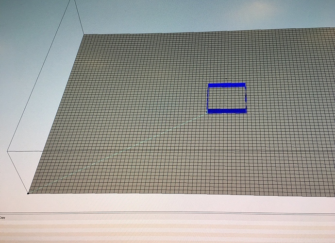

Is there a break in g-code I can run on my MPCNC? It’s 2’ x 3’ if that matters.

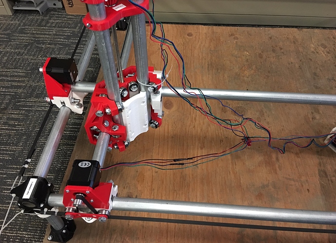

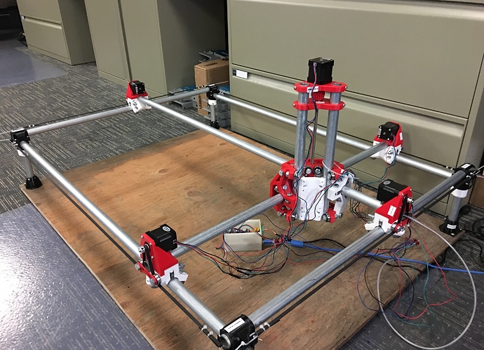

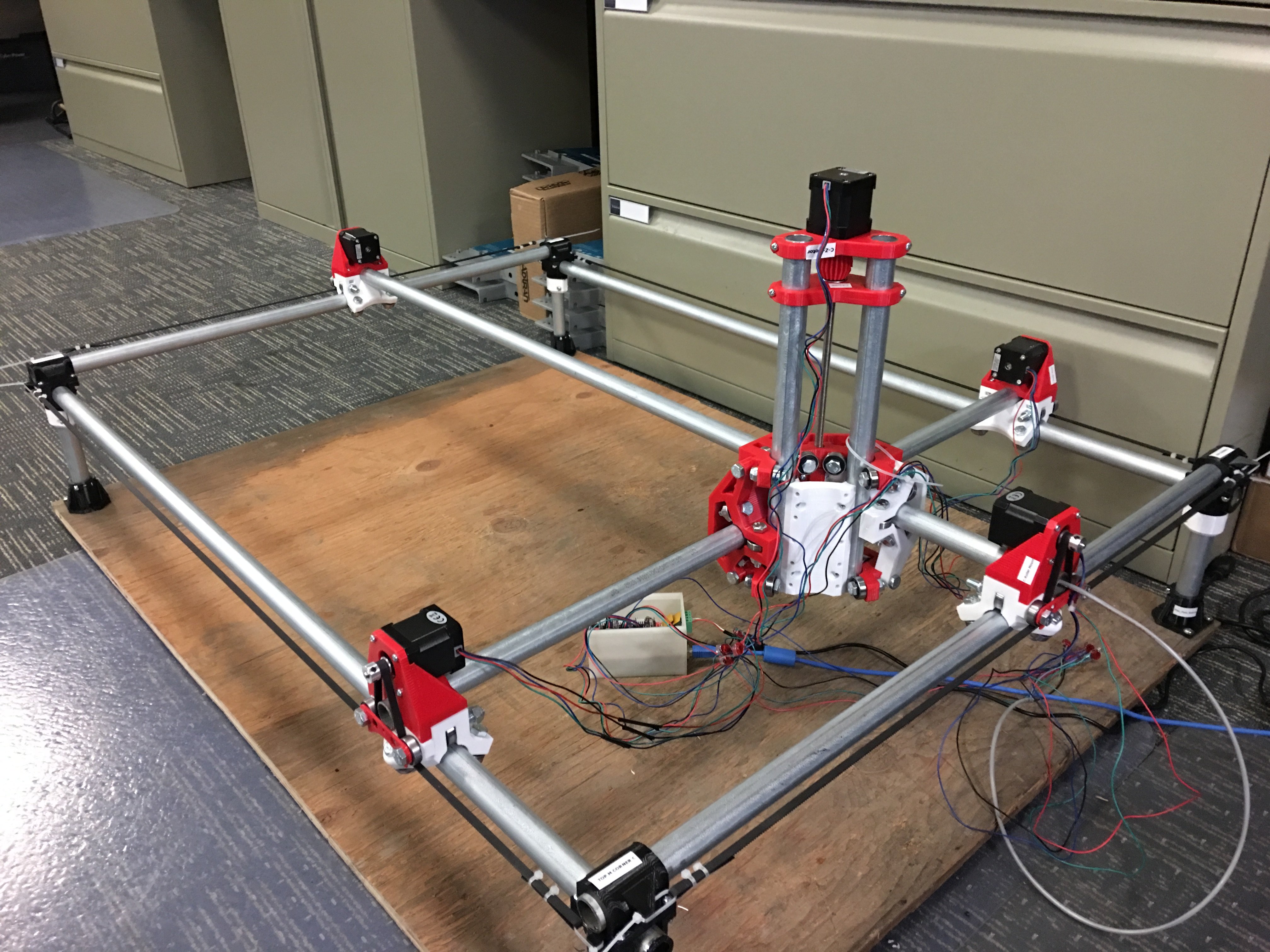

Here is my MPCNC on plywood. I plan on building a table for it.
You can use this model and scale it down in a slicer to fit your bed size.
Thanks Walter.
What speeds would you recommend? With my 3D printer I usually print from 50 to 90 mm/s, but I’m guessing I should start much slower, but where do I stop at?
I ran mine with no filament I raised the nozzle up away from the bed and set it at 90mm/s and just let it run. it will get your head moving across all axis and start wearing things in. I’d suggest you make it a tad bit smaller than your proposed build area just to be safe.

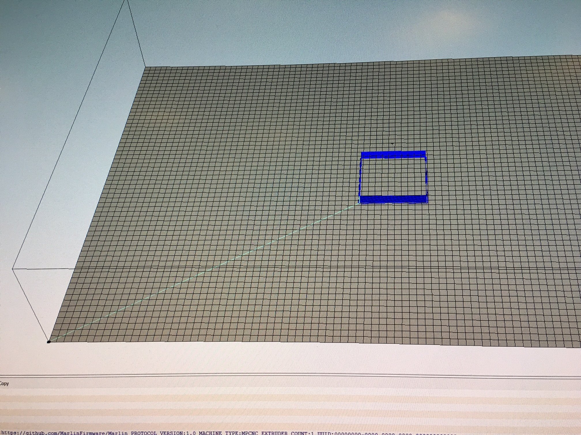

I’m not quite sure what is going on here. I have the gantry parked at 0 for X and Y. When I manually move the gantry around it moves the way I would expect. When I go to “print” the gantry attempts to go left grinding the belt.
Got any ideas?
It is trying to home? Did you take out the start G28 command?
I just removed it. Works a lot better. Should I install some end stops so I can send it home before a print job? I’m not going to use this as a 3D printer though.

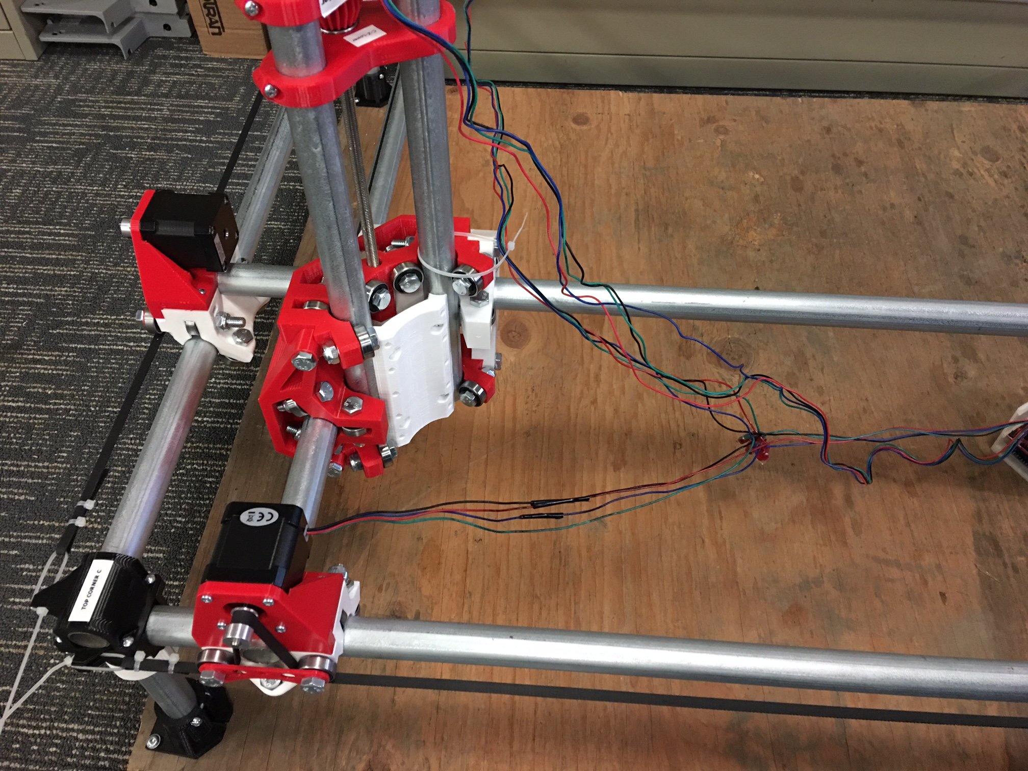

I have .75 volts to my DRV8825 drivers but I can’t get the stepper motors to rotate. Kind of sounds like it doesn’t have enough power. After it kind of moves, I have to power it off and back on before it will attempt to move the stepper motor. Repetier host is still setup from last time I messed with my MPCNC so I doubt anything has changed there. I did have this working before I decided to take it home and had the melted PLA.
Those are miniature pictures.
Do you have all three jumpers under the drivers?
Sorry about that. The larger pictures are on the 1st page of this thread.
Yes all three jumpers are on under the drivers.
