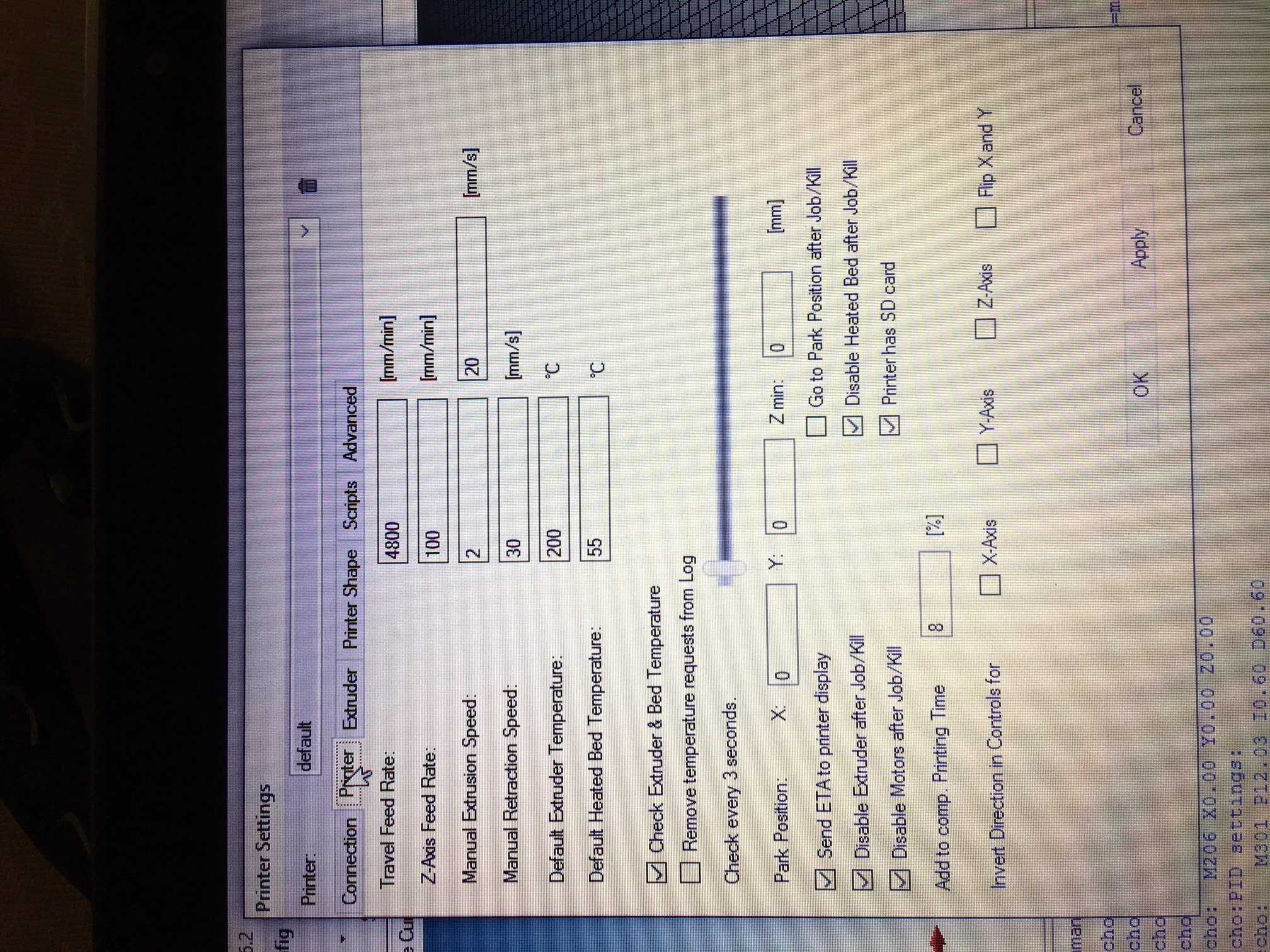

When in Repetier Host I press the X or y “1” the stepper rotates 1 time. If I press 10 or 50 it just makes noise after one rotation. I would think 10 or 50 would mean 10 or 50 rotations?
I think that noise is steppers skipping. make sure movement is smooth when you manually move thigns and that the belt isn’t too tight.
1 10 50 millimeters…
What do you have repetier set to? inches or mm? because pressing 1 should not move one rotation, that would be like 25mm, or 1 inch. perhaps when hitting 10 it doesn’t know where to go because I assume you setup a bed size in repetier and moving 10inches at a time may not be coinciding with the stepper algorithm built into the arduino.
also a good point walter…

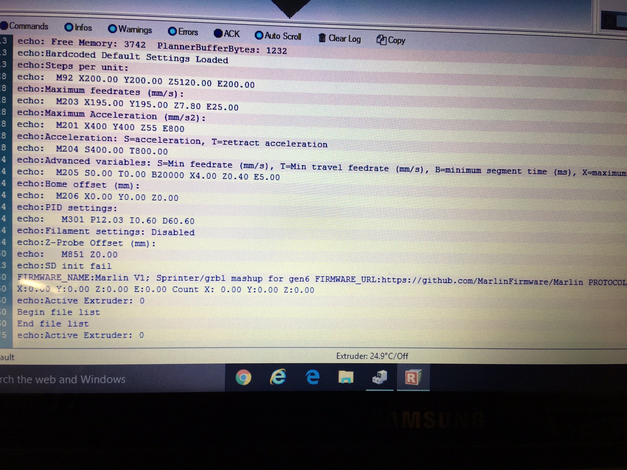

Where in RH do I need to look? I have attached a few snapshots of RH. When I hit 1 on X or Y it rotates around once.
The 1795 pic shows the setting in question. Those are what the firmware is set at.
Do you have all three jumpers under each of the drivers? That is the only thing I can think of that would cause this.
I don’t have any jumpers under the drivers. What do I need to jumper?
I found the picture showing what needs to be done.
