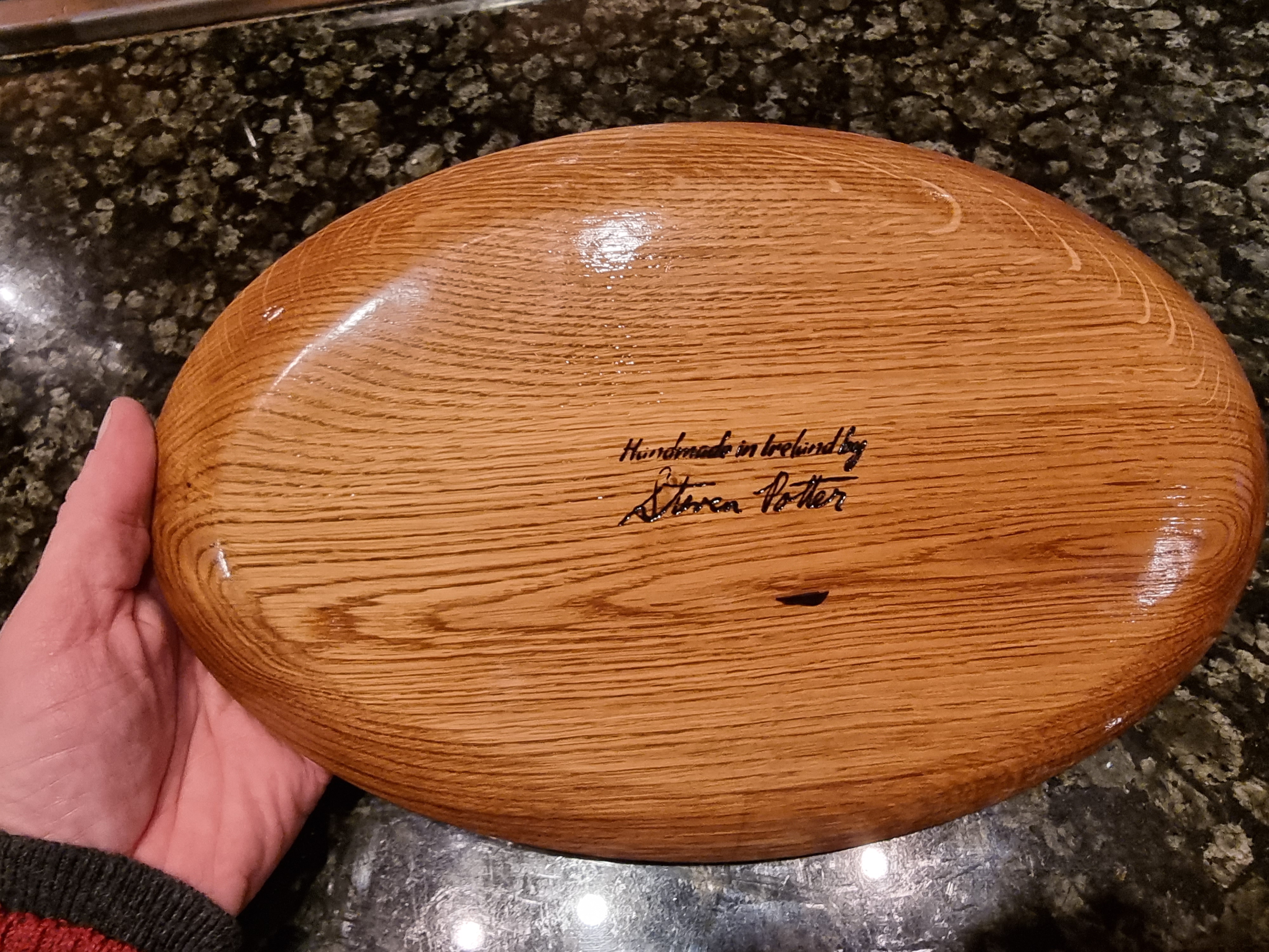

Added my brand to it:
I made a 2nd plate for my Mom, this time out of a solid piece of oak. I had to re-design it in VcarvePro for this workpiece because it was only 22mm thick. I slowed the feed rates down to 20mm/sec, and made sure that the roughing passes (1/4" flat 2-flute upcut) only stepped down 5mm per pass. The MPCNC performed flawlessly! I had to tape the center of the plate down with double-stick tape for the final cut-out profile path, since I can’t figure out how to make tabs with a 2-sided job using the Moulding toolpath I used to create the curved surface.
I tried a new finish for a durable, food-safe surface for the top of the plate: Superglue! I applied 3 thick coats, with sanding in between 600 grit, and finally polished with car restoring paste.
The underside, I just sprayed with acrylic, with light sanding in between 3 coats.
