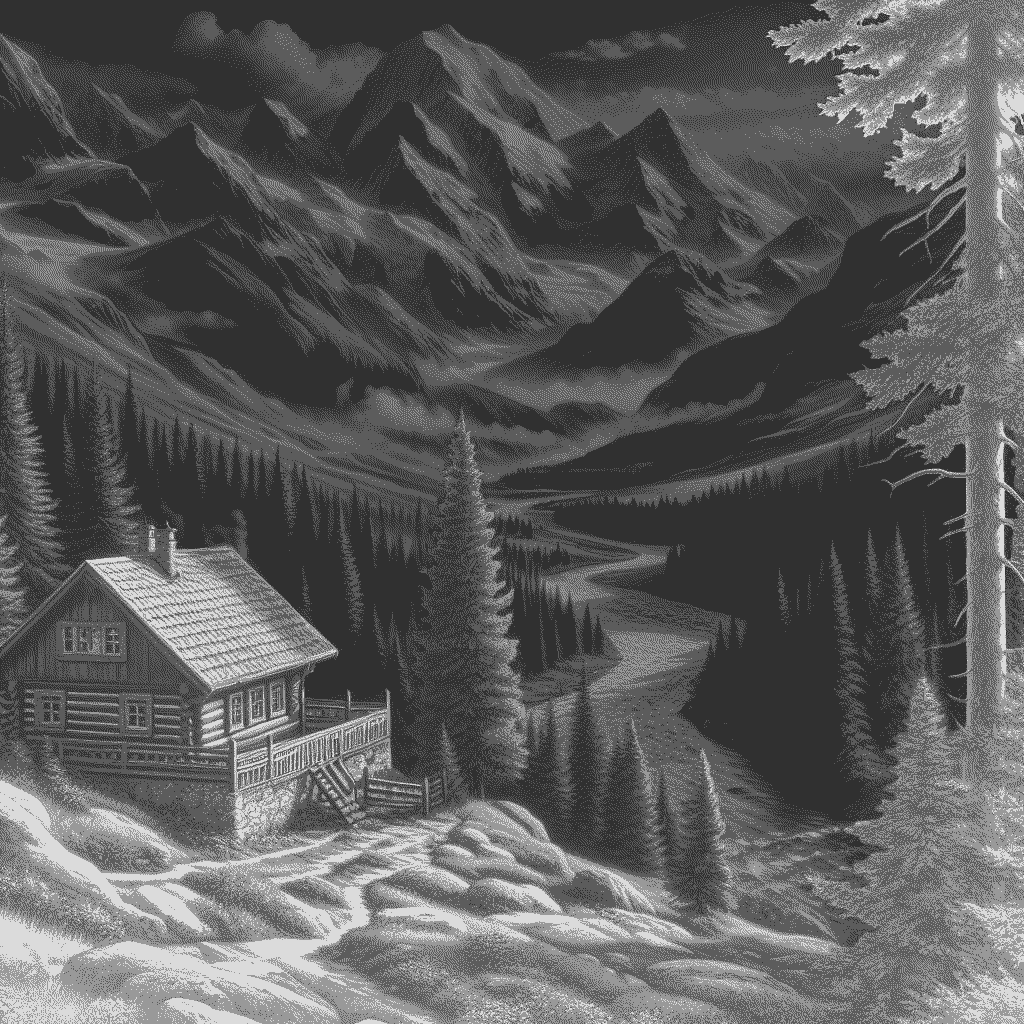

If it simply converted to greyscale, the problem becomes immediately apparent:
The lighter mountains are actually the furthest away and the dark foreground is actually the closest. So simply using this image as a depth map would give a completely wrong result.

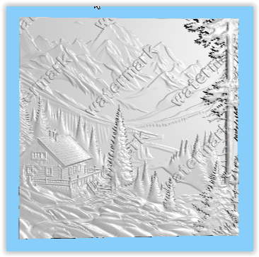

The second software tool, also using AI, is Sculptok. With this software, the image is just directly uploaded and can then be process using an AI engine to determine the depth information. Although this software must be rented, one can obtain “tokens” to run this analysis in various ways at little or no cost. The first step of the process is to “Draw” the image, which costs 2 tokens and generates three greyscale depth maps with varying degrees of detail and include watermarks which can be eliminated with tokens:
Again, the depth information now accurately reflects the original photo.
From here, an STL can be generated and downloaded with subsequent fabrication being done using whatever CAM platform you are using:
