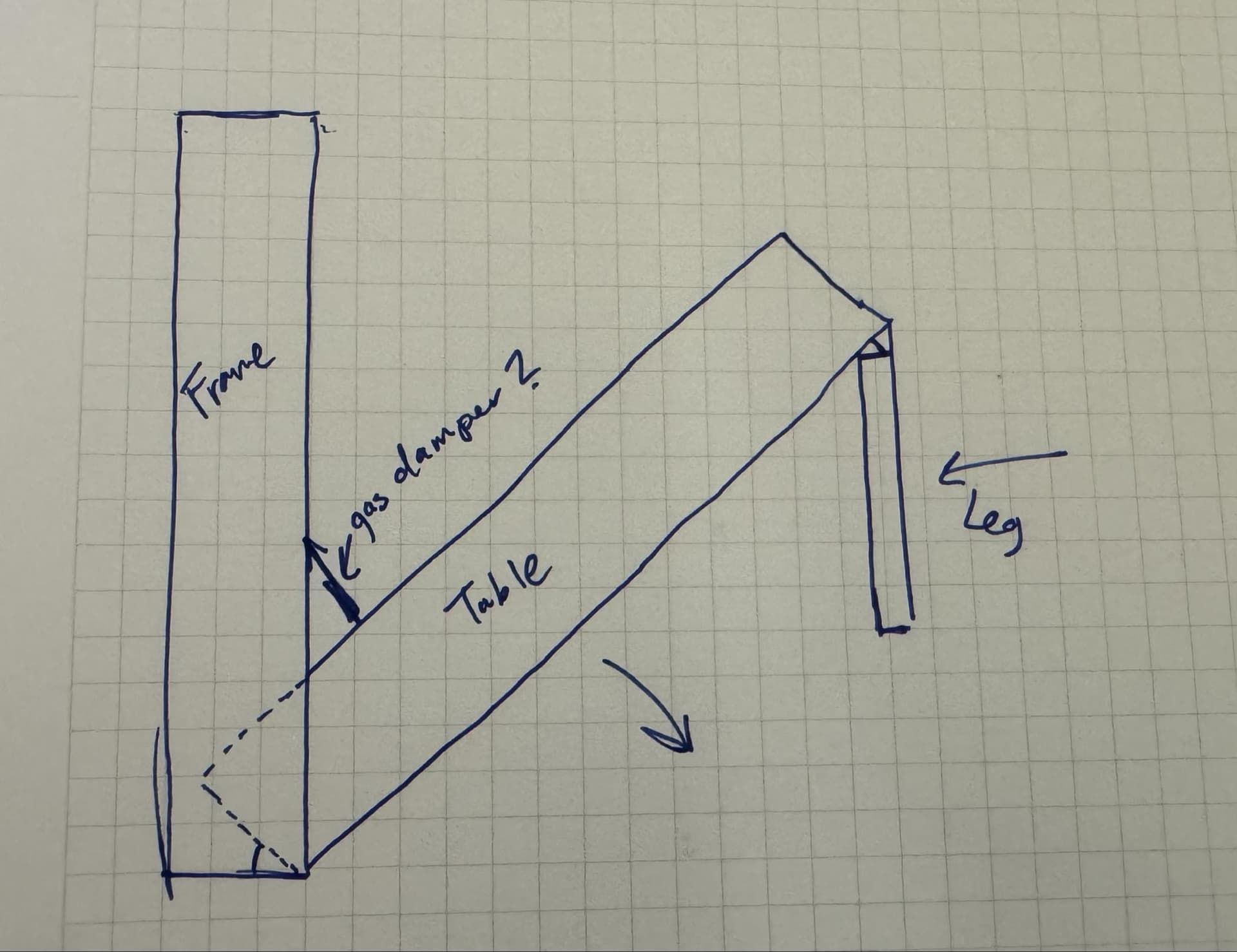

I’m eagerly waiting the LRv4 release to get started printing out parts and putting it together. While I wait, I’m trying to figure out how to fit a full sheet CNC into my pretty-small workshop. One thing I was considering was building the parametric torsion box here on the forums, and mounting it to my wall like a Murphy bed.
This is a very rough sketch of what I’m considering:
. The frame would obviously be screwed into studs in the wall. In my head this would mean that the table is supported by the hinged leg + wall studs in the down position.
I have a couple of questions to start:
  1. Is there some reason this is a terrible idea that I haven’t thought of yet?
  2. What should I use to hinge the table to the frame
  3. Has anyone done something like this that I could look at?

You saw with the other example, but recall that your table will need more space than the cutting area. Roughly budget on a foot extra, so a 5’ wide table. If you put that up against an 8’ wall as you have diagrammed there, folded out it will be 3’ high.
I’ve said before that I believe ergonomics are important. Working bent over too much leads to unsafe practices. Maybe this doesn’t apply to everyone, but bent over a 3’ tall machine is going to hurt after a while. I’ll start taking shortcuts to spend less time over the machine and I can see bad things™ happening.
A cantilever can help raise the table, so the bottom edge can be lower when stowed, but still raised to a reasonable working heigjt when out.
