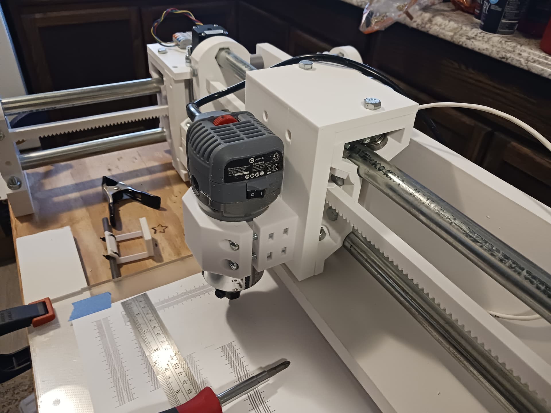

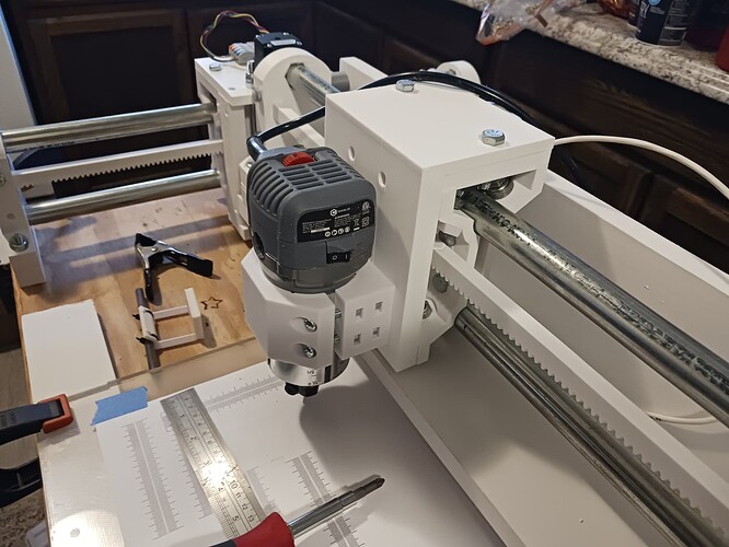

First real tool mount…

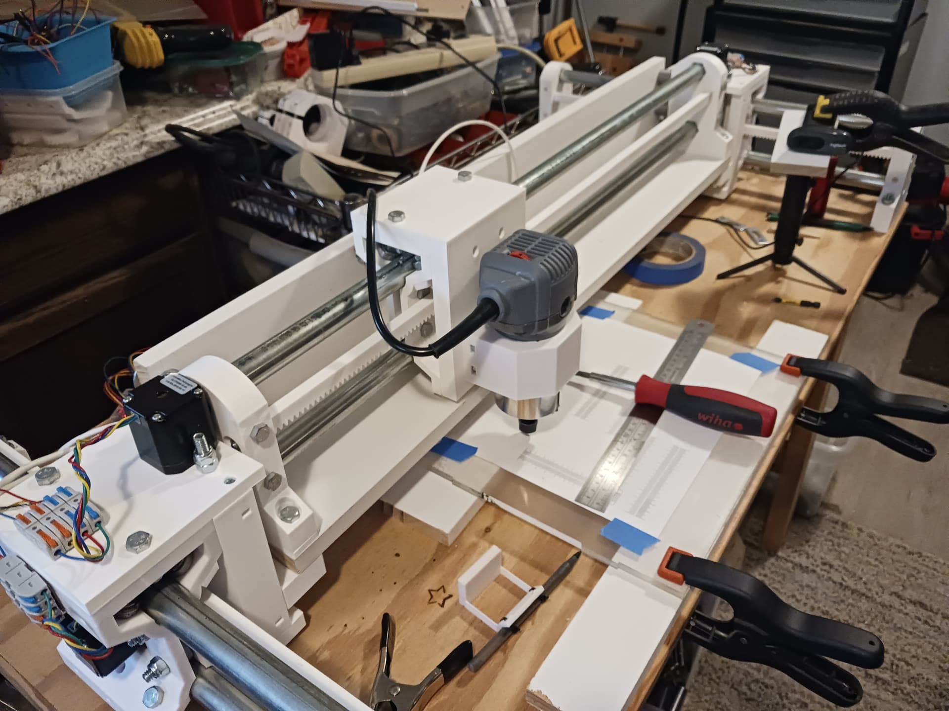

I started clearing off the table with my MPR&P V1 so that in the new year I can start building up a V2 to play with.

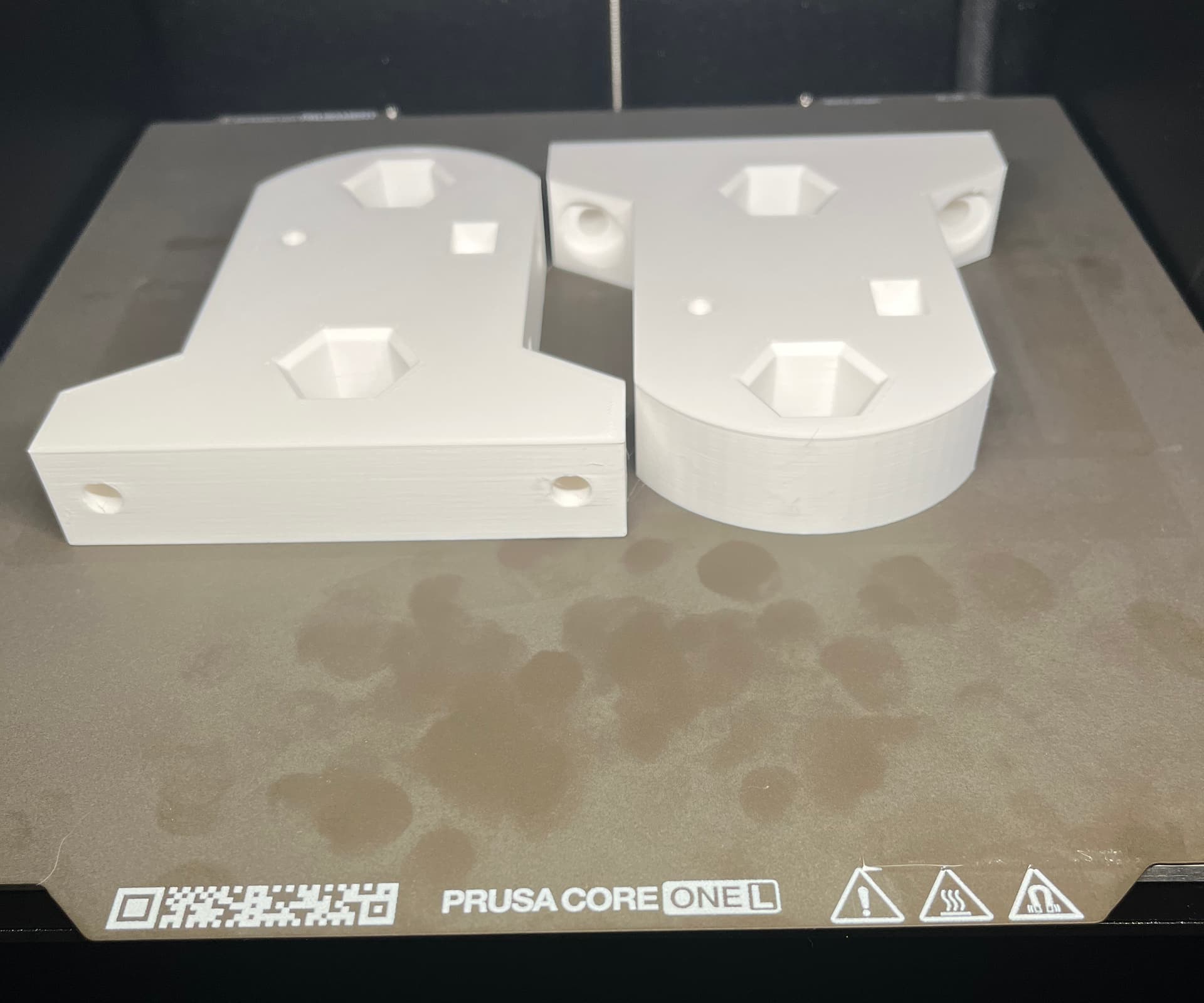

First parts are on the printer now, a LR pair of carriage supports:
These are in ā€œThe official colorā€

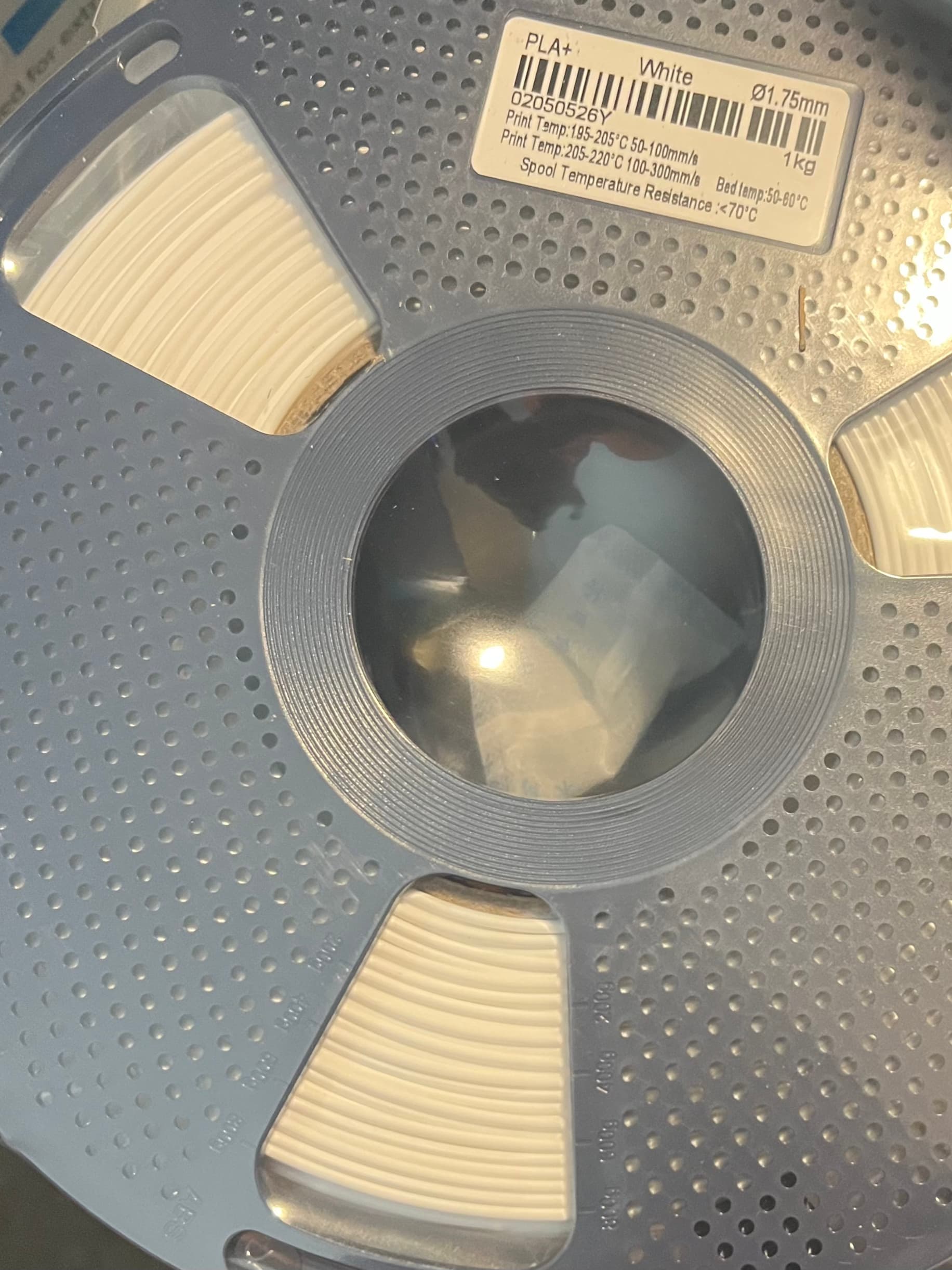

Yes, PLA+ isn’t as rigid as PLA. But, man… I wanted to print it in it’s native color before I start monkeying around too much.

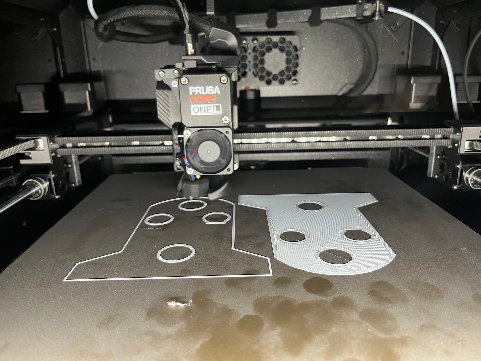

Edit to add: the filament trail is because the Core One L gets nervous and parks the print head if you open the door. I was going to flick that PLA snotball off that you see in the foreground.
That Prusa is one heck of a nice printer.
I got annoyed with not being able to quickly open the door to remove a ā€œsnotballā€ or other – especially since I’m printing with PLA – so disabled the door settings in the settings. It also was the reason I was having so much trouble loading filament… it wouldn’t get past the side-sensor 3 or 4 inches into the PTFE tube… all while I had the door open. Closed the door and all of a sudden I was able to load filament. Too smart, I say! It is indeed ā€œone heck of a nice printerā€ā€¦ you just have to play ā€œits gameā€, not yours.
I just started following the LR4 instructions when it came to wiring and controller mounting. I was thinking a tray of some sort hooked over the back_panel/board of my gantry to hold the controller, miniPC, power brick, and maybe a power strip…
When I moved the router mount and router to the V2, I realized it probably had the ability to cut its own side- and bottom-plates. I just hate the noise and debris – with my machine in my kitchen area – but I definitely think it’s the way to go for future builders who plan to use the router anyway.

Yeah, but clean the sheet. Especially the satin one won’t hold stuff with grease on it. :sweat_smile:
I have mine turned off permanently - Settings > Hardware > Door Sensor
Not to be picky, but as @Tokoloshe says perhaps it’s time to give the print bed some scrubby love! :rofl:
It’s doing great so far. Yes I’ll grab some IPA and clean it after this set finishes
Yep. Damned greasy fingers!
I should have ordered a 2nd sheet, it’s on my list for when I order the INDX upgrade this year.
I couldn’t figure out how to order one with a .6 nozzle, so it still has the .4.
It’s printed everything I’ve thrown on hit with no hiccups so far. Even with a smudged up build plate.

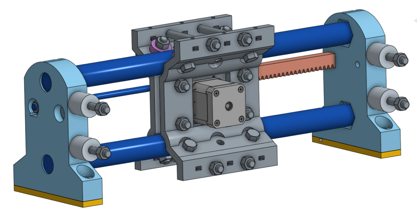

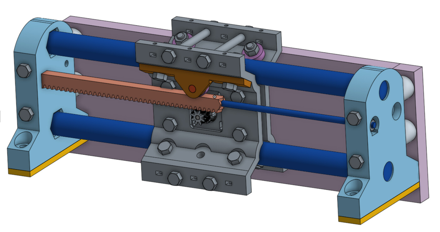

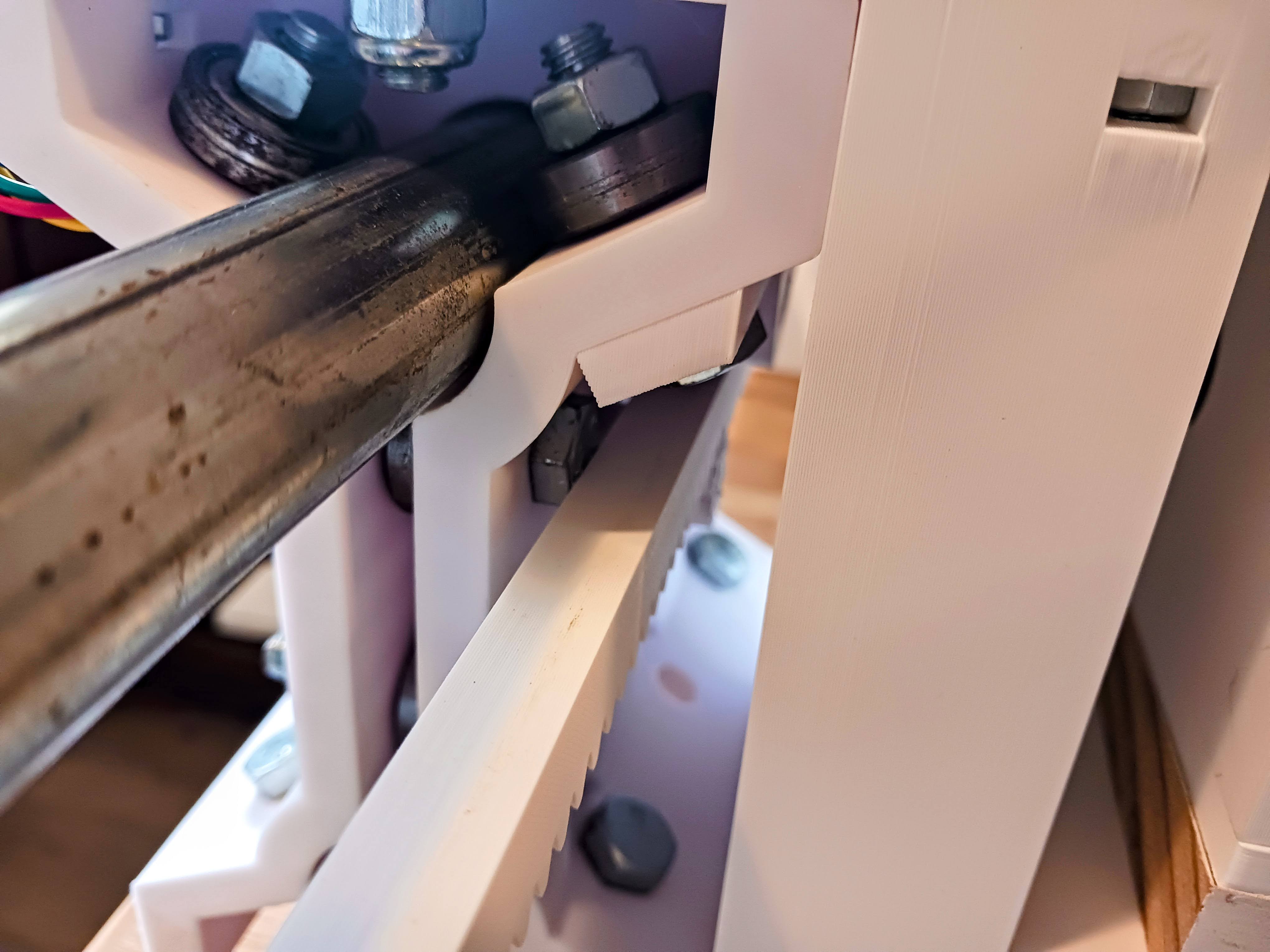

For you guys who are building, or maybe thinking of building, a MPR&P-V2 linear stage (carriage)… here are a couple of screenshots that should help with the hardware installation…
Note that the 4 bolts in the center of the carriage assembly should have their heads on the rack-side of the carriage, as there is very little clearance between the two upper bolt heads and the rack. Though this screenshot actually looks as though there is interference, the bolts I got from Lowes had thinner heads than the bolt CAD model shown here… and there was no interference in my build. If your bolt heads are too thick and interfere, you’ll probably have to grind off a bit to clear on the two upper bolts. Here’s how close mine are…
Also, the four cross-bolts shown in the screenshots that tie the top and bottom ā€œearsā€ together were originally intended for mounting tooling plates… but I’m really beginning to think they’d better serve to adjust the bearing to conduit contact and take any slop out of the carriage due to bearings that aren’t properly contacting the conduit. I have had a little wiggle on a couple of carriages with bearings not in proper contact with the conduit rails. As a result I probably will need to modify the ā€œcarriage_capā€ part a bit to allow the upper-most cross bolts clear passage to the opposite ear and allow the ears to be drawn together slightly during adjustment.
EDIT: I modified the ā€œcarriage_capā€ and replaced the one out on Printables.
I’m using 5/16"-18 hex bolts throughout… 8mm bolts are good, too. The four central bolts are 1.5" long and capture a 608 bearing between the carriage halves. Six of the eight bearing bolts on the slants should be 1" long… the other two also go through the pressure bearing mount and are 1.25" long. The four cross-bolts, if used for bearing-to-rail adjustment, would need to be 3.75" long. The pressure bearing is mounted on a printed pin (print horizontal with support) press-fit into the pressure bearing mount. The bolts for mounting the 17mm back-plate on my machine are 5" long.
EDIT: All these bolts should terminate in 5/16"-18 Nyloc nuts.
There should be thirteen 608 bearing total in the carriage assembly. The 1/4"-20 threaded rod that goes through rack segments will vary in length with how long you make your linear stage and ideally shouldn’t extend beyond the surface of the end supports if you want to keep a clean/flat end-support outer surface.

You grabbed these at Lowes? I’ll head there to grab some for my build.
Let’s see if I was paying attention
Per axis:
1.5" - qty 6
1"- qty 6
3.75" - qty 4
5" - qty 4
What about the Z lift bolts/(Pseudo rods)? What length bolts are you using there?
The guide rod bolts I had on hand were 5/16" x 8"… but 7" length is enough (won’t need the spacer I used).
EDIT: The 7" might have the threaded portion extend down into the slide area… probably safer if you can get 8" length.

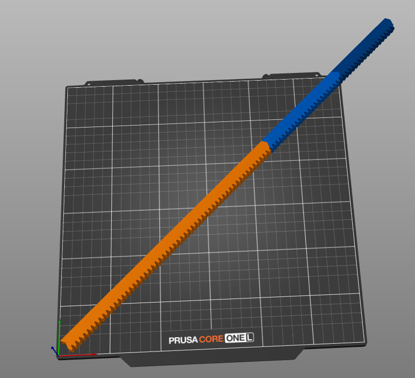

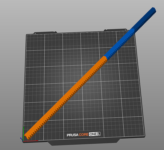

The pinion and racks are the same. I did put a 56-tooth rack segment out there as the new printer could handle it (40 -tooth was the largest I could do on the MK3S). Print the racks on their side.
It might be easiest to just print the longer ones and then chop-saw the end segments to get flat ends to go into the rectangular end support recess and get the exact length you need.
I’ll bet you could have put a 56 on the MK3S. By my look, you could fit a 72 or maybe even an 80 on the Core One L.
The 56 is the orange one, with a 40 stacked manually next to it.

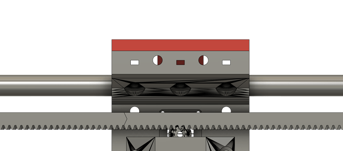

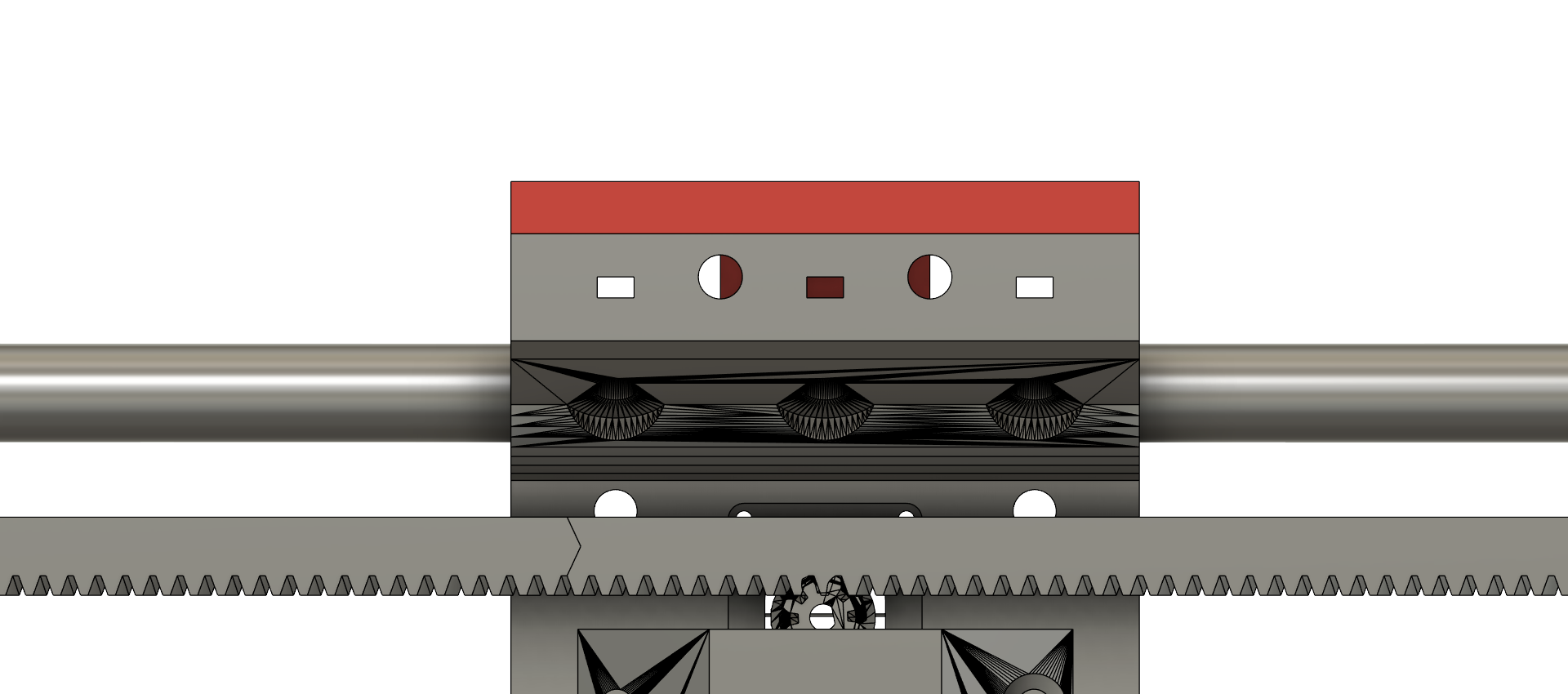

The carriage top looks like it clips the bolts joining the 2 carriage halves?
I probably could have eeked out a bit more but I was building a fairly small machine and didn’t mind using 2 or 3 segments… and the seams don’t seem to be a problem. I envisioned printing an entire plate full of rack segments at one time…
BTW I think the hex bolts need to be the zinc-plated… not galvanized.
