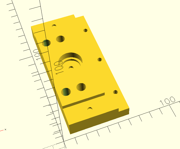

I bought bolts to use with the build I started, and I just don’t think a trip to cut/grind old printer rails down will fit in my schedule near-term. So I did a quick remix and sent some modified parts off to the Core One L. I want to get the small MPR&P assembled and running before I leave for SMRRF so that I can work on the big MPR&P after I get back and before RMRRF.
It’s just a simple remix to push the holes all the way through for the bolts.
I’ll do the same with the motor mounts for my first build.

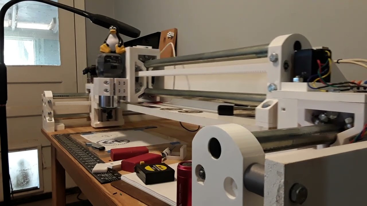

Finally decided to switch out the little 8-bit GRBL controller with a Jackpot V1 and FluidNC. Here I’m air-milling one of @joegomez1479’s badges… and I’m impressed at how much smoother, quieter, and snappier it is. I used a proper config.yaml with LR4 speeds and accelerations… only changing the steps/mm to get me pretty close to scale moves.
:man_shrugging:
Nothing wrong with the original controller! You built a spare parts box build and I suspect that others would do the same.
Yes, those TMCs are amazing and FluidNC does a great job of running the machine.
I suspect that had I switched to the stronger Jackpot sooner… I might not have spent so much time trying to adjust the Z-lift leadscrew and might have moved on. Watching the machine now, I have no doubt that it’s doing fine… and suspect that it would have done quite well with one, if not several, of the printed leadscrews I tried.
I love the flexibility the machine has. I think the beefier lead screws would probably have been just fine for a bootstrap build, but you’re going to see that machine is a beast with the current config.

Here’s a better video of the first air-milling moves of MPR&P that shows positive control with the Jackpot controller and FluidNC and configured with LR4 speeds and acceleration. I’ve changed only the steps/mm settings on all axis to provide proper scale movement.
