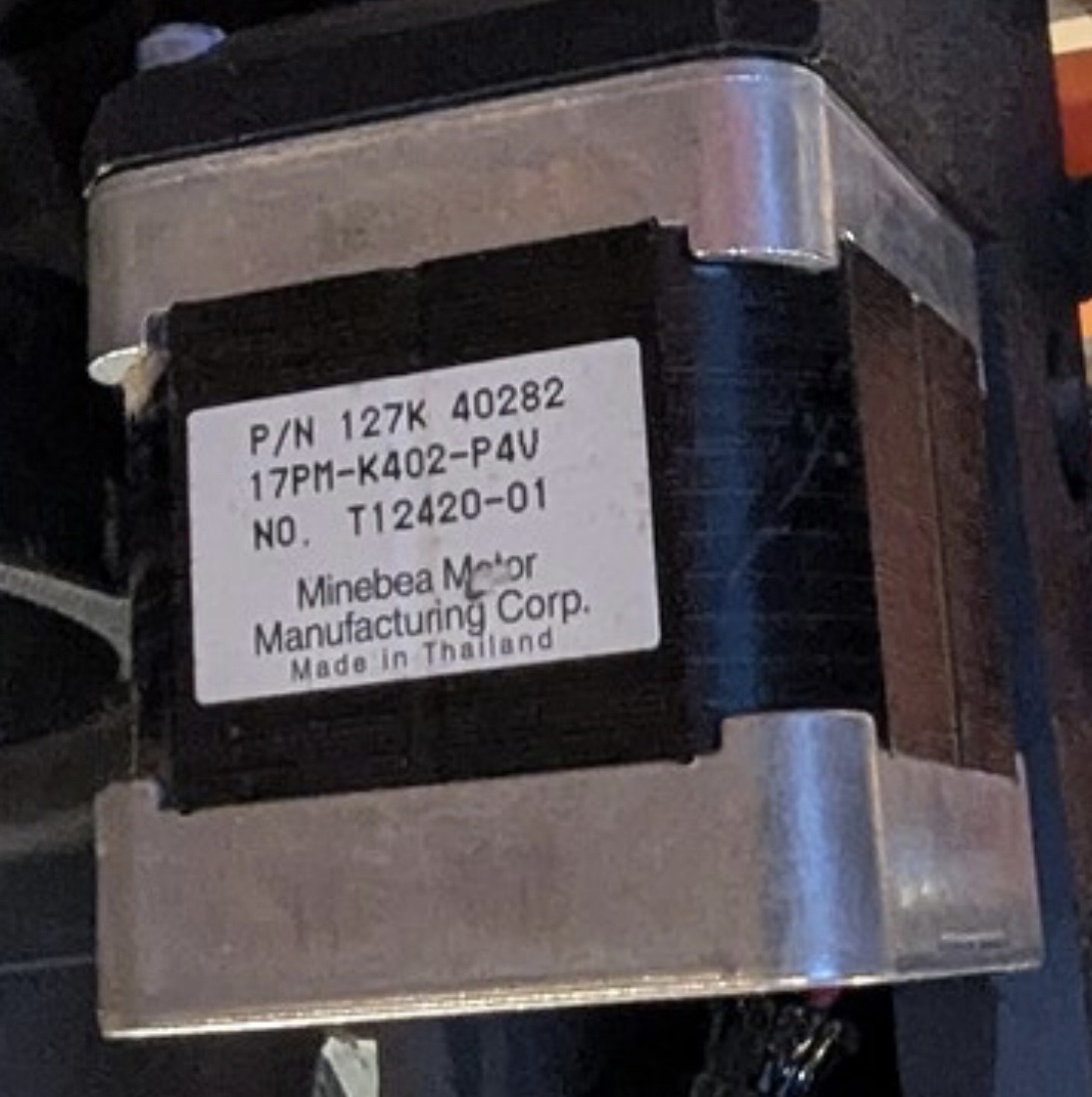

Yeah, these are weird steppers. I’m expecting something in the 1.6 to 2.0 ohms per coil range for the resistance.
This appears to be a stepper type issue and not a Jackpot/Electronics issue.
Just for the sake of being thorough, I stuck another meter on the Jackpot. 0.55A while holding 5 steppers, 0.76A (18.25W @24V) while all 5 steppers are in motion. We set the hold and motion amps slightly different to reduce unnecessary heat.

If you intend to have a working machine you’re going to need to address the issue with your steppers being incompatible with your electronics.
Again, I thought in my previous post I made this clear. Yes, the motors will move the machine, if you have more than 75w. This is where is said the operation is normal. The motors step accurately and smoothly, each one.
But, it takes more power than anyone can fathom. Which is why everyone is thinking short. No, I’ve checked. The coils are not shorted. No endstops are shorted.
Again, it will run at 60w with 4 steppers. Any of the four. I tried swapping them all around, maybe I missed something when I checked the first, the second, and the third time trying to isolate a short. Nope.

Did you take a look at Jason’s post above, I promise no one is attacking your knowledge, these do seem to be odd steppers. 6 wire but connected oddly.
The bottom line is they work as intended with standard nema17 rep rap style steppers, yours clearly are not. I don’t really have the time to fully dig into why if you already bought new steppers.

It is a wattage problem. Most stepper motor coils we deal with are 2 ohm so to get a single amp flowing, you need like 2 volts. The use of 24v and associated ramp rates and things allowed by that are out of scope here and i dont fully understand them anyway… but back to my point. Power is proportional to iv (current times voltage) or i(r)squared. If r is 13 instead of 2, then the voltage needed to get an amp is 13v and the power needed just increased by at least 6x, so your power supply could very well be under sized and browning out because it was intended for five motors each with a pair of 2 ohm coils… Not 13 ohms. With that much power being dissipated, no wonder they get hot.
That seems logical to me. I hope that helps with understanding. From a credential side, I aced introduction to EE about 25 years ago, so my view is likely limited.

You got a workable explanation above about the EE, I’ll just note that drivers are designed for specific applications and you can’t just assume a driver designed for simple ~2 ohm individual coils will magically work fine when instead paired up with a ~13 ohm series wound stepper. They won’t.
Especially when TMC2209s have a bunch of advanced features beyond the simple drivers that older controllers used.
